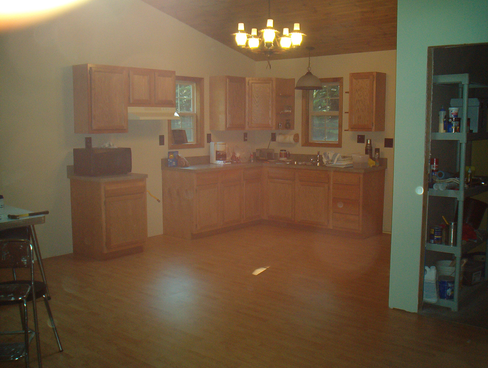

I installed laminate flooring in my "week-end" home in 2004 and it looks as good today as the day it was finished. this is a building that is unheated when we are not there, so it has seen a wide variety of temperatures and humidity levels. (Others results may vary.) Sorry I only seem to have a crappy photo.
I'm not trying to bad mouth the flooring. I know some people love it, and it's hard to find something better for the price of it. The ease of installation is also a big plus. What I see is the ridges that form along the sides of every piece. From some angles it's not even visible, but when the light is right, it jumps out at you and then that's all you notice. I'm not sure if I see that in your pic or not, but it does look like the edges are raised to me. This is something that just keeps happening until it starts chipping.
Eddie
WOW you see raised edges on the day the install was completed. Being in the room today I cannot see or feel raised edges. As I said others results may vary!!
