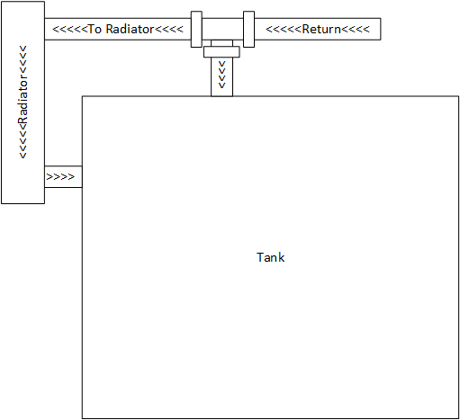

/ Firewood processor build thread #404
I love your idea of a rad plumbed to its own port. I would still have a problem running a pump, but its a great idea that I'm going to give more thought to.
What if you teed into the return as shown below and had it exhaust into its own port on the tank? As long as your radiator is larger than the return (ie: 1.25" vs 3/4") any excess flow/pressure over what the radiator can easily take will go straight into the tank. No circ pump needed that way.
Aaron Z
Another good idea. How much of a benefit do you think using a rad with no fan would give? I'd still have the issue of not being able to power the fan.

The issue is that most liquid pumps aren't setup to handle 150-250 degree fluids, or they are low enough flow that they wont push enough liquid.
Hence my suggestion earlier to tee into the return to allow a place for any excess pressure to be dumped. If there was a restrictor (so the radiator side of the tee was a little smaller than the tank side) it would reduce the flow further, but if you go from 3/4" or 1" to 1.25", it will drop pressure right there.
