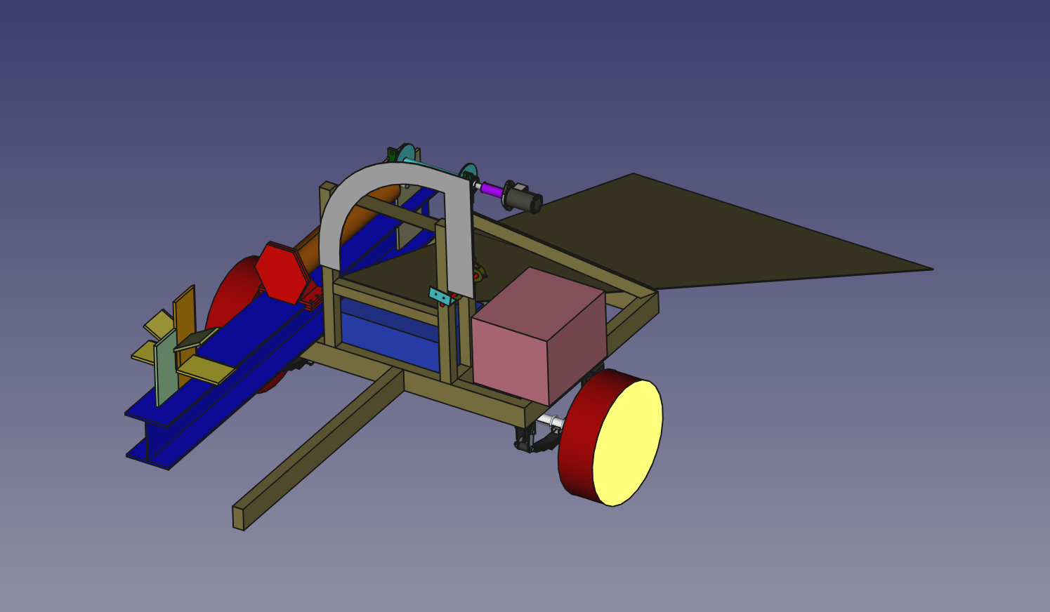

Yes it is great improvement not only in hours but in hard labor. A friend of mine saw my processor and ordered one for himself, but it is a slightly different style, as we doesnot want to use another machinery to lift the logs on the deck, while he is skidding 30ft long logs from the forest. This is the current design so far, and its a paid job so I have to have it ready in 2 weeks :confused2:, maybe thats a better approach you may be interested in, as it utilizes a winch to pull the logs. Screenshot from 2018-12-24 06-39-48.png

Great ideas with the processors, looks good. The design above is what I am going to build. I got the idea from the wallenstien processors. I Have a Honda engine already and just ordered the pump, cylinder, and auto cycle valve. I plan on using my chain saw like whats in the wallentien video. One of the main reason for this Type of processor with the winch log feed and the chain saw cutter is because the engine/pump combo I have is small. Honda GX160 with 11 gpm pump. It will be fine for my personal processor.

From Wallenstein i improved (imho) the negative thing that the splitter is at the opposite side of the operator. It is very often a need to adjust the log or something. For this build I will use a 16hp from Harbor Freight, for some reason I love how robust and cheap are some Chinese products :) and use a 2-stage pump 22gpm/7gpm with a 5in cylinder. Another thing I do not like on the wallestein is the 2 rectangle profiles for the splitter instead of a W-beam. My calculation show that it is not even close as strong in side-bending force when a knot hits the horizontal knife on the 4-way. I also going to use the full auto cycle valve (extend & return) because the customer wants to use a mechanical chainsaw, so he does not have to keep his hands tied there. Hud-son has a similar model the Badger, which again has some negatives. The controls are above the wheel, which again is not a convenient location for the operator if you do long hours there.
We will see, the design is still evolving :) :)

I have contemplated a few changes on the wallenstien platform also, and agree with you on the position of the log splitter. I will most likely put the log splitter directly inline with the feed table. The direction of flow will also be from the front of the trailer to the back of the trailer so I can position the trailer directly in front of my wood shed. That way I can cut and split and the wife can take it from the outfeed chute and stack it. The basic design will be very similar to the one in the link below. I like how simple but effective it is. I love how at 1:09 in the video you can see the chainsaw operator toss his cigarette but in the saw dust pile.

Enjoy fab & the invention of things. Saw something similar on YT that made sense to split the cut log as the splitter cylinder traveled L to RT. It takes less time to saw the wood than it takes to split it. Doubling up on the splitting stage could boost production. Having to wait for the splitting ram to come back home might suck.

It would definately boost production for a fire wood business, but IMHO the extra designing and fab work involved to make this work, isn't worth it, at least not for me. Then you have the issue of dealing with wood coming off both sides of the trailer which would create another issue that would have to be adressed. According to my calculations with the equipment that I will be using the complete cycle of my splitter from start to finish should be in the 12 second +/- range. This time will be used to position the log for another cut and cut it. 12 seconds might seem like a long time to some but the whole process will be a lot quicker and a lot less handling than the "old school" way I am doing it now. Drag the wood out of the bush, block the wood, load the truck, take it home, unload the truck, lift every piece onto the splitter and split. I'm getting to old to keep doing this, I need to work smarter not harder.
