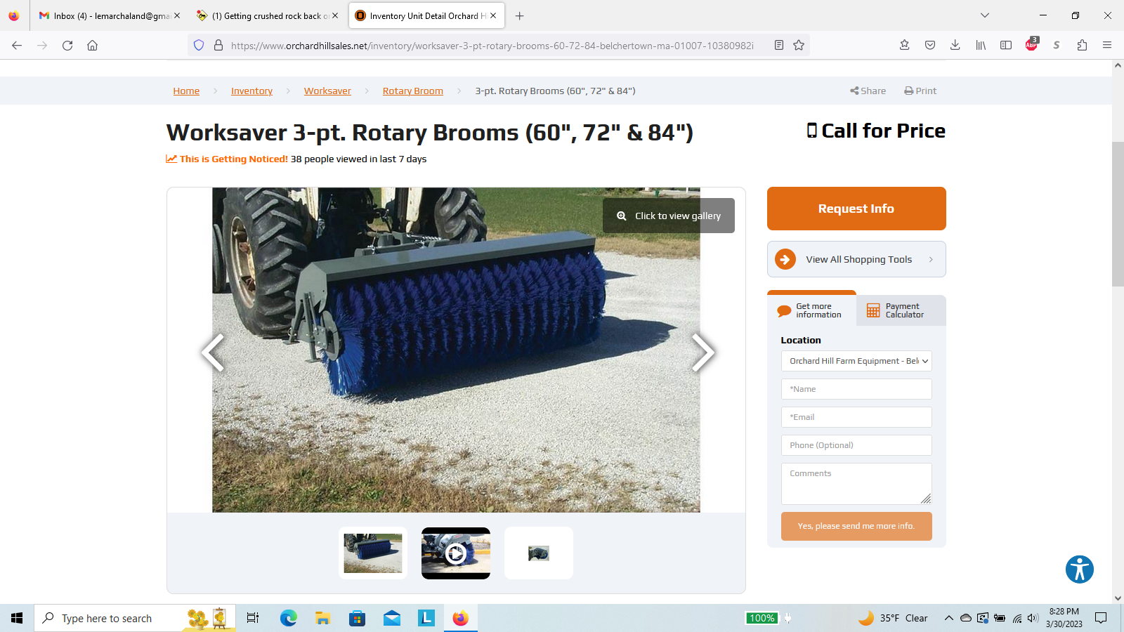

Is there lawn care company near by,if so maybe worth hiring if the have equipment.
It is a thought. Kind of pricy, and I checked to see if I could rent one locally. No one has them. There are Stihl dealers in my nearest town of 30,000, but not have them in stock. Thanks

For smaller areas with smaller stone I use the Sthil Kombi with the power broom attachment to make pretty quick work. It does a great job.
The landscape rake can work, but you'll move sod/dirt onto the drive at some point. Gauge wheels and float (chain or EA rake's slot) can help some.

Thanks for checking. I checked the Home Depot site and the nearest Home Depot store is 42 miles away and they do not rent them. The next nearest might be 120. But I do like the idea of renting the Stihl Powebroom. For about $50 I probably can rent one long enough to do what I need. I will keep looking. ThanksHome Depot rents them per their website. No idea as to the cost though…..

Good to know. I am still looking to rent one. I understand they do give one a workout! ThanksI bought a Stihl Yard Boss with the sweeper, last year. A liitle pricey, nut it works really well, in reverse (pulling towards you).
