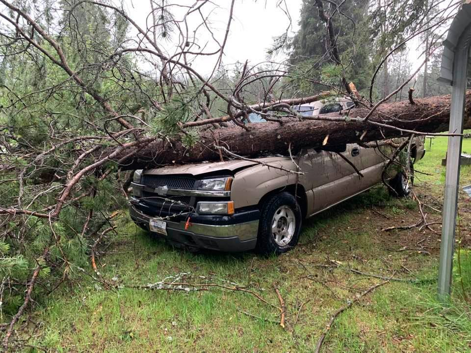

I have a 2014 Chevy Cruze 2.0TD, I love this rig for a work commuter, as my drive to work is 40 miles round trip. When my bashed and battered 2004 Silverado 1500 bites the dust, I want to get a 3.0 Duramax Chevy 1500. My poor truck as survived running over deer, having a tree fall on it etc. I've rebuilt it every time.
