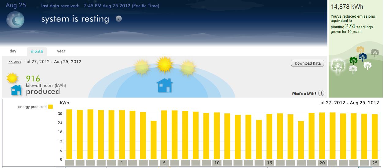

The September, 2013 results.
Down 5 kWh from Sept. a year ago, but 82 kWh AC above the model.
That doesn't surprise me as we have had an unbelievable stretch of clear weather this month. I took the reading at noon, so we likely exceeded last year by a bit. Our daily production now is ~25 kWh on these clear days.
