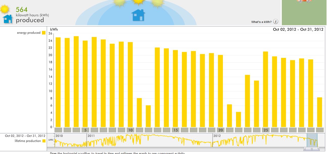

The July, 2014 results.
Above the model this month and reasonably consistent with July 2013.

The August, 2014 results.
Above the model but below August in the last two years.
