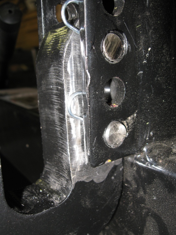

Put the hitch adapter and pins for the top hook on. The top pin of the HF QH is not full Cat. 1. I had to use my step bit to drill it out. Took a few seconds. A regular bit would have bound up.
Swung the hitch adapter up out of the way. Will not clear the hook. Can use the hook of the adapter quite quickly now.

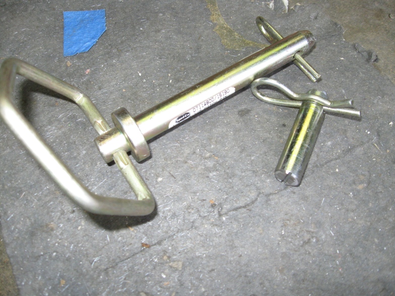

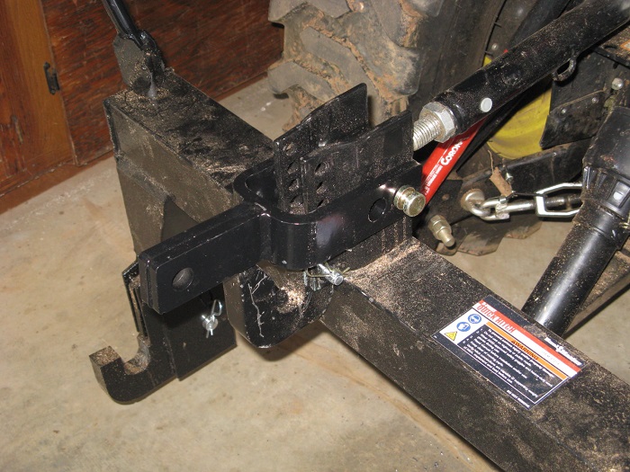

#24
Here are the pics of the HF QH with pins for the top hook from Kenny's boltonhooks web site and the hitch adapter from another place. The hitch adapter in various forms and prices from $20 to $46 is available several places.
One pictures shows the hitch adapter folded back out of the way of the top hook. In this picture, you can see the two pins holding the top hook. I used other securement than what Kenny sold me.
The other picture shows the hitch adapter folded towards the implement to use it instead of the top hook. With the pins in the top hook, it is easily removed.

I've posted this before, but I will add it here. The pins make moving the hook quicker, but don't solve the problem of interference with implements that have a relatively narrow top hook connection opening (like my Frontier box blade.) My short pins took care of that issue.

Just curious, how much was invested in adapters, bushings etc. beyond the initial $110 quick hitch?
The pins for the hook were $12 but about an equal amount for shipping. The adapter was $46. There are some around for $20-26. I liked this one. I spent a little more than the $150 I got for my old Mac.
