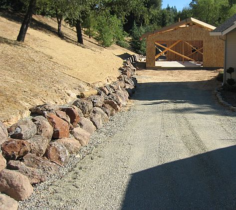

I backfilled my rock retaining wall with gravel to provide a firm backing that wouldn't wash out. Don't know why I was so concerned about wash out though, the hill side it "holds up" is so called partially decomposed granite. So called, because it isn't quite decomposed. You can go up there and pick axe a hole in it but can't dig out with a shovel. Amazing thing is the amount of rain fall we can have and still not have any water flow off the surface. It drains a lot of water really fast.
Attached pix is the wall I laid in. Not the nice flat stuff you've got though. But it's what's available in California. Holding a 2:1 slope, with 2' wide wall, gives me 4' more driveway width. As you can see I need it.

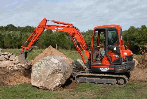

I cheated though on laying the wall. I didn't use my Kubota tractor/back hoe. I rented an excavator with a thumb. I actually had to take out an existing wall first, re-cut the slope to widen the drive way, dig a footing and then re-set the wall. It took twice as many rocks to reset the wall. Here is a pix of me on the rental picking up a rock from the original wall. Nice thing about the excavator is the stability. I could carry those rocks about 100' to my storage pile in the 'hoe bucket.

Nice job Dave! I don't think the excavator was "cheating", it's the right tool for the job. I have come very close to renting one for all the same reasons, especially to have a thumb which would make moving and placing stones so much easier. I also wanted to back the wall with 3/4" stone but had to settle for using all the small ones I could gather here, due to available $'s.

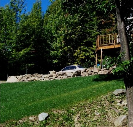

Slow progress. One pic for update. Almost up to needed level. Still some of those top stones are being stored there and have to be set or a better place found for them.
I've been "mining" more rock (removing old stumps and cutting in another "wood road"). The wall is coming slow as it takes more time to get the stones than to back fill the wall or set a few more stones.
As "catvet" says in "Woodland Road", too much to do before the snow flies....
Tom
P.S. (Grass is finally really coming in on that slope from "Seeding a Steep Slope" /forums/images/graemlins/grin.gif)
