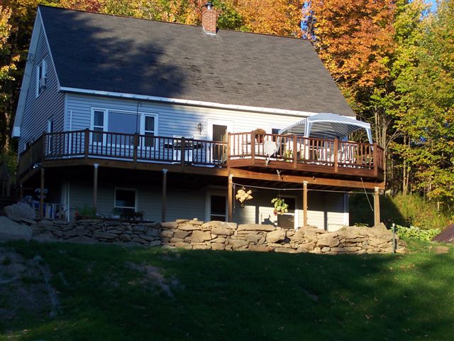

Probably the last pic for the season. Sun's getting low early these days and I need to get my "Fall" projects underway. I did get a couple more stones on, after this pic (taken 5-Oct) and they fairly big ones. Would still like to find a few more like the one about center top of the wall. It's 6-8" thick by 3' wide by nearly 4' deep. Takes a bit of finesse to get the big ones on top but, hopefully worth the time and effort. Well, next Spring, maybe, if the wall stays put /forums/images/graemlins/tongue.gif.
Tom
