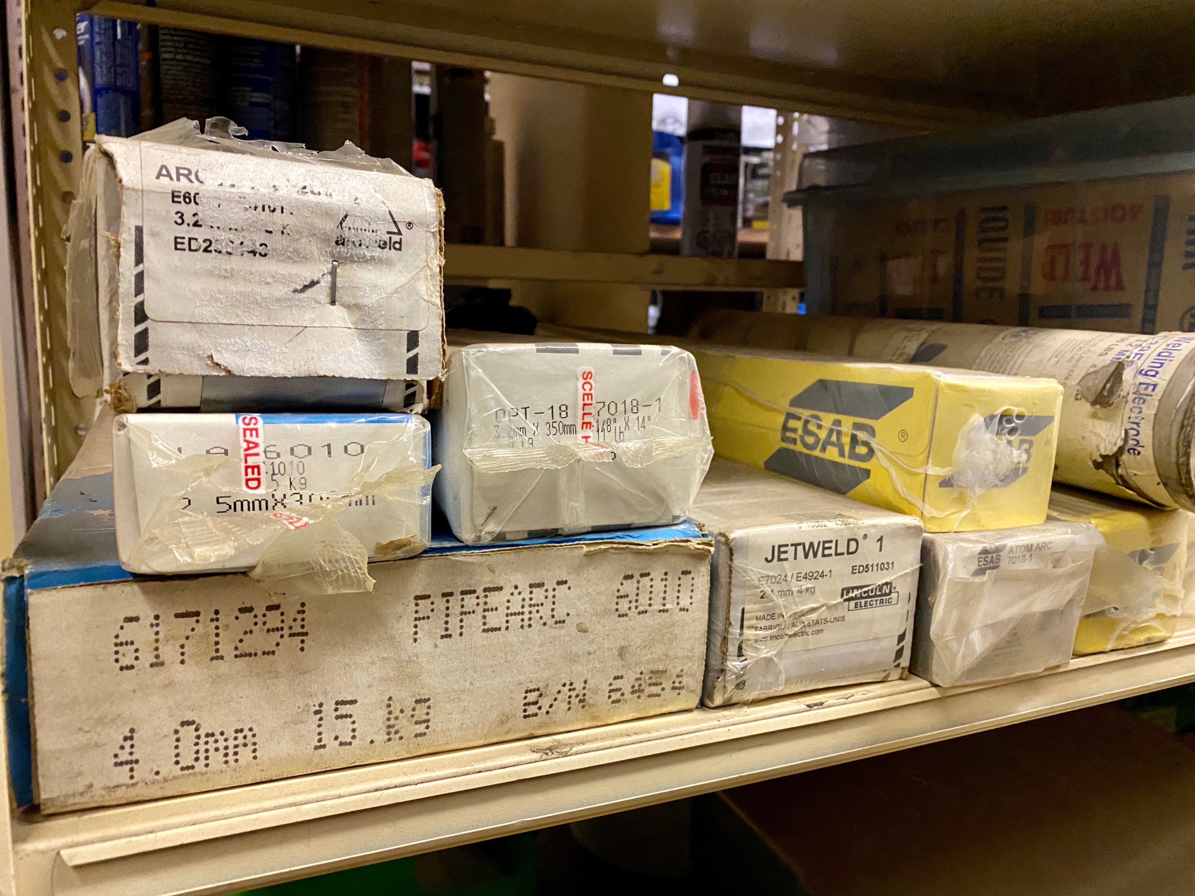

I’ve only used 6011 and 6013 on the farm with my buzzbox in the “old days”.
I bought a box of 6010 just to play around with a few years ago but still haven’t gotten roundtuit.
   / How to transition to MIG? #72
6010 on a buzzbox prob a no go. Used to do some with 6011 but the spatter was crazy, 6013 or 7014 is much nicer. Maybe a tad less penetration but you can turn up the heat a bit to compensate. Haven't done any AC stick welding since I got my Dynasty 200dx.

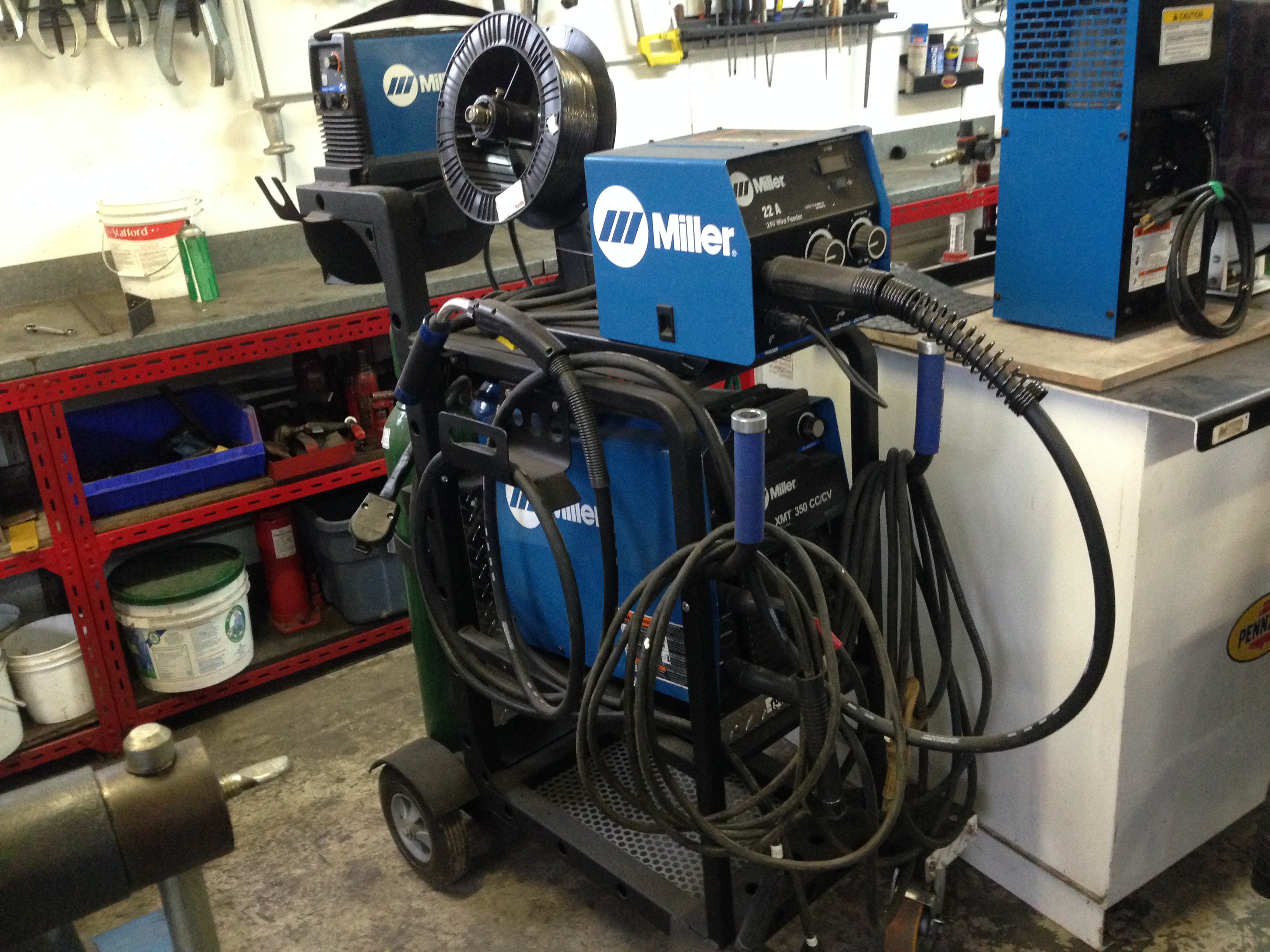

   / How to transition to MIG? #73
I have some DC welders now that should run the 6010.
   / How to transition to MIG? #74
I think 6010 root with 7018 is the classic way for pipe. I have not done pipe class so I am over my head in pipe. In MIG class they make you weld pipe to plate in all positions using MIG. Sorry I forgot to say it was pipe to plate not pipe to pipe.

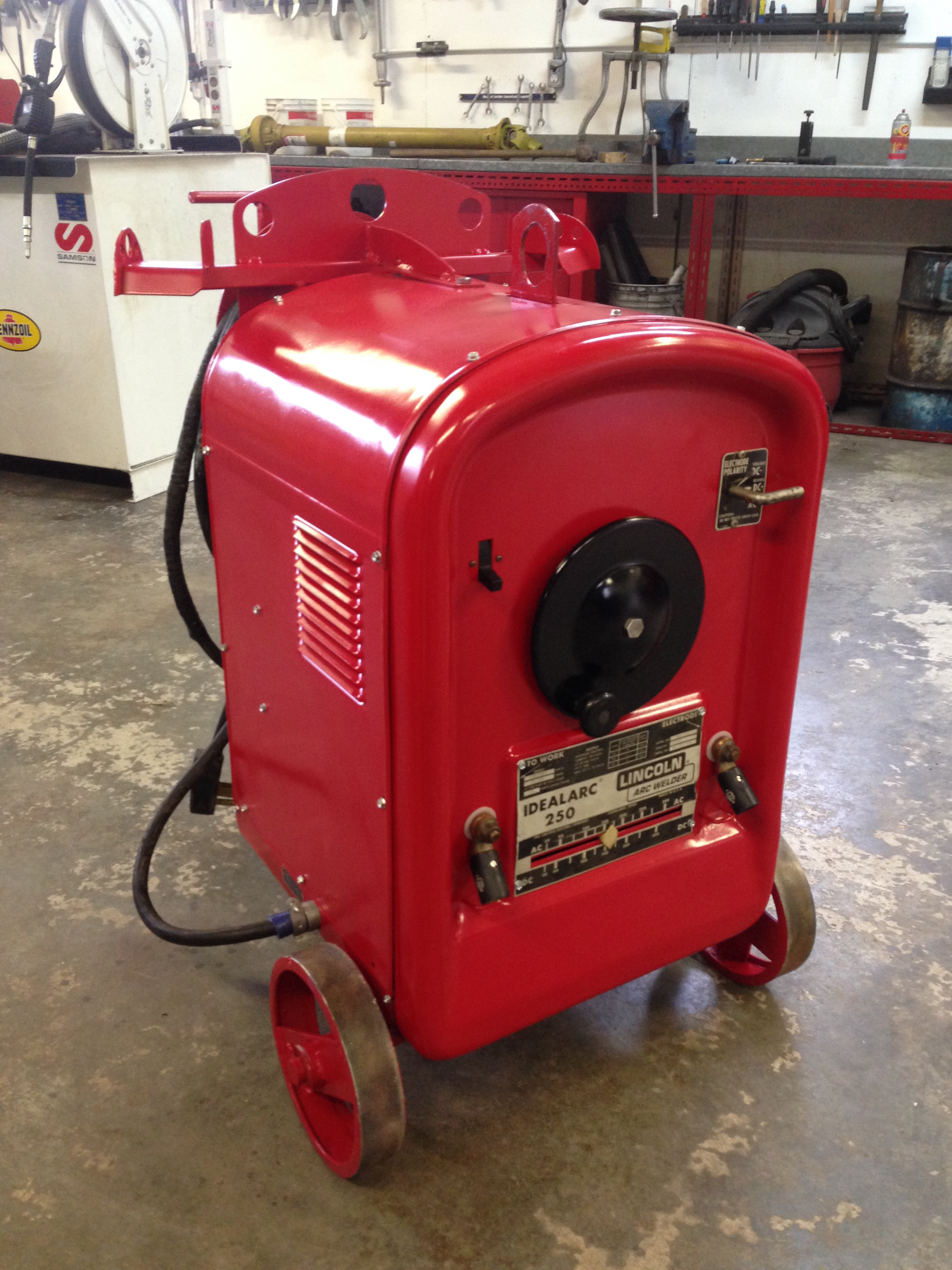

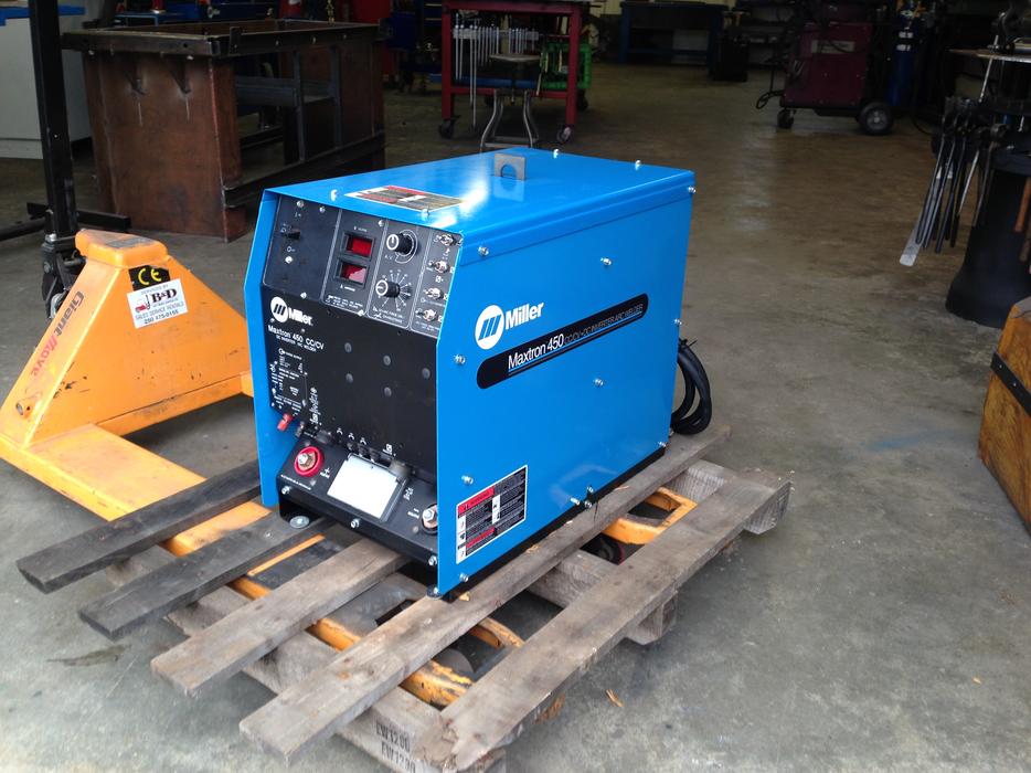

   / How to transition to MIG? #75
   / How to transition to MIG? #76
Nice welders.
When I took a Stick class in the late 70s we used Lincoln 250 amp AC,DC+,DC- machines. They were sweet welding machines with 6010 using DC. I think about buying one every now and then. They weight a lot and pull a lot of electricity so I have not.
If they were like mine you are right.
Totally sweet! Totally power suckers

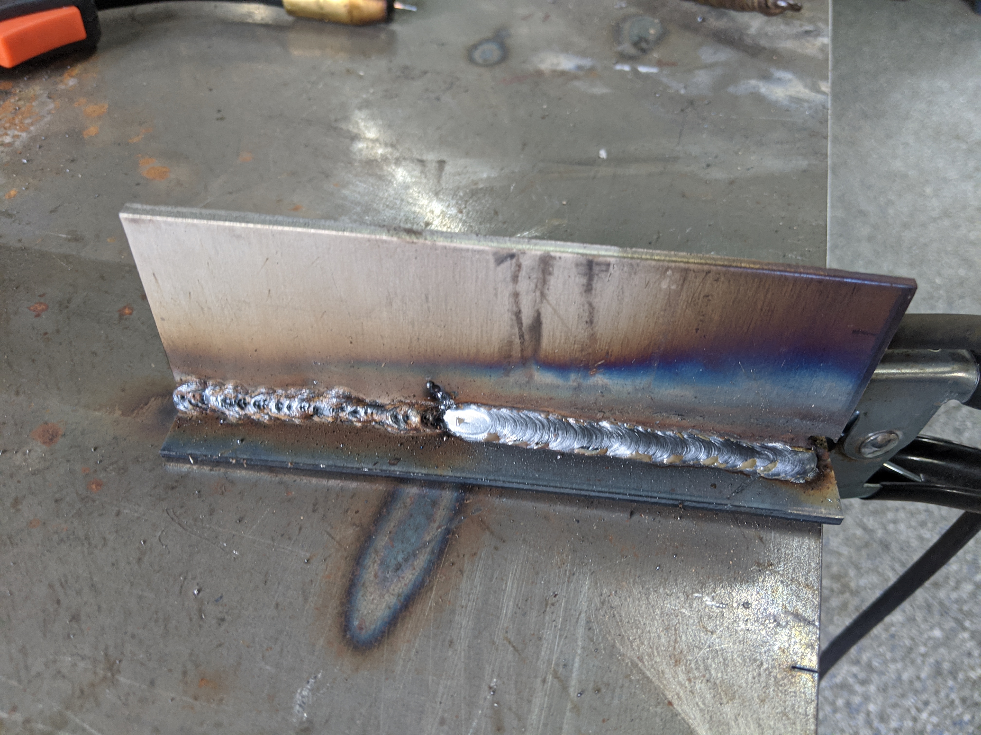

I can see why, to me 12 o'clock to 6 is easier using MIG than 6 to 12. Pushing MIG up a pipe is kind of hard. I think MIG goes down hill easier than up overall.
   / How to transition to MIG? #80
I know it’s frowned upon, but I try to leave a little gap and downhill MIG whenever I can. I run it HOT and fast.
Just personal projects of course and nothing to code.
