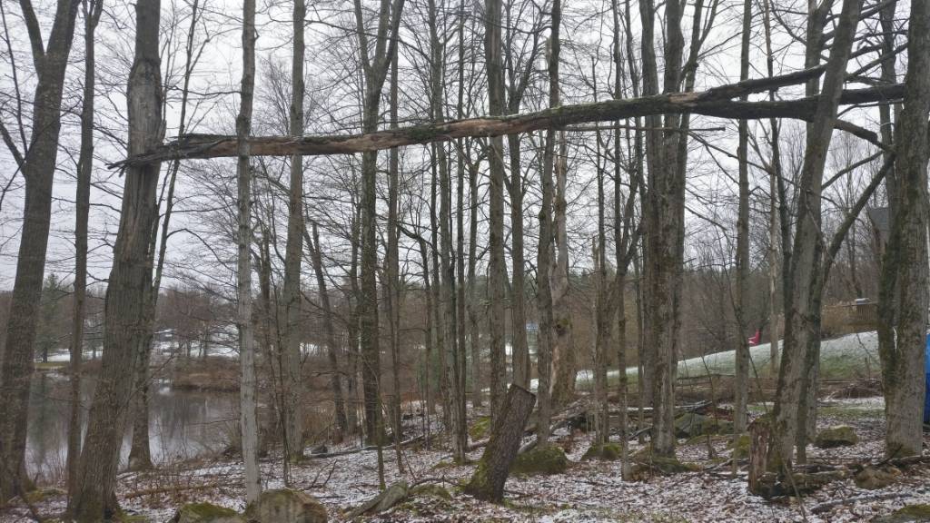

The picture doesn't show it well, but there is probably still 6-8 inches thick of wood that is hinged to the main tree (on the left). I don't think I'll be able to simply pull it off. I think I have to cut it.
My thought was go up a ladder on the left tree, and cut it at the hinge point, so it drops down away from the tree. I don't like the idea of being on a ladder, 15 ft in the air, when everything let's go, though. A lot can go wrong quickly, including the tree potentially springing back (and bucking me off the ladder) when the split portion is cut off.
Don't do that!!!
Plenty of YouTube videos showing those accidents.

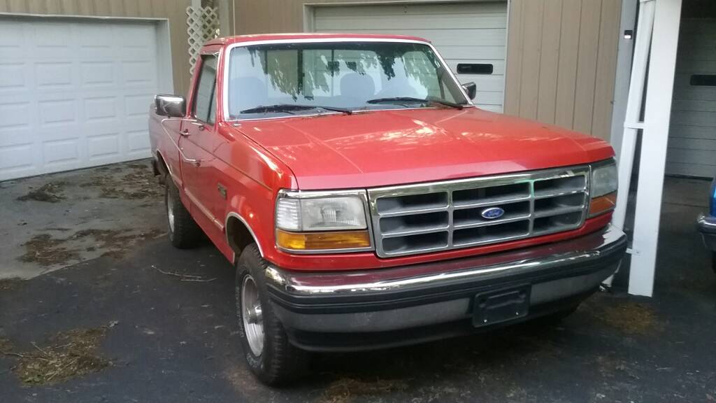

I recently had a widow-maker in woods that came down at a 45 angle, tangled in other trees. I one day got nerve enough to cut at the base since a large tree for protection between me and that one. All it did was slip down off trunk. I hoped wind would fell it...never did. So I went uphill cutting a big notch in it. Scary, so I'd cut a little each day, hoping wind+weight it would snap.
One day I got fed up and used three large ratchet straps, across creek to my 93 f150 farm truck hitch. 4x4, low range first (granny gear). Eased out on clutch...never touched the gas (300cu in 6). I thought it pulled loose, looked back truck was dragging that large tree. Once up on flat ground I easily safely cut it up.20200509_195830.jpg

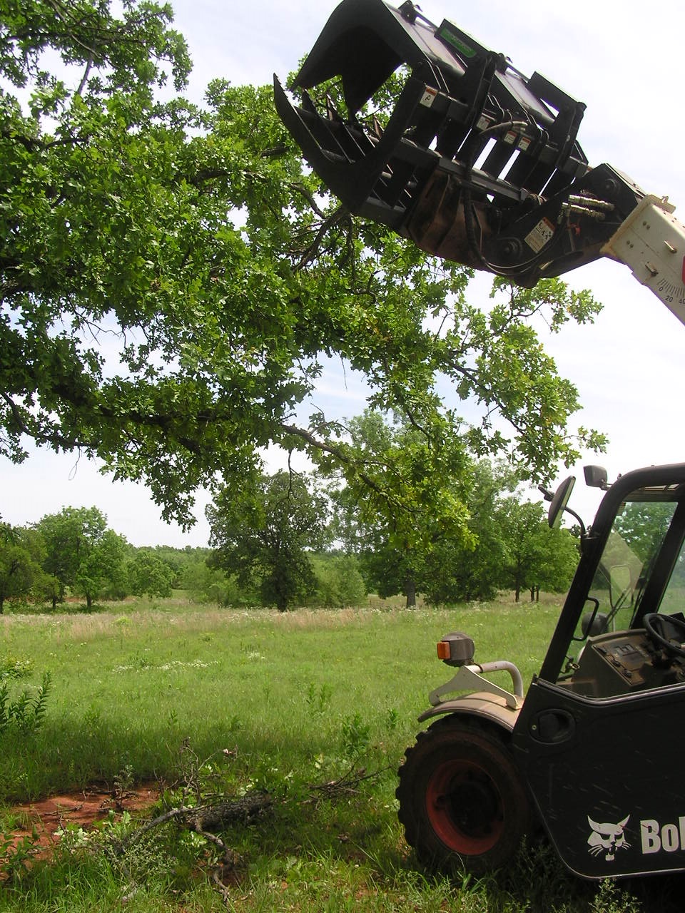

I’ve also seen this happen when using equipment, an excavator isn’t a forestry machine there’s no structure to protect the operator in the case of a limb or tree come down on the cab. Now to the falling how close you cut your pusher tree plays a huge roll in how the butt will act as well as how the face is done.
