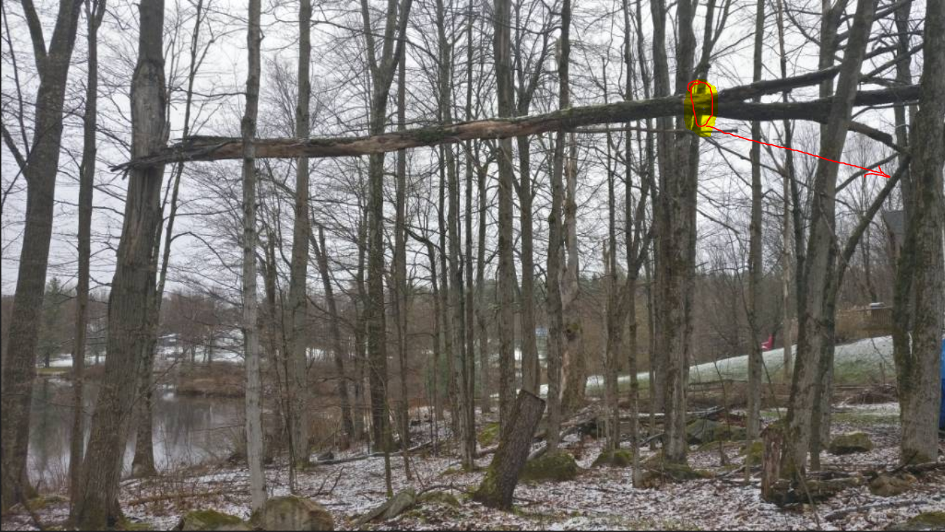

If it was me I壇 pick that triple topped tree to domino into the top of the other shooting for about where the red circle is. Now setting up something like this need to be done correctly use a humboldt face and a full face Dutchman with an extra kicker on the stump to try and get the butt on the ground fast as well as hard for extra force.View attachment 655089
I have done stuff like this well falling timber it works but you need to be confident in your skills as well as getting out of the line of fire at the right time.
Get a rope/chain around it at the red circle and pull. After 5 years it should almost break on it's own.

I'll try one last time...Running bowline where the red circle is and pull in the direction of the arrow (same direction the top is facing, not against the trees holding it up) from at least 50'-75' away with an arborist rope 5/8" or larger. Do not ever stand under it to notch another tree with pressure on it. They call them widow makers for a reason. Even experienced arborists have difficulty assessing the different loads due to so many variables. Do not ever stand on a ladder and use a chainsaw without an overhead lifeline.
My opinion is you have 3 options:
1. hire it out (safest)
2. use the same amount of money to invest in gear to do it safely (and have it for future use)
TreeStuff - Samson 3/4" Stable Braid Bull Rope
TreeStuff - • Notch Acculine and Throw Weight Combo Kit
3. shoot it down (most fun)

He may not be but it痴 still a safer alternative then standing on a ladder or B pulling on a line, rope, or a chain that could snap sending a while or shrapnel at the back of him or his face. I do agree he more then likely doesn稚 have the skills to do a job like this but something done from the ground is possible.
I certainly agree with you there. No way I would attempt to deal with that while standing on a ladder. I might resort to my 12 gauge tree pruner before considering cutting on that from a ladder. (Though if he's right about the amount of hinge left, I might be wasting a lot of shells in the attempt).
I'm sure there are ways to get it down safely from the ground. It's really hard to tell without being there and being able to get a look from a variety of angles. Tree felling advice over the internet, especially storm damage clean-up advice, is never a great way to go. You can give tips and things to consider, but in the end, something like this really needs an experienced person seeing it in person to consider those tips and suggestions before deciding on the best approach.
I might consider dropping the tree at more or less 90 degrees to the direction of the broken limb, so that whole "L" shape (or rather, the side-ways T shape) would just fall over on its side. Deciding whether to come toward the camera or away from it , and whether to adjust to something other than 90 degrees to maximize the chances of getting it down cleanly would probably require an in-person look at how it is hung up. It would likely also require clearing out a couple of the other smaller trees that might prevent it from falling cleanly. While I tend to avoid ropes and chains in my felling (there is almost always another way), in this case, I might tie something up as high as I can easily get to before I started any cutting (probably the only use I'd have for a ladder in this situation). That way, I'd have something to give a tug with if the "L" shape did not want to tip over on it's own. I would not want to be hanging around the base of the tree pounding wedges with that large branch hanging up above: I want to make my cuts, then get the heck out of there. If the cuts are made properly, it should not take a huge amount of force to persuade the tree over: you would just be giving it a nudge (from a safe distance), not trying to break wood fibers.

I need to start clearing some land, but the first thing I need to tackle is this wind damaged tree that has been hanging out like this for about 5 years.
Any suggestions on a safe way to get it down?View attachment 655037
As we look at that picture, ultimately how many of the trees we are looking at will be taken out? If that entire area will be cleared it would change the way I would tackle it.

To option 2, I would add get yourself some training to learn how to use that gear safely. There is a lot more to doing this safely than just having a strong rope and something powerful to pull on it. If I had to choose between knowledge and gear, I'd pick knowledge almost every time - even if sometimes it's just the knowledge that "this is just too much for me. It's time to call a friend or call a pro."
I spent a full day in a Level 4 Game of Logging class intentionally hanging up trees so we could work on getting them down onto the ground safely. I spent another day at their Storm Damage Clean-up class trying out different techniques for dealing with storm damage. (Cleaning up severe storm damage is probably one of the riskiest things I've done in the woods.) Even though I had already been doing a fair amount of that sort of thing, I got so much out of it that I repeated the storm damage class. If I have the opportunity, I would happily pay for a repeat day of freeing hung up trees. I get as much out of the discussions of the possible approaches and watching how others do it (under the supervision of someone who is both experienced AND a good teacher - you need someone with both skill sets). The work greatly expanded the range of techniques I can bring to dealing with difficult trees. More importantly: it also made me a better judge of when something is simply beyond my abilities, or beyond the capability of the equipment I have available. I'm always trying to expand my range of techniques, and being a real gadget hound, I always have an eye out for cost effective additions to my equipment (and including some equipment that I could not cost-justify, but got just because I wanted it.)
