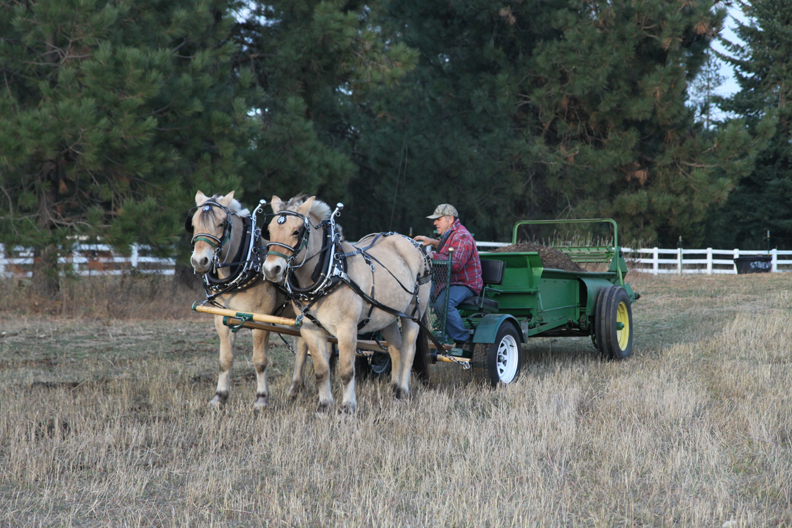

I won't store manure in my manure spreader mainly because its an old 1940’s vintage wooden machine. I keep it stored under cover. Works great and is either towed by my horse team or behind my side by side.... depending on my mood.
I store manure in compost pile and spread 2 times a year.

I too thought big bucket, but it's still too far to drive. I am adverse to working with highly corrosive manure for the most part. Used sheit spreaders are very cheap. Maybe take off or disconnect the paddles and just use the moving floor to unload. I don't know much about how sheit spreaders work.
mine uses tire movement to operate, but i suppose there are pto versions out there. Would not think its too useful just to transport. Once fill mine its off to the pasture to fling it i go. IMG_0337 small.jpg
