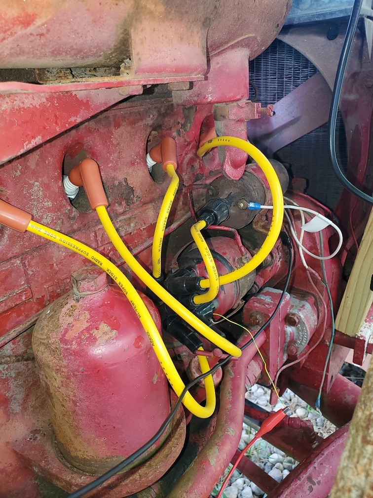

Thanks for the link.
We went to O'Reiley this evening and got a couple to try. One has 2 terminals, the other has 4. I was thinking maybe the 4 terminal one would have different resistance values. However, it looks like the pairs are individual and dont connect. I can check with my multimeter tomorrow.

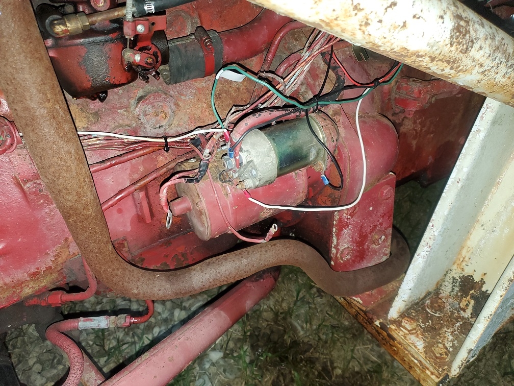

When I dug in to the distributor clocking earlier I took the valve cover off to see the valves and lifters. I lined up the #1 piston on the compression stroke, clocked the fan belt pulley on the crankshaft to TDC, and guess what - the rotor was pointed to the #4 cylinder/3ord to fire. Go figure.
Needless to say, I got that corrected.
WIth the clocking correct I was able to get the engine to run a bit. Major milestone.
The down side to it is I found the ballast resistor was not working very well.
With my relay method I was able to get battery voltage to the ignition coil with the starter engaged. However, the engine would die without the starter engaged. Checking the voltage it was under 2v through the ballast resistor.
So I jumped the leads going to the ballast resistor to get straight battery voltage with ignition on and I wasnt having any luck at all.

/ International 444, 1968. Progress Thread, Getting Going #63
A sneaky way to get 12V to the coil would be to run a wire from the terminal on the side of the starter solenoid that energizes the solenoid. That way you only have 12V to coil when engaging the starter. In the schematic, I think I'm seeing a wire running from part #61 to the input side of the coil. Not sure what exactly that is, since Case/IH took away the description since they don't handle that part anymore. I have sent emails to the sites guru's telling them it would have been so much simpler to put N/A in the description, rather than eliminate the part description/number itself. It apparently fell on deaf ears, and why I have purchased several hard copies of parts manuals for some tractors I have. A necessity if looking for used parts, whether at salvage yards, or places like ebay.
You sort of lost me where you're picking up the 2V. Is the on the output side of the old ballast resistor, or at the terminal on the side of the distributor..?? If you removed the wires from the ballast resistor and jumped it completely, you should show 12V going into the coil. Now you need to check voltage going into the distributor. If it's still showing 12V the coil does not have an internal resistor. If it's showing 6V, it does. If it in fact does show 6V, then once the starter is released, and current is running through a functioning ballast resistor with output of 6V may be reduced even further going through a coil with a built-in resistor I'm thinking would reduce voltage even further, but not sure.
With the distributor cap off, do note the direction of rotation of the rotor button to get the proper firing order of 1-3-4-2. Not all IH distributors turn the same direction, but it should tell you in your manual.
It's probably a good thing you were only getting 2V with firing order out 180º, or you'd have more than likely gotten a big "KER-POW" firing on the intake stroke. Don't ask how I know... Let's just say it was a lesson learned many moons ago, and something you don't forget. But they will also do that with a cracked cap, or having a carbon trace between lugs inside the distributor cap.
If the new ballast resistor does solve those issues, might be an idea to get a spare, and put it where you know where it is. They have a tendency to burn out at any time with no rhyme or reason. I had one burn out of my old Case 310B backhoe that someone had converted to 12V. I put a new one on it but thought if it was going to be a problem, I'd better get a spare. With my luck at times, if it does burn out, it's 5 minutes after the parts store closes and I really need it at that moment.
It does sound like you're making progress, just stick with it. All the diagnostics you're doing will come in handy in the future if something happens. For a gas engine to run it boils down to 3 basic items. Air, spark, and fuel, in proper amounts and timing. Check the easy stuff first, usually spark and fuel.
The 2v was at the input to the ignition coil.
The "hot start" 12v power, normally, comes as passed through the starter solenoid. Before I started working on anything I photo documented everything for future reference/to see how it was "together". The wire going to the ignition coil terminated at this same tap on the starter solenoid, as does the wire from the ballast resistor.
What I understand to happen is when the start signal from the key switch energizes the start solenoid to engage the starter - that same engagement of the starter trips the power to the tap going to the ignition coil - just like a relay output. The other day this is where I was getting the under 2v, indicating that there is an issue with this tap on the starter solenoid (I assume grounding out, though there is no issue with the power going to the starter - it cranks strong).
When I bypassed the terminal on the starter solenoid I used a 20a rated automotive cube relay (5 pin - 2 coil and 3 for NO/NC contacts). I have it wired in to the same power and signal wires going to the start solenoid. The lead to the ignition coil has the addition of the lead from the ballast resistor.
What I found in that wiring method was when the starter was engaged I had battery voltage at the ignition coil when the starter was engaged, but it dropped to under 2v through the ballast resistor in "ignition on", without the starter engaged.
So I bypassed the ballast resistor yesterday and joined the wires that would have gone to the ballast resistor together so as to get straight battery voltage to the ignition coil with simply "ignition on" to try to get it to go. It did, a couple times.
Now I have some ballast resistors to try so I will get that straightened out as I work on it today.

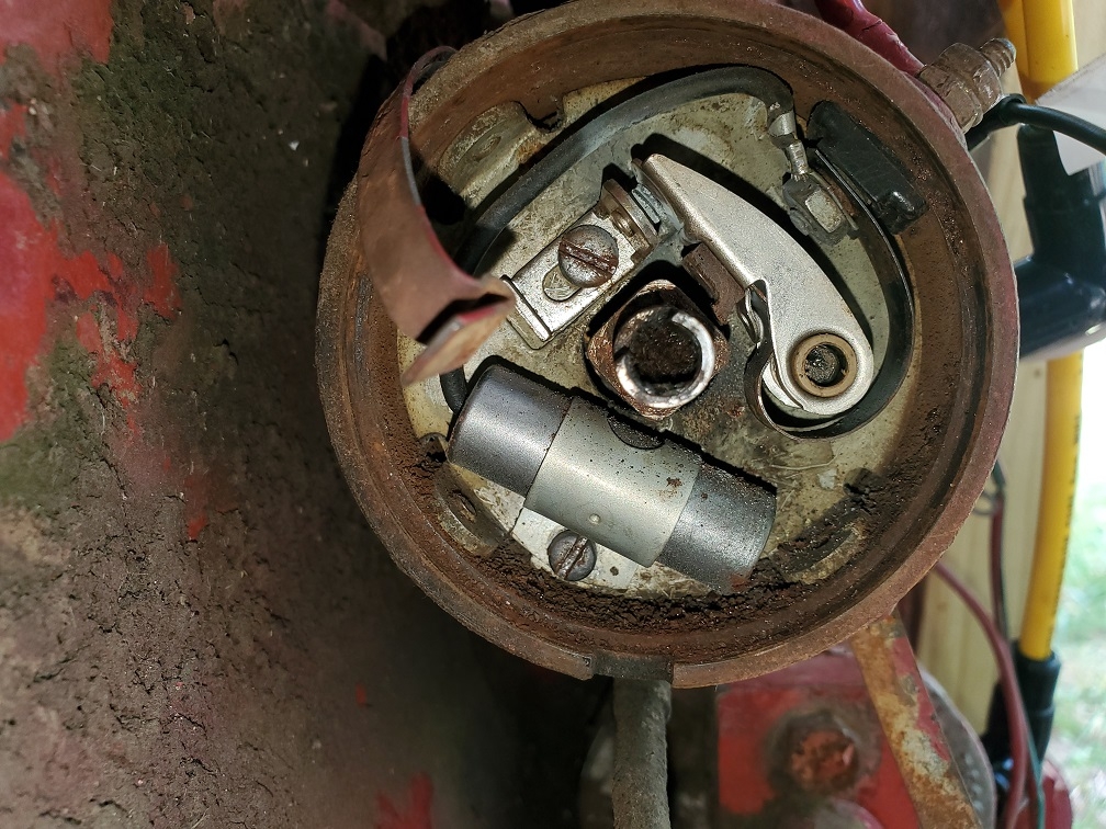

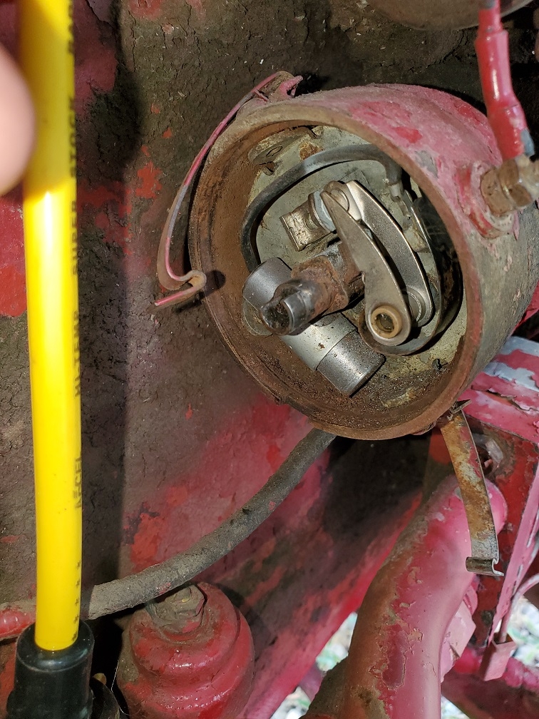

We got the tractor running - finally.
When I had it "running" the other day apparently the distributor rotor - brand new with the rebuild I did - disintegrated. A buddy of mine came over with a timing light and some other gizmos to help out and we went tracing things and poking around. He pulled the cap off the distributor and the rotor had no contacts on it. I later found the blade in the gravel under the tractor. I have yet to locate the wiper contact.
We put the old one back on and it fired right up.

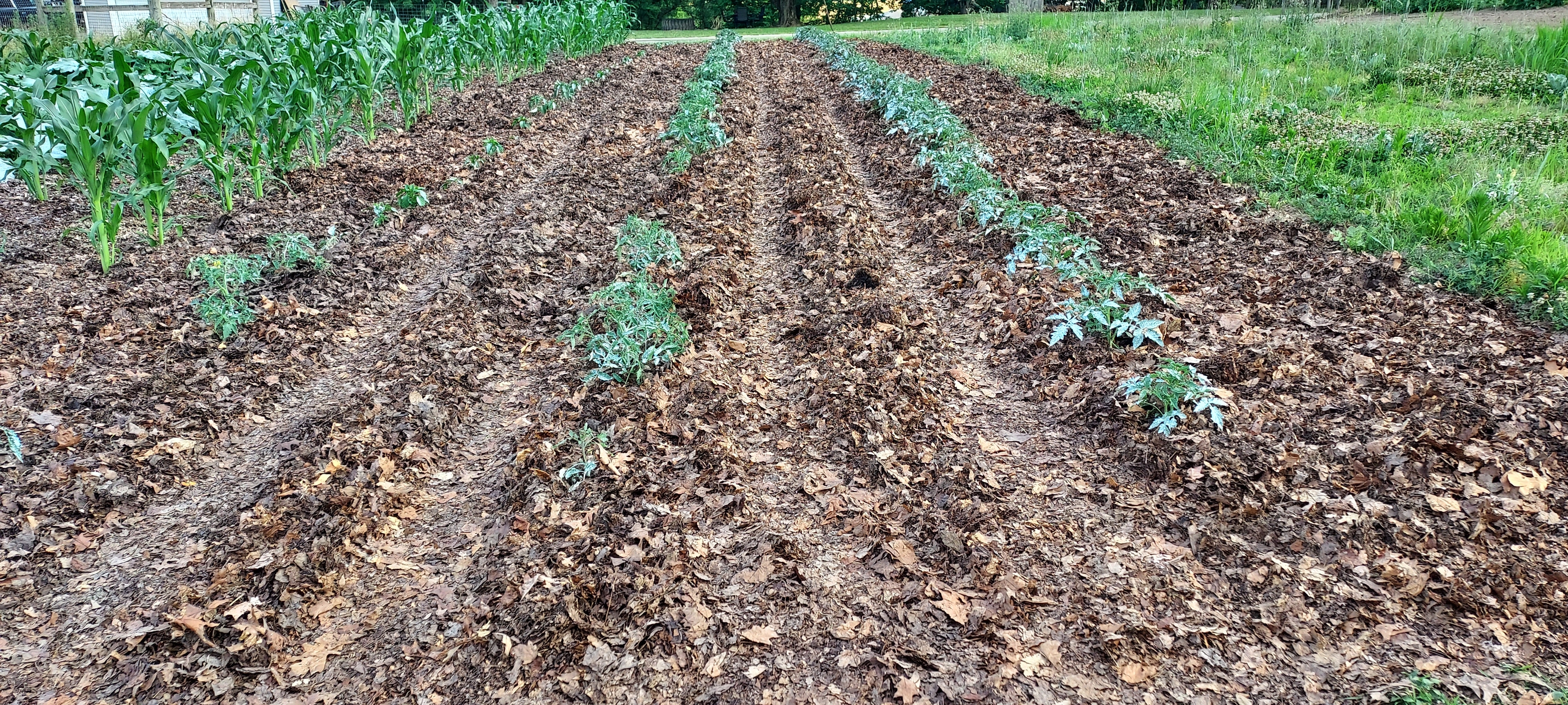

Not sure what set plants you plan on growing, but I mulch around mine with leaves. I collect from neighbors and know a couple guys that have and work for lawn services that do leaf pickup in the Fall that are more than happy to drop their loads of leaves here, rather than paying to dump them at a compost facility. Just a little FYI if you know of any lawn services close that provide that service. The season is nearly upon us for that, if you have plenty of room for them to dump. Here are a couple pics of my tomatoes this year. I mulched them mid-June, second pic is 2 weeks ago. Nearly weed free, and this year was a life saver with the drought retaining what little moisture they did get. Held them over until we got the 3-1/2" of rain from Helene, now they are back going like gangbusters, while everyone else's in the area are long dried up. Going out and pick a couple bushel's this morning.

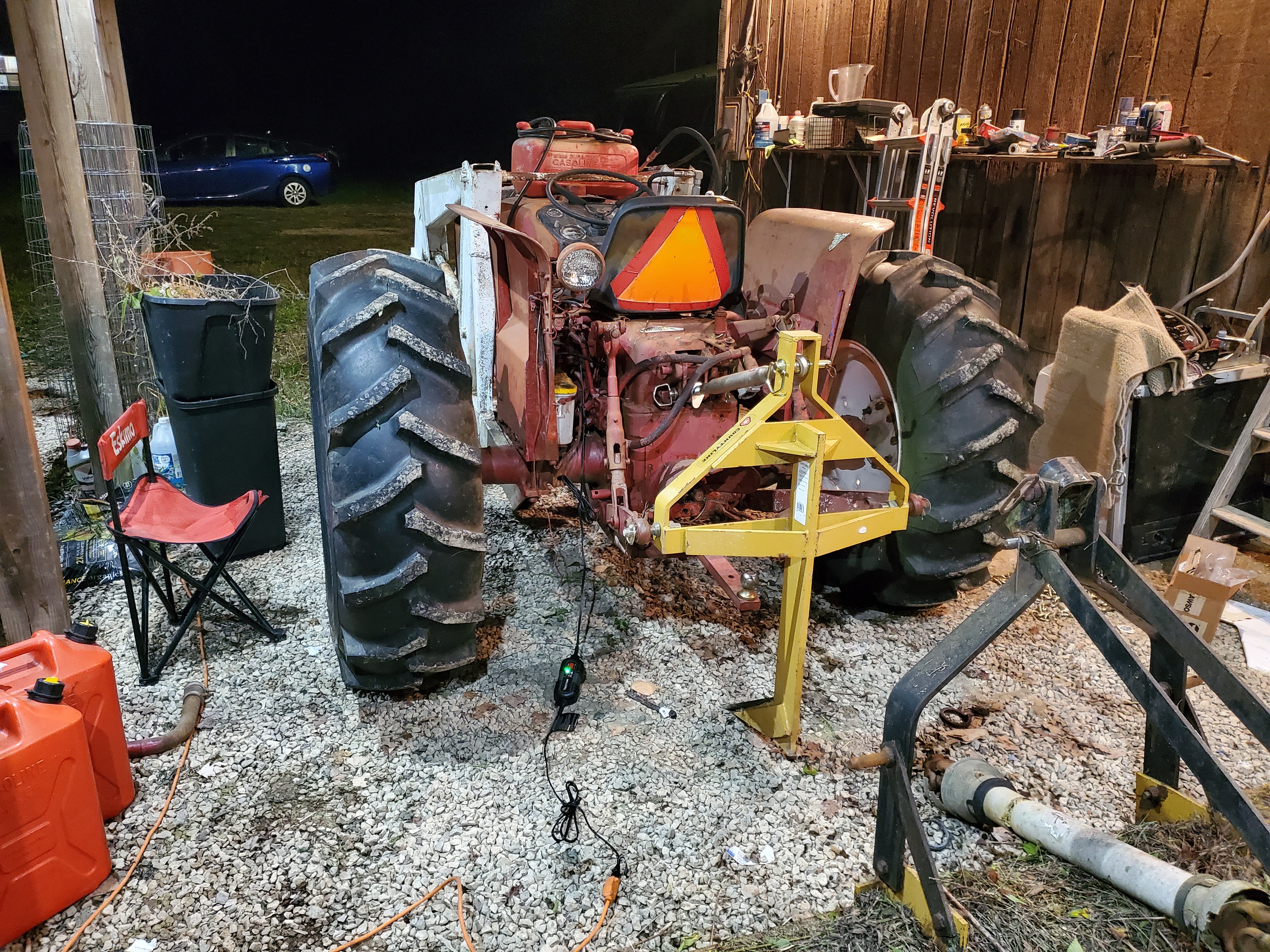

So a new conundrum of sorts - I think...
With the brush hog this wasnt a huge issue, but was noticeable - the 3pt draft arms swing freely side to side. There is a retaining "chain" on each one to prevent either from swinging out too far.
However, I have not figured out how to tighten things up to prevent the swinging.
I hooked the ripper up tonight and got to thinking about this - I dont want the tillage tools swinging side to side, I dont think. That would make it impossible to be even reasonably accurate with where the tillage is occurring.
Thoughts?

/ International 444, 1968. Progress Thread, Getting Going #79
Not familiar with the chain set up on it, but normally where the chains attach to the connection point on the tractor is usually a "U" shaped clevis with a pin through it. Remove the clevis, and drop some links sliding dropped links back, so the clevis goes through and pulls on the front of the loop of a link in chain.
You can limit swing, but you don't want it rigid either. It does need some sideways movement to allow if you hit a rock, or just a slight turn of the steering wheel, while really not realizing it. A tillage implement if set up right should follow the central draft of the tractor. I'd try it as is for now and see how it does. On that subsoiler the main thing is to have your lift arms equal so the subsoiler shank is plumb. Once in the ground, it should follow the center draft of the tractor.
You'll probably have to play with the top link adjustment to get the subsoiler set to pull itself into the ground. Also enough to get it to pull down on the rearend of the tractor to provide extra traction when ripping. Those pull hard, especially if you're ripping through old hardpan if it has been farmed before, moldboard plowing.
Not sure on how deep you plan to rip, but if more than 14"-15" you'll want to maybe make 2 passes. Not that it may not pull it, but a buddy of mine has one just like that and bent the shank with a 50 hp tractor. Those shanks aren't tempered steel and although heavy, they will bend in the right ground conditions. He waited until it was really too dry to run his through a low spot he grows in and hold water.
Also, not sure what type of soil you have, but always remember there may be a big rock under the surface somewhere. Just be prepared to come to a sudden stop at any time.
