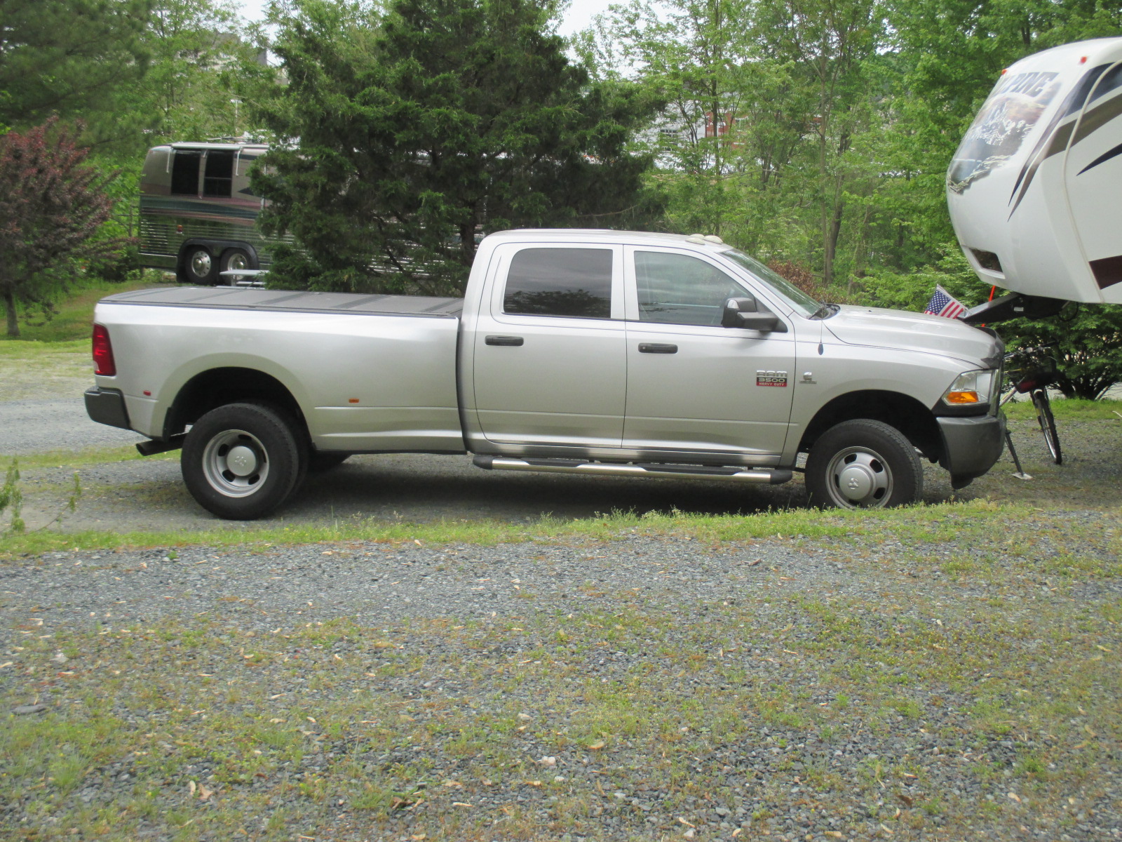

this is utterly irrelevant for towing, but a quirky requirement of mine, being a no bling person, is that I would really, really like to have a painted grill, and not the chrome Peterbilt wannabe look that seems so prevalent. I'd be very happy with a midline painted grill cloth seat truck, as long as it has most of the options. I do not need Corinthian leather woven into King Ranch door pulls... I'm going to see the head of truck sales at the local Ford dealer next week, and will start the seat testing.
From what I've seen, a 3.73 or similar rear end is about the right compromise. I love the new 30k ratings by Ram; so bothered Ford they steroided the F450 and now the 2015 model can pull 30K also. Didn't that use to take a dump truck?
btw, I liked this Ram, clean and simple, more like a proper tool than a social status elevator. I always did like the silver Platinum model Ford F150's, the chrome sort of blended into the silver and downplayed it. We sure do like our chrome. And of course, being a motorhead, I have a variety of polishes to make sure that chrome gleams. A little dab of Simichrome?
Just not too much of it. Nor do I need a twelve inch circumference exhaust pipe.
