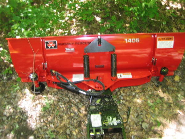

I have a 60" front mount power angle blade like the picture below, which I believe will clip onto the front weight bracket of a 3320. I've seen an identical mount on the MF GC2300 and if I recall on some of the smaller Kubota's. It's used for the blade / broom / snowblower. I have to experiment, but essentially the plow bracket requires a mounting surface 13 1/4" wide x 5" high and approx. 1/2" thick. If it does not have to be green / yellow you might get lucky and find a used cheap used one. The blade construction is actually quite sturdy.
