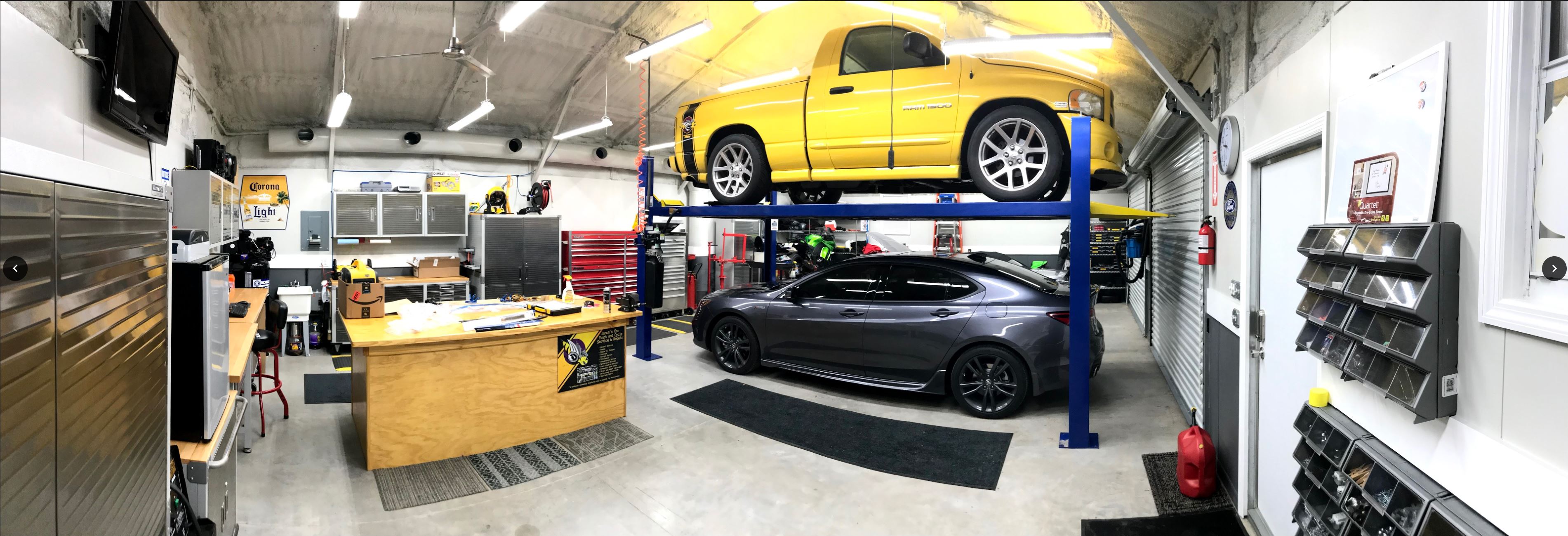

  • Oh and I consider myself 1 notch above a shade tree mechanic. lol I've included a pic of my garage below.
   / Kubota BX25 FEL falls under own weight #34
If that is your shop, I think you should take it in for repair.
I couldnt imagine working on a messy hydraulic cylinder in there. Would hate to get a bit of oil on the floor/bench:laughing:

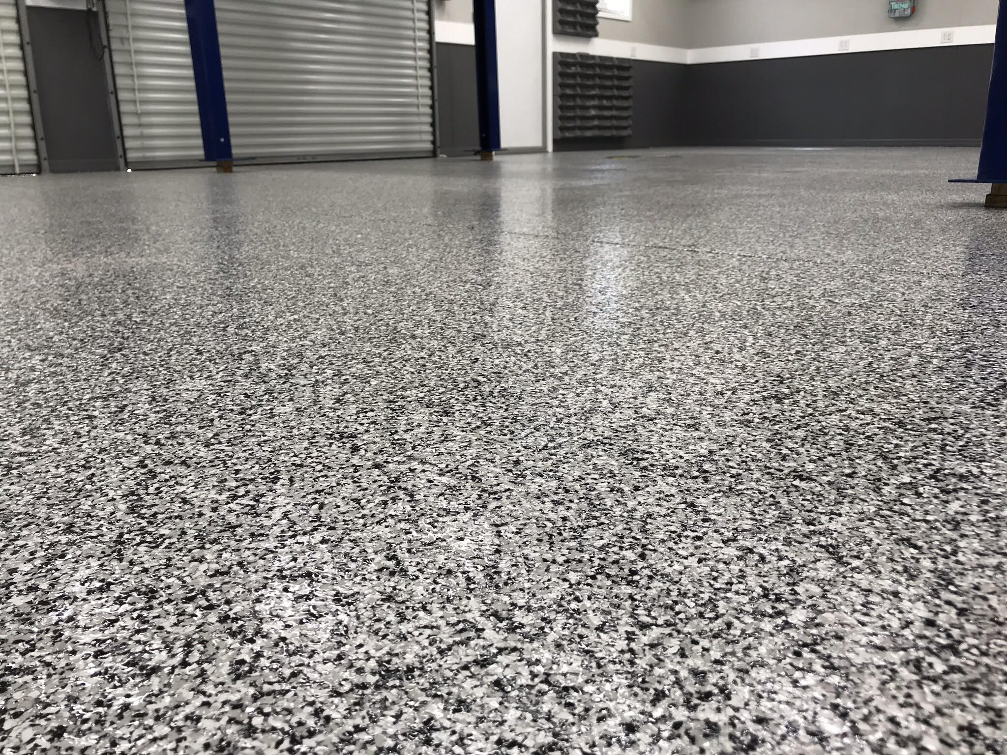

Lol! I just had the floors done a few months back too to prevent future oil stains. I have a floor resistant to must chemicals except battery acid and brake fluid.

Holy Magruder there dubo - you could just pitch it on that floor and start eating. Nice job. I kinda think LD1 has the right idea - - I wouldn't think you would want to mess up that shop or floor either.

LD,
You have to look at this from a different perspective .
1) you can use the car lift to help pull the cylinder apart.
2) You can then use the lift to help push the cylinder back together.
3) When you drop something you might actually be able to find it very much unlike my work area....
