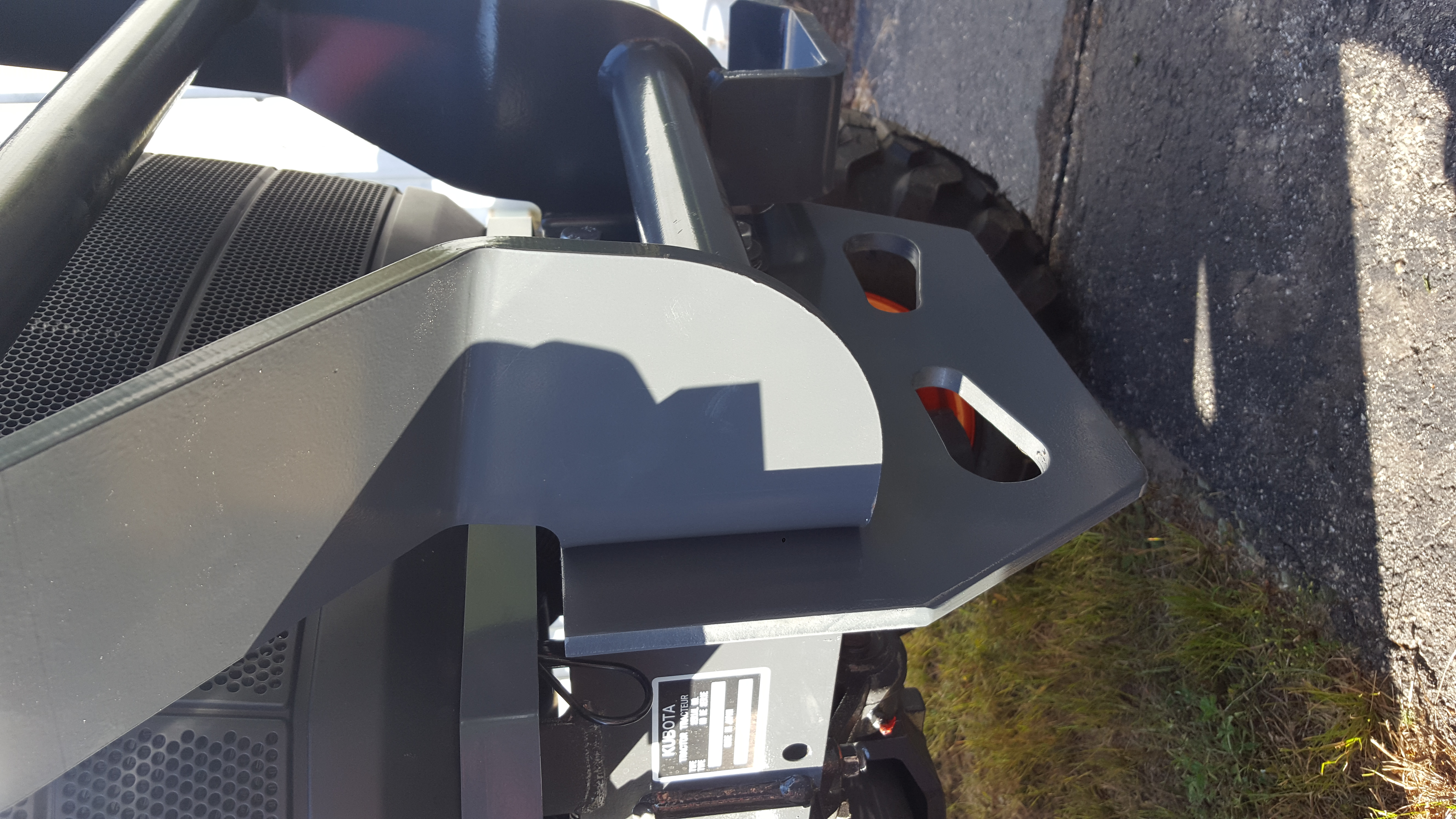

In reality, slow boat from Georgia. Most Kubota's (except the larger M Series are made in Georgia, not Japan.
   / Kubota Super UDT and filters. #39
The loaders & I think hoes are made in Georgia. The tractors are made in Japan. US distribution & possibly some assembly in Georgia.
   / Kubota Super UDT and filters. #40
Yes my loader has a tag that say's Georgia.
