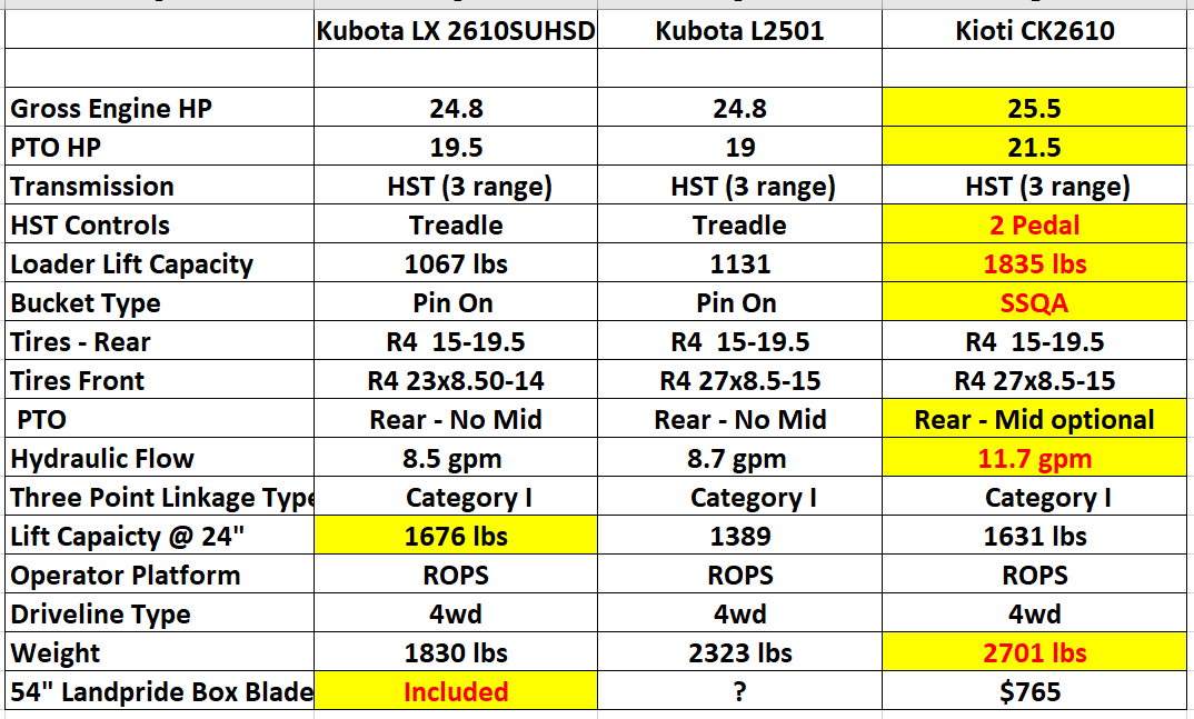

The Weight, Loader Lift Capacity, SSQA, and No Goofy Treadle are big advantages for the Kioti.
It appears from this and posts here and elsewhere that Kioti has targeted Kubota effectively. Enough gripe about the treadle pedal, for instance, that that's a no-brainer place to offer an alternative.
I think a lot of Kubota but it, and its dealerships, need competition and not just from JD to keep improving.
I agree. Who the heck wants to keep switching between pedals just to change direction? It's a lot more convenient to switch from toe to heel.
Good point! 👍

Most people have not commented much on the fact the Kioti has SSQA standard. I would not own a tractor without SSQA. Been there done that and have the shirt. That alone would keep me from buying that Kubota. With SSQA comes the ability to have forks, grapples etc on your front end. Without it you are screwed.
