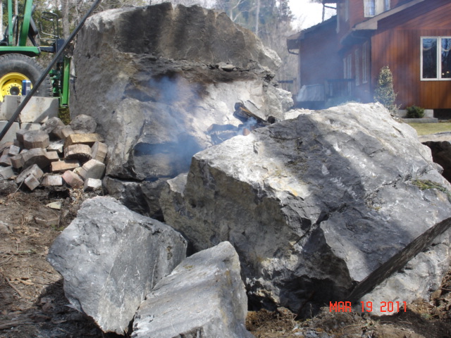

Go back to the fire, but with a better technique.
The Romans used to dig vertical shafts through rock by building a fire and then quenching the rock with water. That whole rock is about the size of one of their shafts.
A friend of mine has been in Ghana for 3 years, as a construction supervisor. They also dug wells, by hand: They used the same technique: heating it for 2 or 3 days, then dump LOTS of cold water on it, all at once. It shattered rocks up pretty good. If the chunks were still too big to handle, they drilled holes in it with an electric hammer drill and a generator. Labour is cheap in Ghana so i dont recommend the drilling part, but making your burnpile around it for the next few months, will do miracles. ;)

Merry Christmas :), Looks like Santa and his elves where busy last night, woke to instant results :laughing:

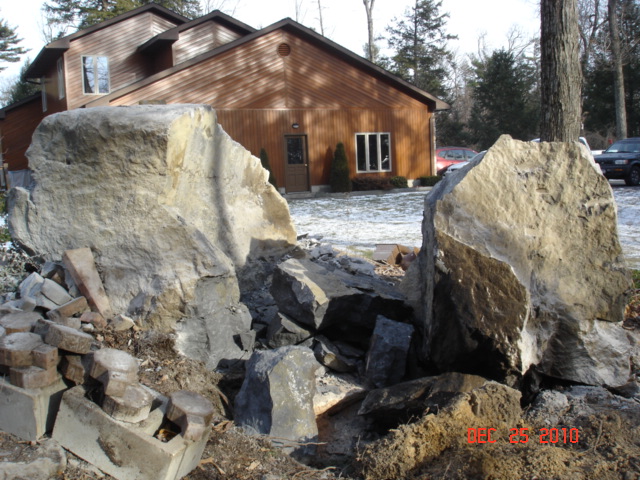

That's amazing, some of the boulder even split off in perfectly formed bricks and cinder blocks at the left! A miracle!

This was a long winter we never got a break from the snow, so no progress on the rock, untill today. I still can't believe how well this is working.:thumbsup:
