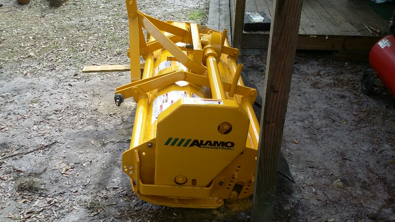

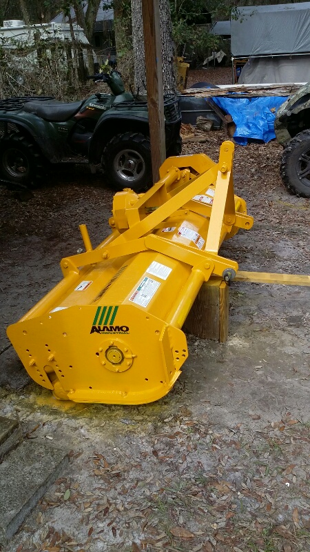

My new flail mower arrived sometime Thursday Here's what I found, after opening the crate, 8 bolts later it was ready to move. Then it rained and rained some more, maybe tomorrow it will actually be removed from the box. One of the warning labels said to read the instructions. They weren't on top so I'm guessing they are underneath.
From What can see it looks decent. The welds are good and they added some bracing to the 3 pt. This one has a comer transmission instead of a gearbox so that the driveshaft will fit either side
