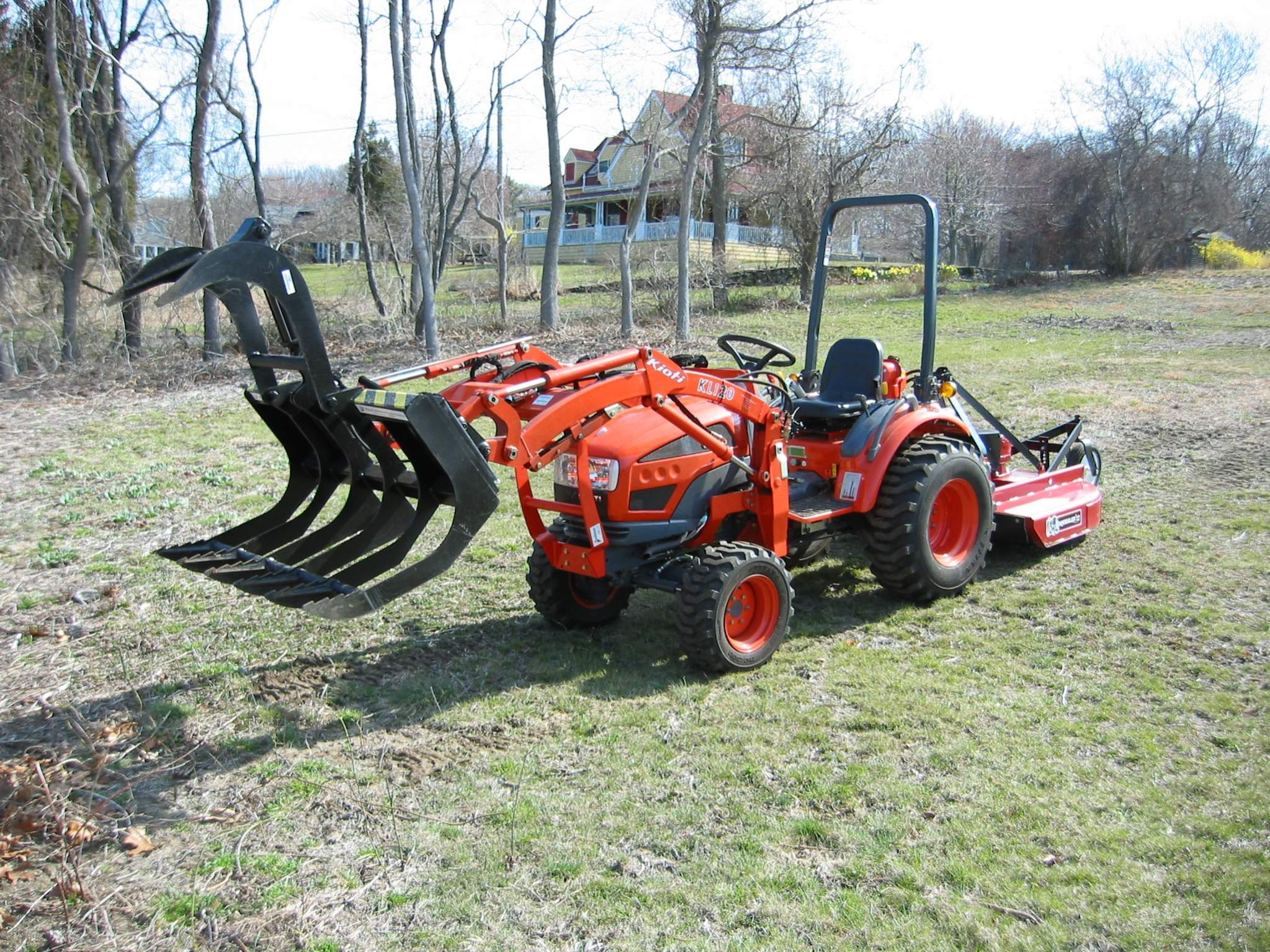

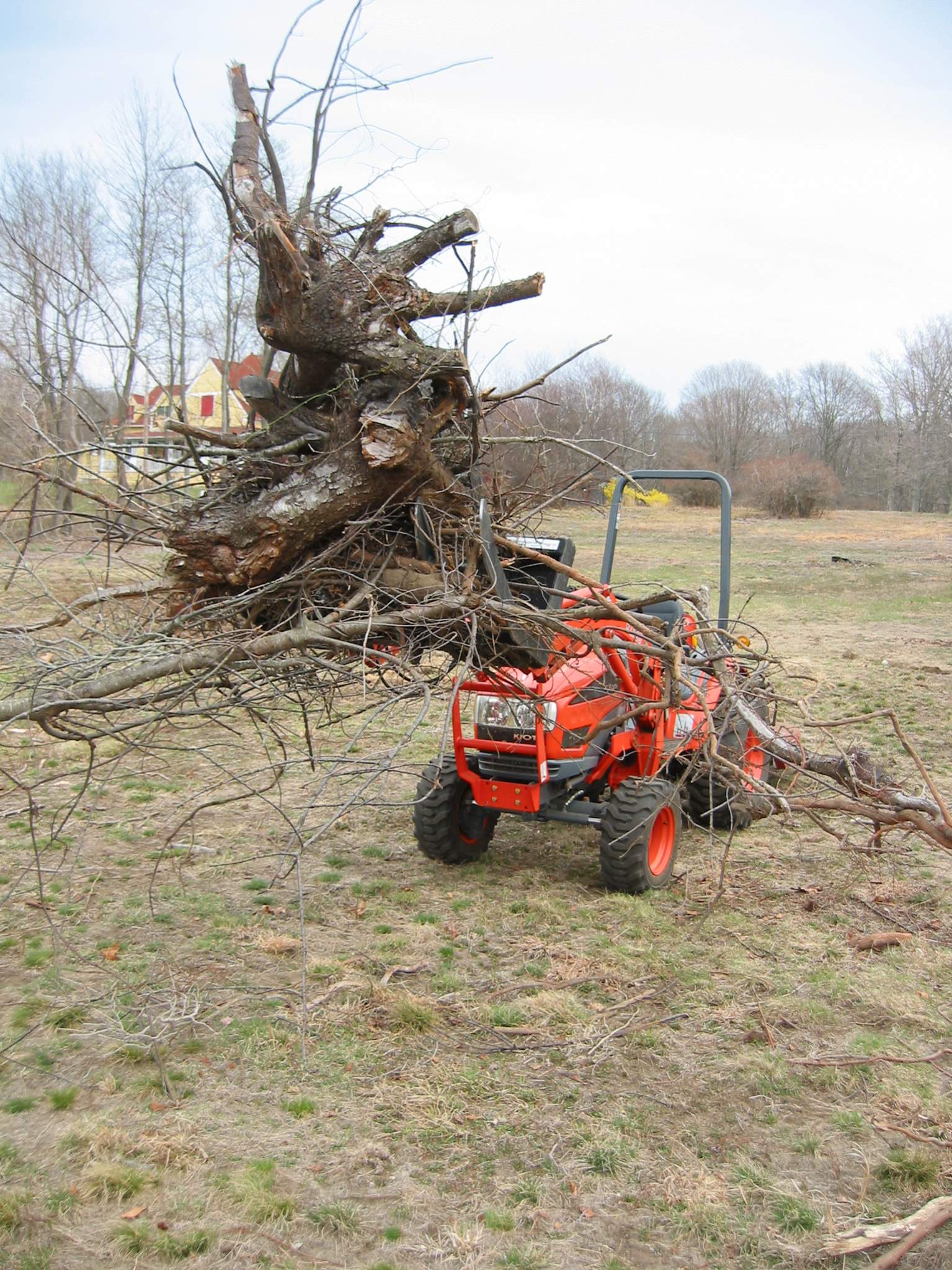

   / Linear Actuator for ct120 grapple #47
Lift capacity is typically measured at pivot pins and is done to full height. A loader can lift more than its "rated" capacity to less than full height.
Any load that is forward of the pivot pins does lower the net weight capacity. That said, I'm pretty sure that a CT120 could lift a 600lb stump four feet off the ground and move it. My CK20 could easily do that and did so many times. Photos below.
