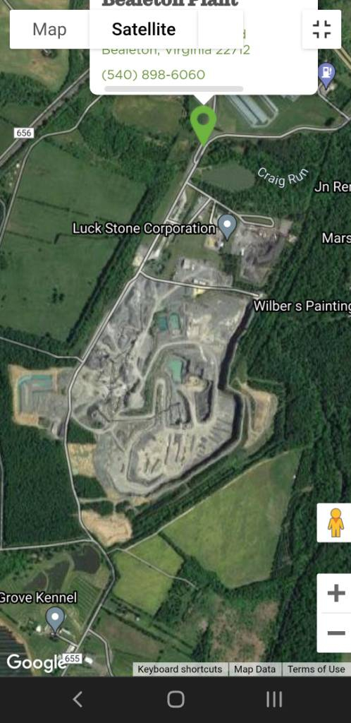

   / Loading issues on Dump Trailer #138
Here's the smaller load area
And the full quarry
