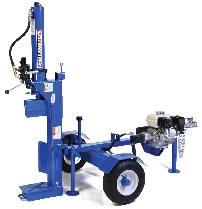

This is what i have had for years.
It's balanced and not tounge heavy.
made by Wallenstein
model wx540
