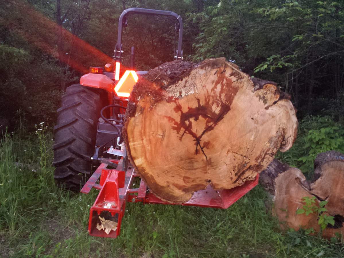

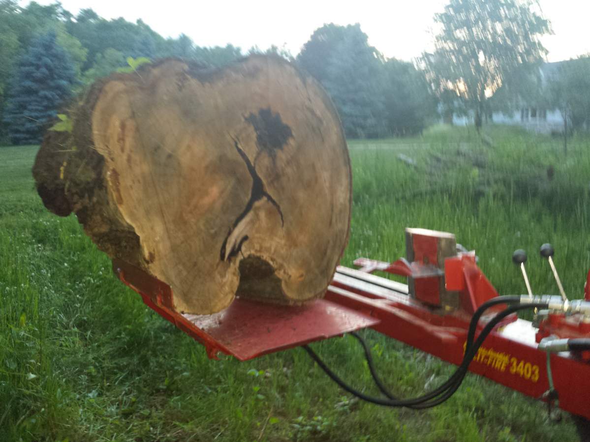

I ordered my splitfire from joe Curtis at flint new holland. I considered ordering a supersplit since I had a speeco kinectic for 6 months before returning it to TSC.
The kinetic was fast but with the small push block you could only half the logs then it took two more splits to 1/4 the log. it took 3 cycles to equal 1 stroke of my 4 way split fire. Each stroke takes between 4.5 and 5.5 seconds for my split fire. Needless to say the split fire works out to be somewhere between 1.75 and 2.5 times faster depending on the wood being split. As long as a I cut to 16" length I can fit two pieces on the spliter so I never have to use a return stroke and split in each direction. If i wanted longer lenght I would get a 28 or 32" model I dont remember all the sizes they build
The other con of the kinetic was that knotty wood had a tendency to ride up the wedge and fly back at me. I wound up with a seriously brushed hand protecting the family jewels. I wore a cup after that day.
Big wood was also pain in the butt. No lift and no option for horizontal spliting made spliting stuff like this a royal pain.

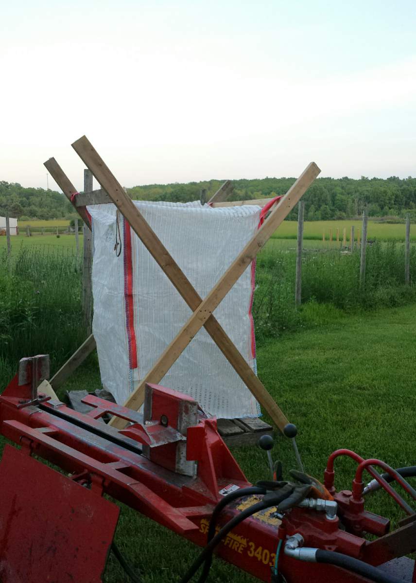

The split-fire with its unique wedge ends does not have a problem with even dry ash flying off when it pops. If it does pop really severely its caught by the craddle side supports. I also like that the wood stays in place instead of being pushed off for two reasons:
1- I dont have to play go fetch for second or third split. This might be okay if you split small stuff that only needs to he split but I found it very annoying with my speeco speed pro.
2- I dont have to play go fetch to move it from the slitter to my stack. The wood goes directly from the splitter to bags.
