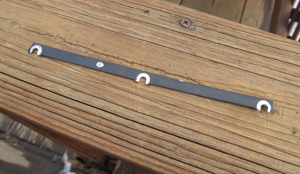

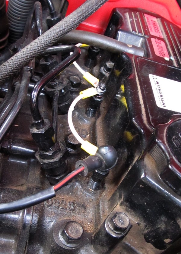

I did a slight modification on my 2216 as it wasn't starting well in colder weather. The strip that connected the glow plugs is a light weight aluminum strip and I had found the nuts holding it in place were not snugged up particularly tight. The engine sounded like it was only catching on one cylinder when it was starting and then the others finally would catch and smooth out. Not sure if the aluminum strip wasn't making a good connection and figured if I was going to mess with it, I'd replace it with copper jumpers. Aluminum was probably OK, just feel better with copper :) The engine does sound better now on start and sounds like all cylinders are catching right away.
The hose heater is cheap enough, I may add one at some point in time.
