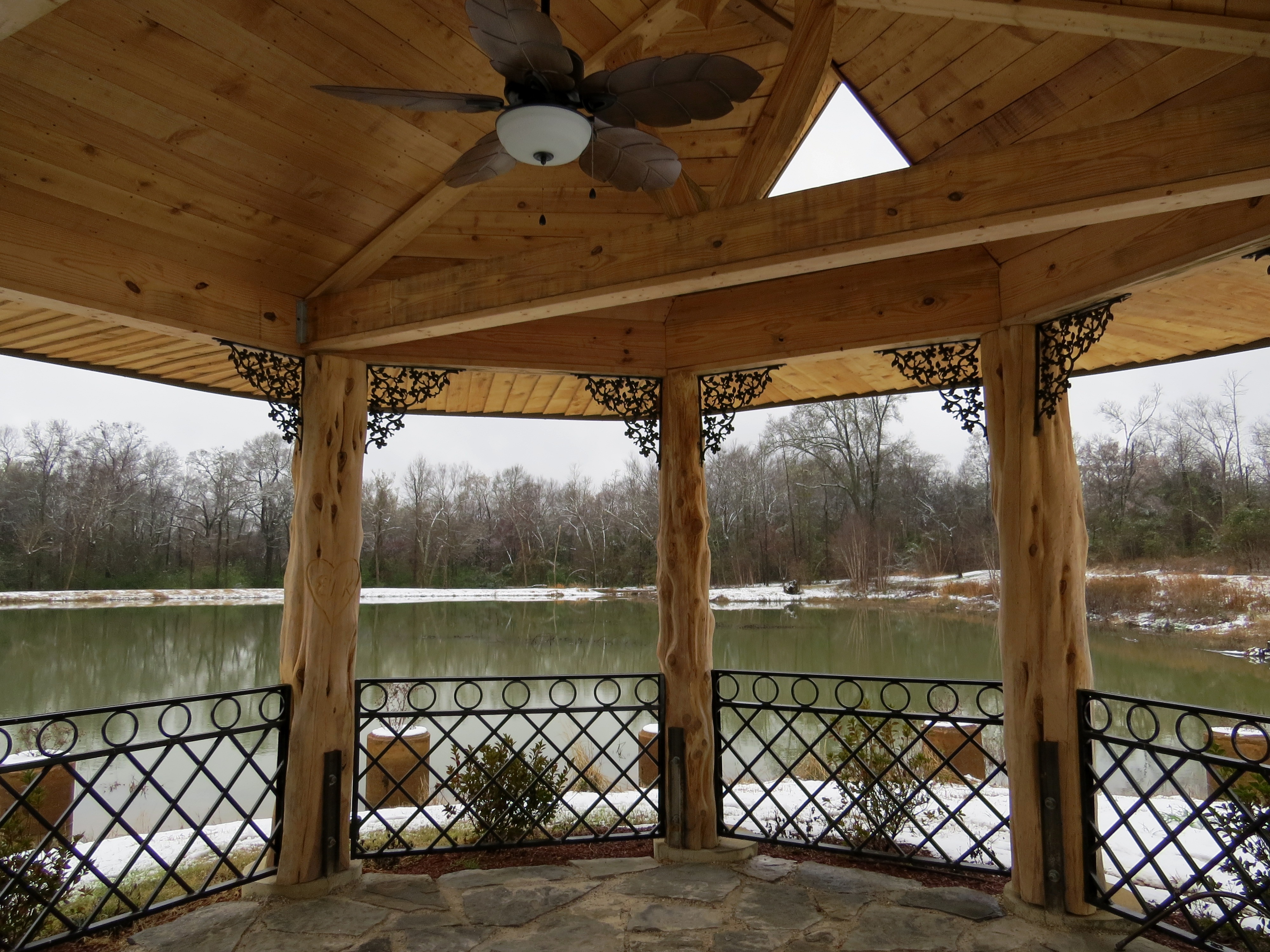

Anyways, has anyone made up some of their own panels for under the rail? I made a landing which is basically 11 feet long with a 5 step staircase on both ends- so ~ 20 or so feet long with a continuous rail. Tiled and turned out just fine. I essentially have to make up 3) 43" wide panels and 4) 31" panels which is 2 for each stair case. With weather on my butt, it is finished and installed sans these panels, and what the heck- let it meet code. As it was finished with square floor tiles , I was just going to do a 3 or 4 inch grid or possibly the stainless cable route. It doesn't seem to pass muster w/ the misses. I think I've seen every Google image for inspiration, but I'm missing something here. It would be a great time to have a Plasmacam, but I don't. A cutter , yes. One of the better metal stores by me I know has leafs and such, but do I take rod , bend it, beat it and tack leaves on the end of tig rod? Or cut something out of some sheet? Looking for something at least repeatable, somewhat easy here and currently fishing for the magical solution....

Here is a railing that I built for my gazebo. I bought the circles and the top of the railing from King Architectural metals. I designed it to strengthen the posts. In my opinion, the diagonal angles lock the railing together, making it structural.

Really neat railing Eddie. How are the railings mounted to the un-even surfaces of the posts? What is the finish on the railings?

That is an ABSOLUTELY BEAUTIFUL gazebo !!!

The quickest and easiest way would be to make straight picket panels, they can be dressed up with collars and wine baskets, or you could also weld some leaf filigrees on there as well. It wouldn't look quite as natural as the ones made with hand bent .250" rod in random patterns to anchor foliage to, but the picket panels can be knocked out in a day vs. the better part of a week for the artsy ones.
If you do go with pickets, start in the middle and work out; I'd always use spacers to get a 3.875" gap as we were told that the code inspector used a 4" plastic ball to check spacing. Cut the stair rail pickets at the angle of the slope, it takes a bit longer but the fit up is much better. If it's going to be powder coated, drill vent holes at the bottom so the pressure won't push oil out of a pinhole and mar the finish, and if it's going outside they will act as drains, because water will get inside here in the NW.
Thanks,
Joe
Thank you.
I use a 4.5 inch grinder with a flapper disk to cut out a flat section of the logs with a wood chisel and then check it with a level. Each panel was built to the size of the opening, so they are all just a little different in size. Between the grinder and the chisel, I can get it pretty close. Then I use 3 Ledger Lock structural lab bolts to attach it to each side. I think they are in the 8 inch range, but I could be off a little on that. I know they are longer then 5 inches, but forget exactly how long.
