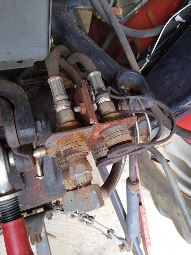

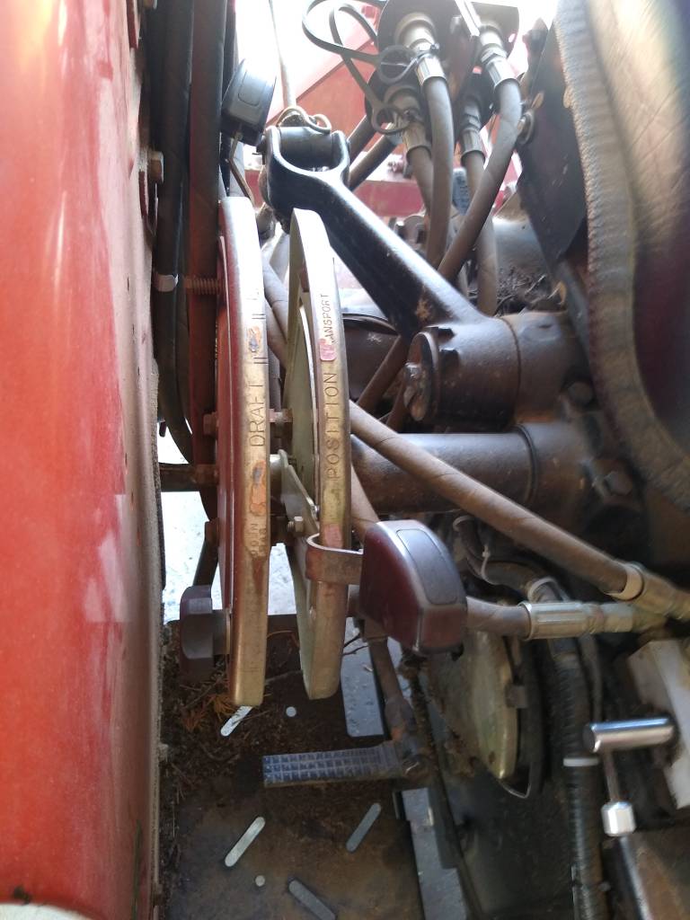

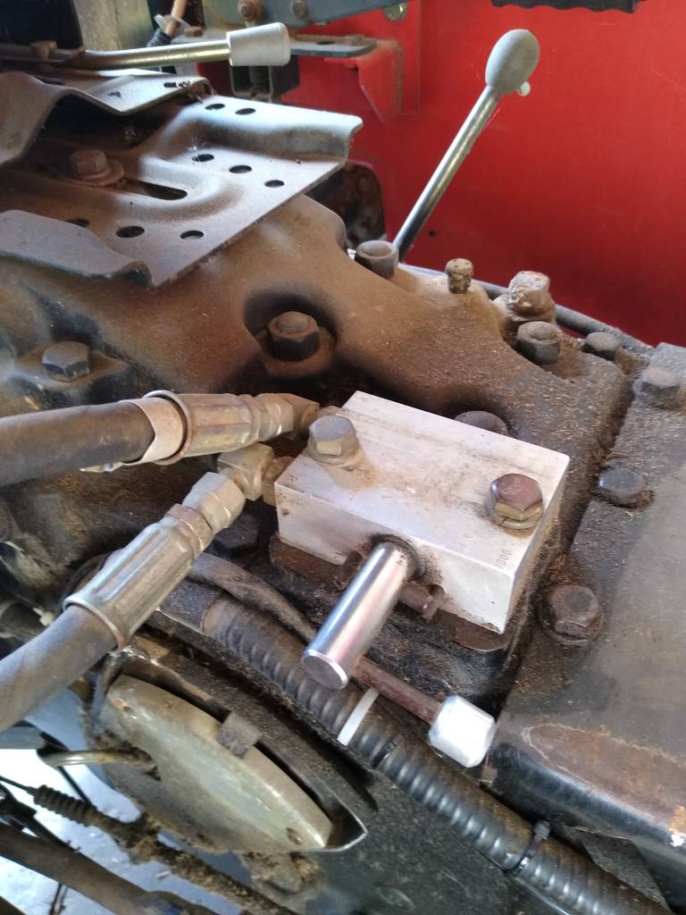

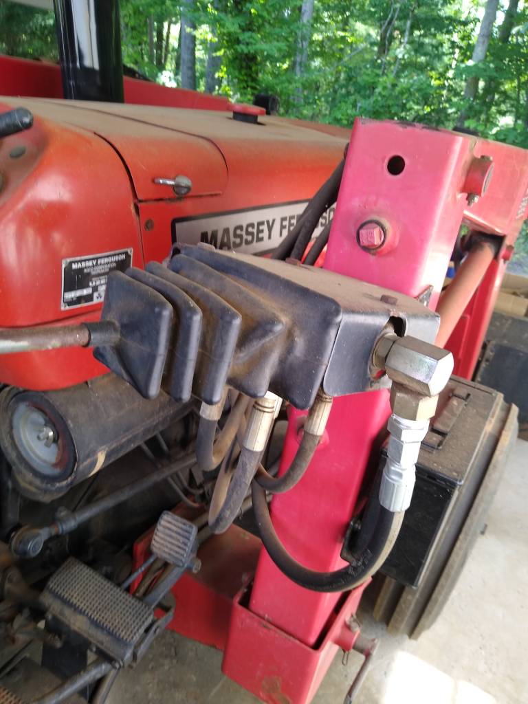

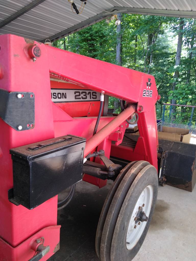

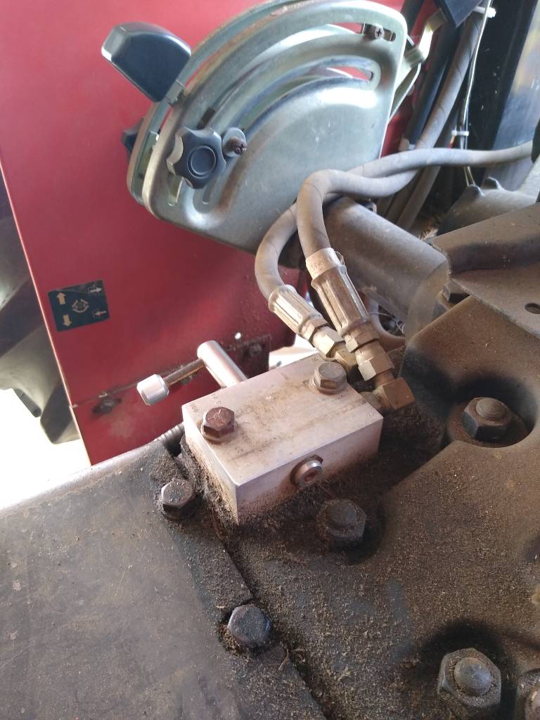

I just went and took some pictures. IMG_20200621_141558503.jpgIMG_20200621_141421753.jpgIMG_20200621_141525355.jpgIMG_20200621_141442522.jpgIMG_20200621_141721995.jpg
   / MF 231S FEL external hydraulic problem #13
Those two lines go into the remote valve block and two lines come out of the remote to the joystick control.

I am still having issue with splines on coupling stripping. I was wondering could I run auxiliary remote from top of 3 pt lift on tractor to operate FEL. I tried to post video to show more details. It would not let me upload but I hope pictures help. I also drill hole in coupling and pump shaft for bolt to help but it is breaking grade A bolts. Could the old hydraulic lines have anything to do with it also? Help plz
