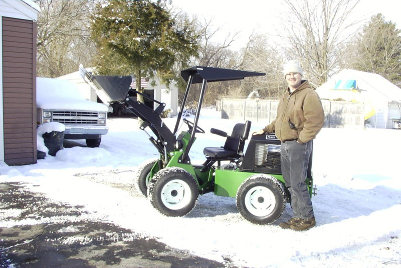

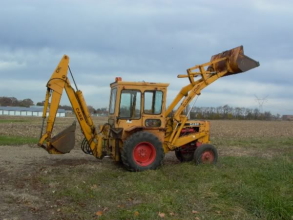

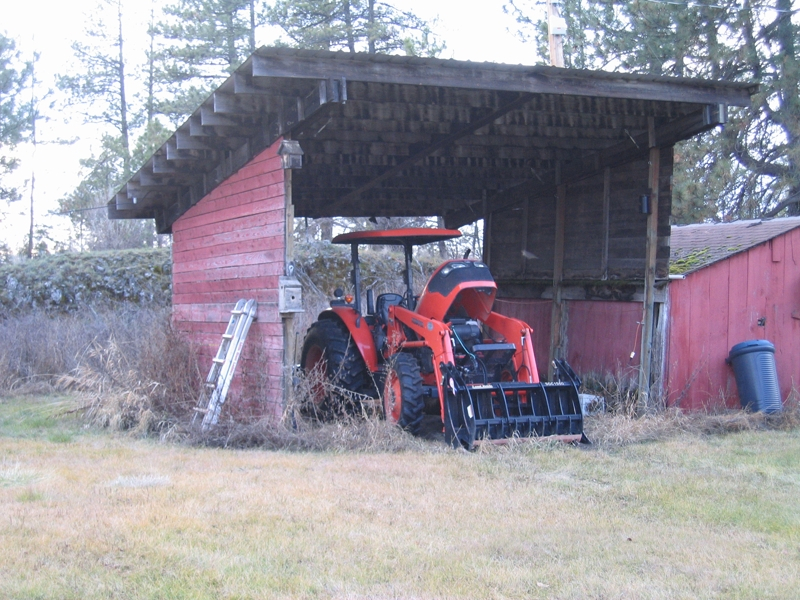

The only thing here that has one is MOOSE, and its always in the way. ---just something to get used to. One of my 580's has the cab rated as rops and its a REAL pisser to get in and out of!
