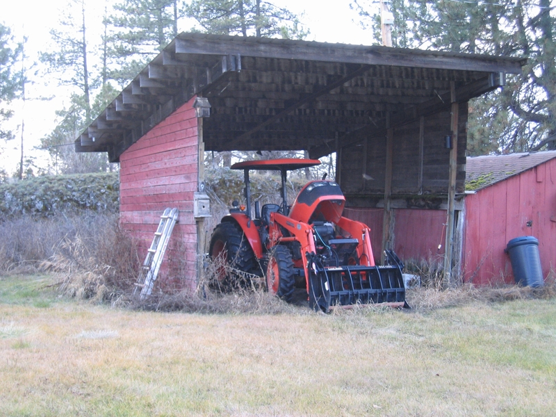

I came within a hairs breath of "customizing" one of my carport stalls headboard. Stopped about six inches short of contact. Easy solution for me. Move tractor over to my really tall carport.
That’s a more appropriate storage area for a tractor. Garages are for cars and Christmas decorations.

When I build my shed, I put a rolling door on and 9' height. No need to fold.
