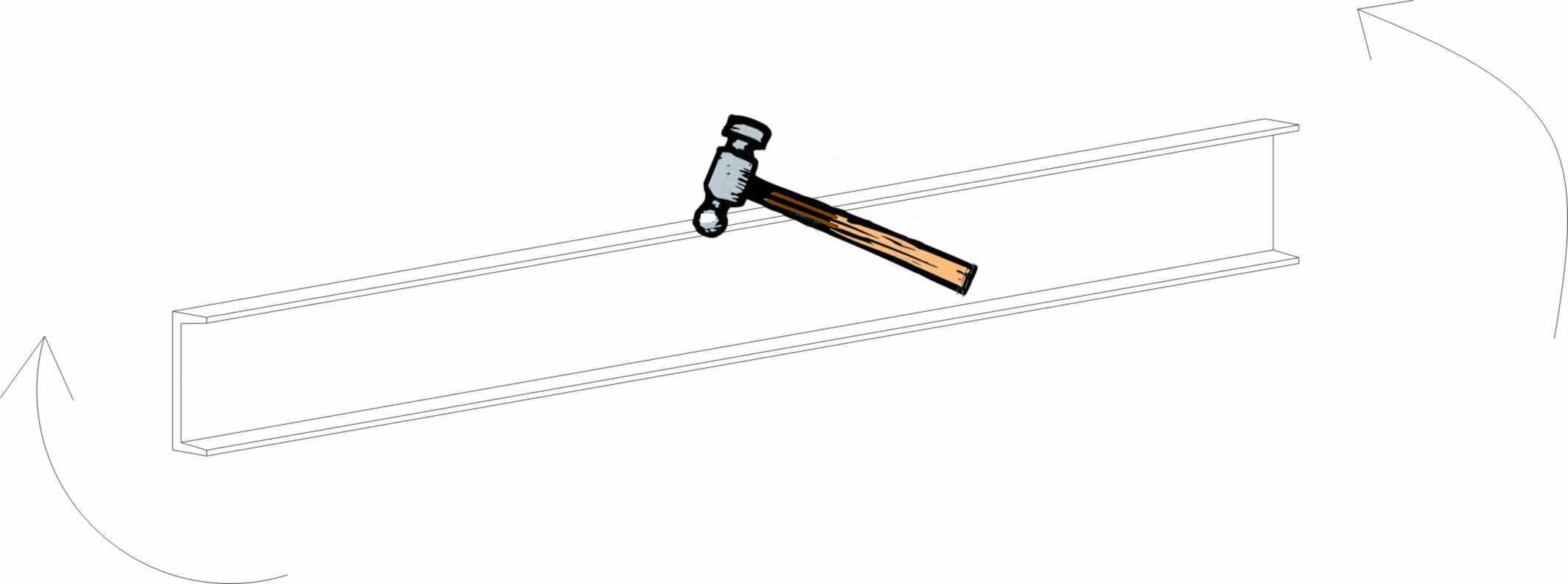

You can do the same thing with C-Channel. Take a sledge hammer and place it under one of the flanges of the C-Channel, (used as a dolly). Hit the top of the flange with a ball peen hammer.
