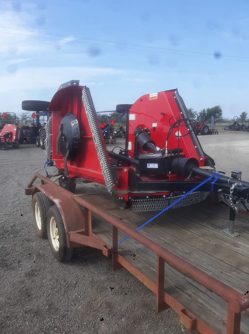

I thought about repairing it, but what I really wanted was a bigger mower. I didn't want to go farther into debt, but with inflation being what it is, the time do do it is now. My dealer had a 12 foot Titan medium duty batwing in stock for $12,899. With $3,000 down, I could finance it for $185 a month.
Saturday morning I drove to his yard and they loaded it on my trailer, and hauled it home.
291494060_10228300584122436_1508093882039791749_n.jpg 291383267_5572580946098834_346864872960901458_n.jpg
Hooking it up was pretty simple. It took a few tries to get the spacers figured out to get the cut where I wanted it, but that was easy enough. Adjusting my mirrors has been the hardest thing to get right!!! It only has one hose, and I got lucky on my first try. The hydraulics raises the wings and lowers the tires. When I want them down, I just release the pressure and it lowers down to cutting height.

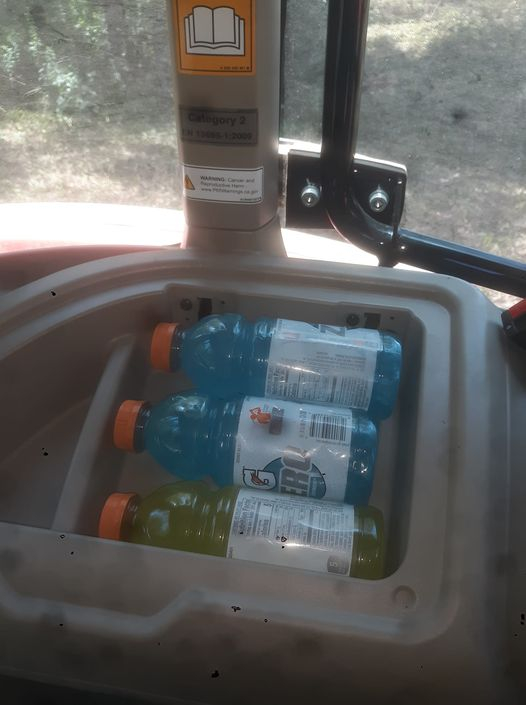

One of the odd things about the cab is a storage compartment that isn't really big enough to store anything. I removed the lid to it and now I have a lot more space to put stuff. I like it better this way.

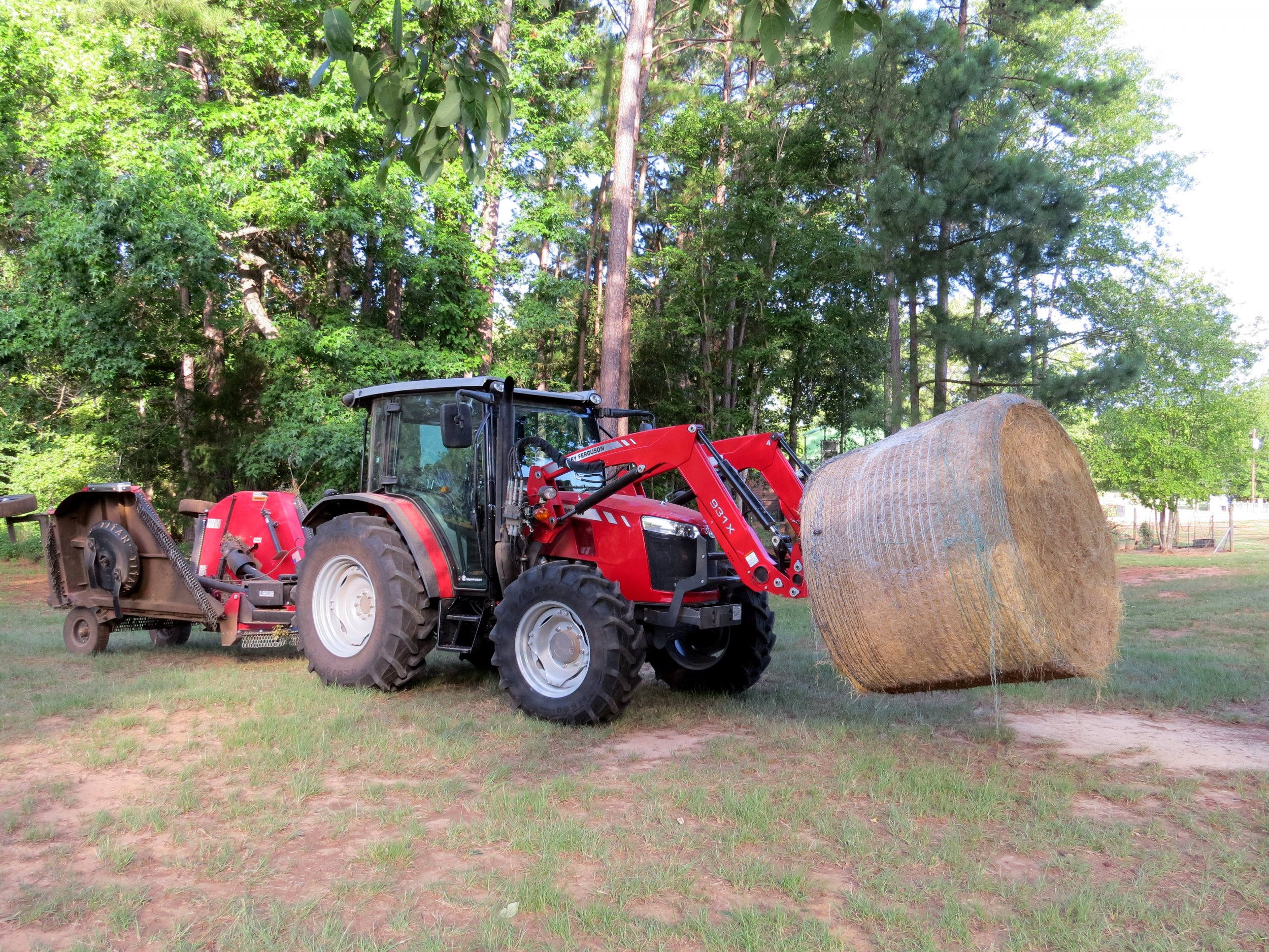

My dealer , PR Equipment, is having a photo contest for a goody basket, so I entered this picture. I'll probably enter a bunch of pictures since I enjoy taking them of my tractor.
The bales are 4 foot by 6 foot. They are really big bales, and the loader handles them easily. This is the 931X loader, which is their entry level model. For more money, I could have bought a loader with self leveling and higher capacity, but I didn't want to spend any more money, and in my opinion, this loader is excellent!!!
I'm also very impressed with the quick attach system. It's much nicer then what I put on my backhoe, and A LOT nicer then anything I've rented on a skid steer. Thicker, more solid feeling, and very smooth. I didn't know they made better graders of quick attach systems until now!!!
Power is still amazing. 70hp is a massive jump from my 37hp open station tractor. We had a big rain recently and everything started growing again. It was less then a foot tall, but pretty thick in areas, so I decided to mow around my big pond. Before, I broke it down into three areas and my goal would be to get one of those areas mowed at a time. This would take me three days with a few hours of mowing at a time. The heat was the worse part of mowing, but it was also slow going with a 6 foot cutter and 37hp. Saturday, I mowed all three areas in about 2 hours comfortably in the AC. This has proven to be such a game changer for me and what I can get done in a day!!!

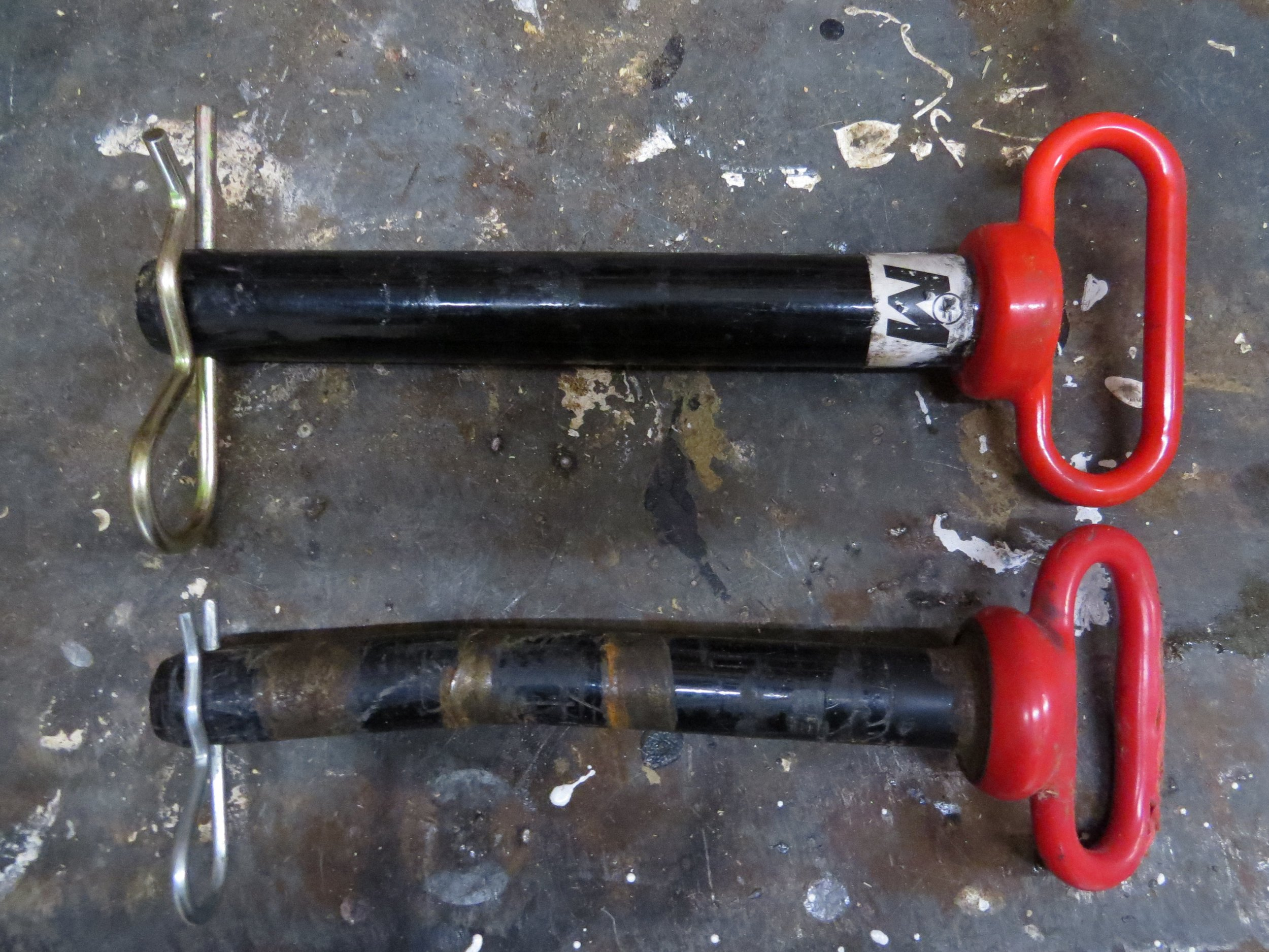

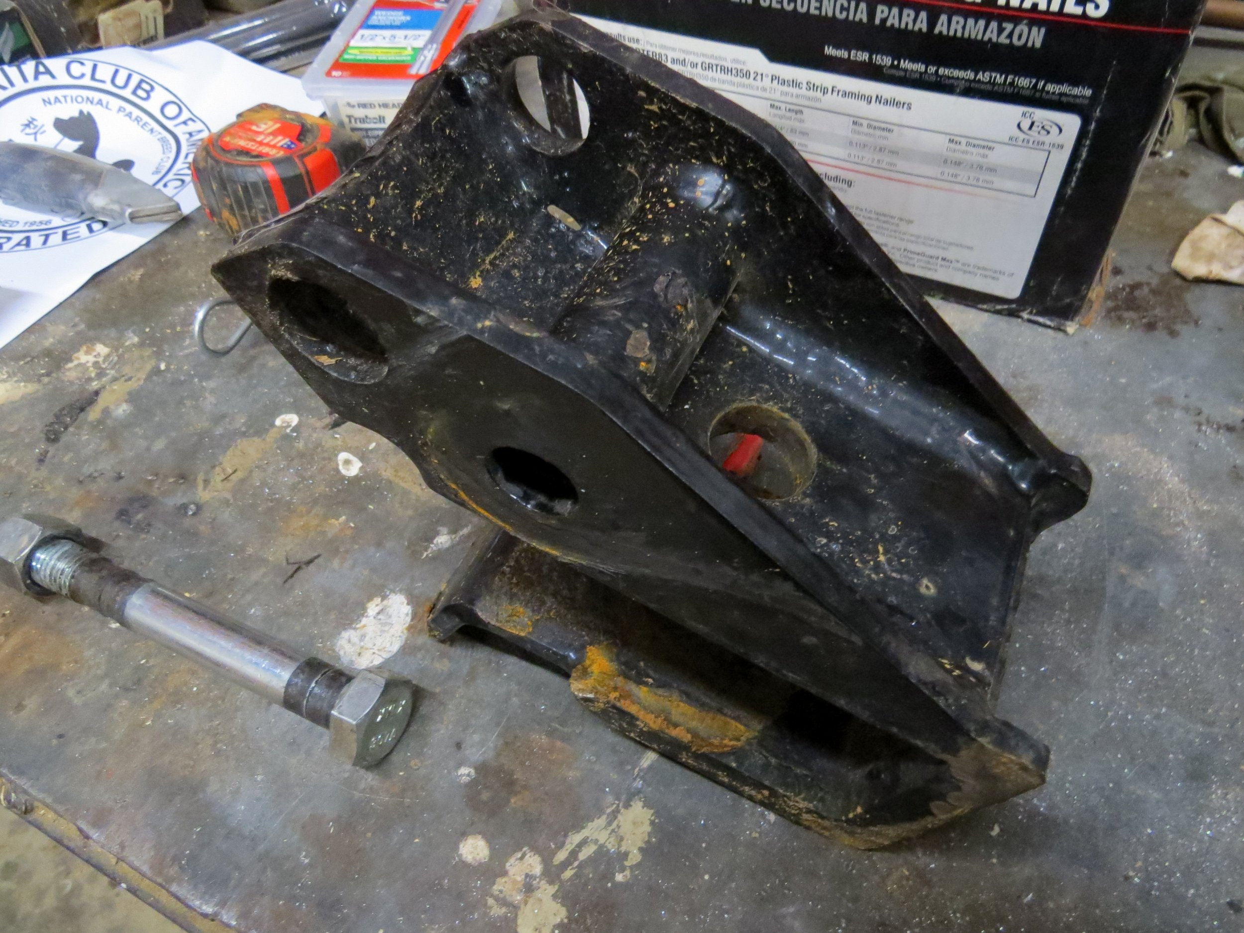

I decided to take off the mower for the first time since buying it. I was surprised that the hitch pin was bent so badly after such a short amount of time. Something like 30 hours, with about a quarter of that just being towed around while I move hay bales or a load of dirt.

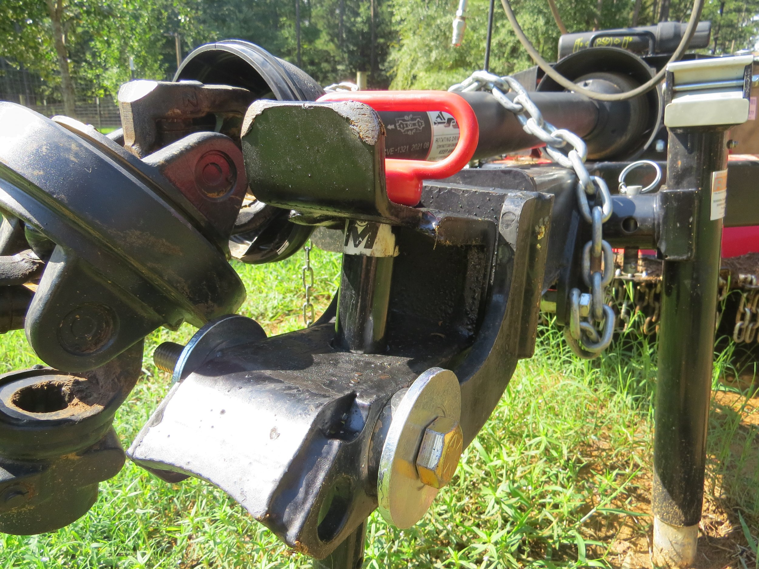

The hole for the hitch on the tractor is 1 1/4 inches. The hole for the hitch on the mower is 1 inch. My dealer gave me a 1 inch pin when I bought the mower, so that's what I've been using.
I bought a bigger pin and had my local machine shop mill out the hole to fit the bigger pin on the hitch. That was $40 well spent!!!
The hitch is attached with a bolt that I feel was too short. The threaded part was wearing away, so I bought a Grade 8 bolt that was a lot longer. I want the smooth shaft of the bolt to be where the metal touches, not the threads of the bolt. I also added some washers to it, but I don't really know why.

Does your hitch have built in oscillation for left/right tilt.
Most of the time when I've bowed a drawpin was when the hitch was getting twisted left and right.
Crossing sod waterways and ditches at an angle can get quite a bit of ocillation betwen the inplement hitch and the
tractor drawbar. With a tractor tire high or low on one side and the implement being tilted the opposite way.
The less slop in the tractor drawbar hole and the hitch holes the more likely to bind and bend.

The hitch rotates in all directions. I'm sure the reason the pin bent was from getting too close to my trees and hitting them from time to time. With a bigger pin and both holes being the same size, I'm hopeful that the pine wont bend from my poor driving skills.
