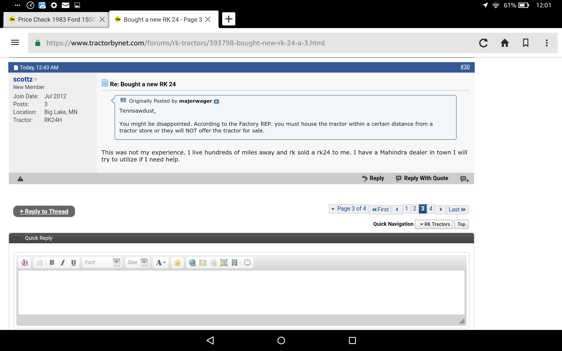

Randy,
Not sure dealer proximity is ALWAYS critical to new tractor sales. There are numerous posts indicating members have traveled substantial distances to either purchase a brand not available locally, OR purchase a brand from a distant dealer offering a substantial purchase savings.
Many members are mechanically saavy, wherein minor issues do not present an impediment. I stated recently that I have purchased nine new tractors and NONE were EVER returned to the dealer for warranty service.
EDIT: see this post from today, screenshot below.
