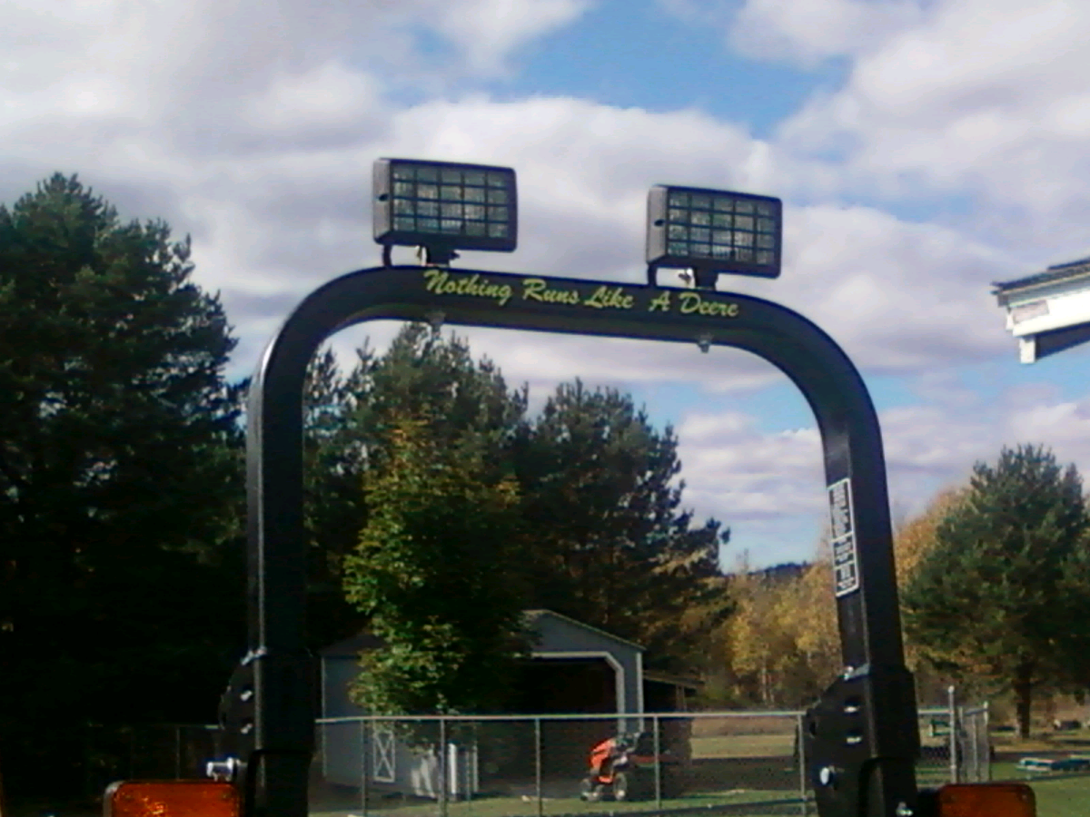

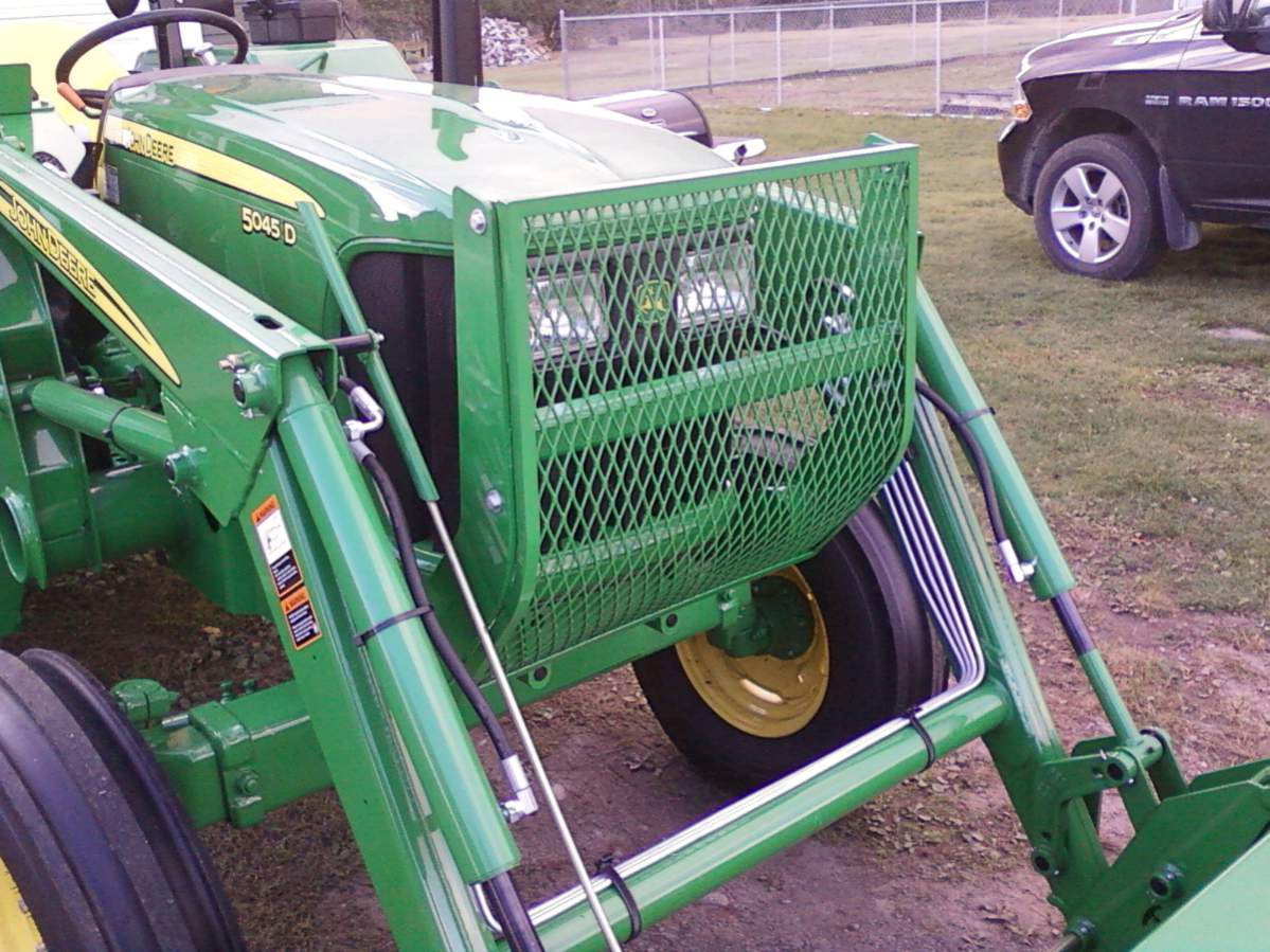

I built the grill guard pictured here for the cost of some 3/4" angle, welding wire, electricity, paint, and my time...the steel grate is some that I picked up at work (quarry). I bet if you asked nicely at a quarry/sand & gravel operation nearby to you, they would give you a piece of it that they have laying around. We use the stuff for everything from pulley/belt guards to catwalks. Every place we have has a scrap pile with a few decent pieces kicking around. I didn't like the coverage of the Deere guard, as it didn't cover the lower grill. Seemed pretty obvious to me that that was where the offending materials would come from 9/10 times. That's what prompted me to make my own...One word of advice, not sure if it's been covered yet so I'm sorry if it has, the grill guard will block the headlights a great deal, and I found it necessary to attach a couple flood lights to the ROPS to light up the night a little. Not sure how the picture of the sleeping kiddo got on there or how to remove it, but enjoy that one anyway...I do;-)
Thanks so much!! Man, you did a great job on that grill guard!! I have a friend who has the materials to make something similar, I just hate to bother him with it. I sure understand what you are saying though about the Deere guard not coming down far enough to protect everything like it should. What I though about doing is getting the Deere guard and then adding a little tray to the bottom by building one that would fit into those 4 bolt holes on the front. That would give a little more protection there and also add a place to store a log chain.
   / Ordered a 5045E #78
Thank you for the compliment!!! I always follow Red Green's motto: ''If the women don't find you handsome, they should at least find you handy.'' From what I could see, the Deere guard only covers to where the hood guard begins to bend past vertical...maybe they have changed since I bought mine, but I doubt it. Wierd that they overlooked it. I would prefer to have the mesh, as it would at least allow some light to get through to the ground if you're working around the front of the tractor, but you could simulate that with a piece of cardboard beforehand to be sure...Good Luck!!!

Great pic of the sleeping kid. They are always at their best when you have them worn out and taking a nap so you can rest too.
I've had that problem of the grill fussing the lights. I just took mine off for the winter snow plowing season and haven't put it back on. With the loader bucket on and held low it doesn't amount to much anyway as you should refrain from running into brush piles far enough for the butts to get to the grill.
