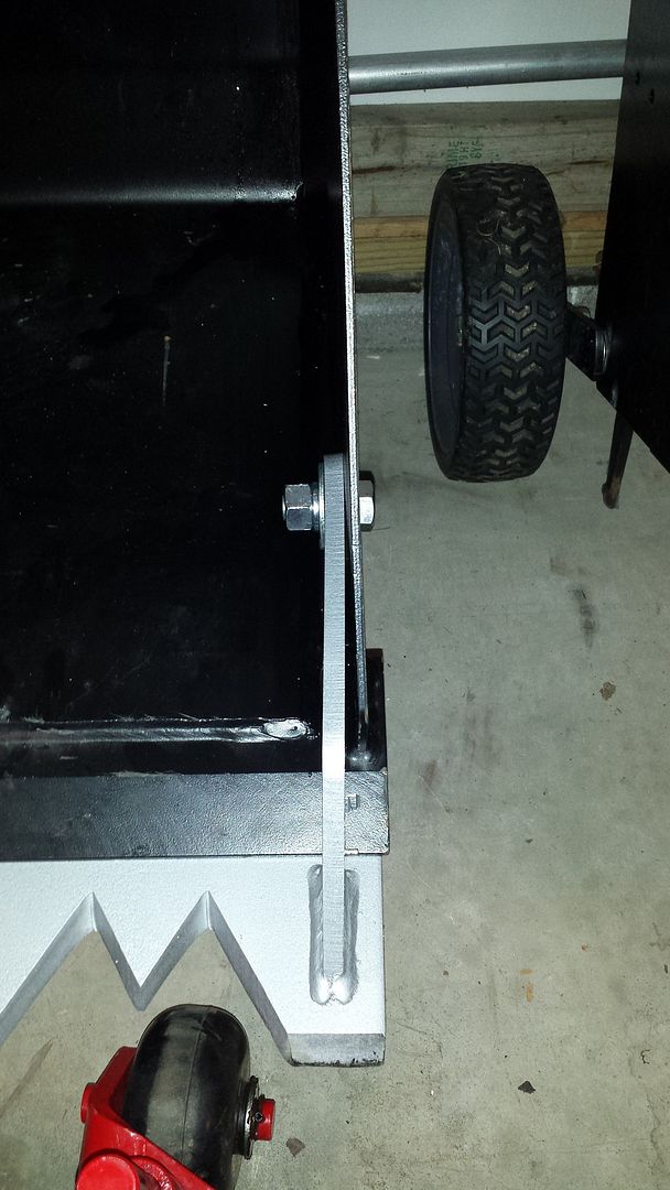

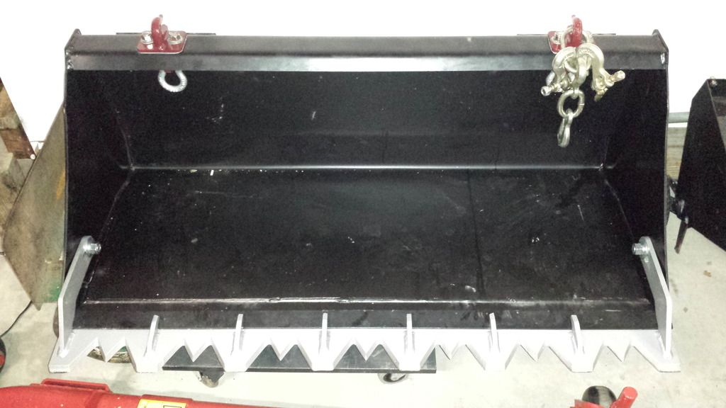

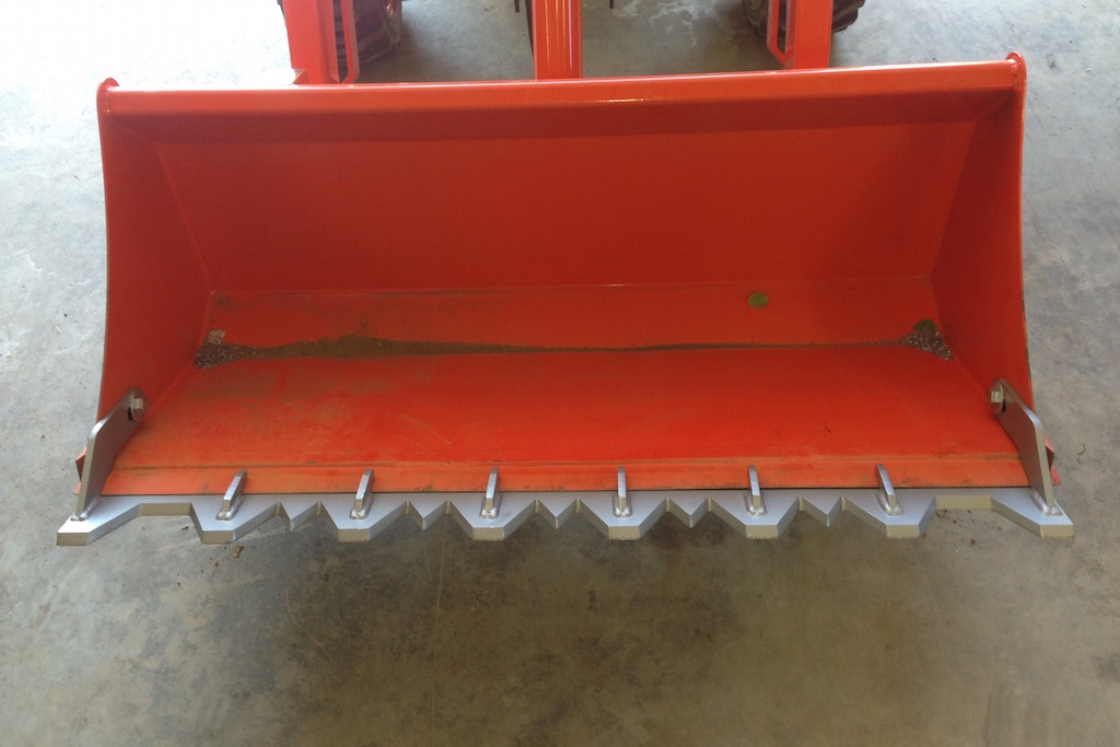

Here is mine installed along with Ken's Bolt On Grab Hooks
BXPanded Piranha Toothbar - Bucket ID 47 3/4" - Actual bar 47 1/4"
Fit and Finish... I did not use it yet but plan on using it this week.

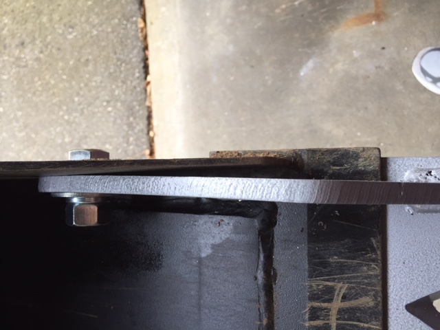

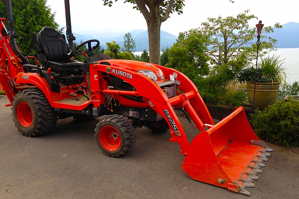

Hey guys, sorry for the delay in my own pics. I did get it mounted up, with a similar fit as shown above. Looks like they cute he tooth bar a bit short and bend/angle the mounts to meet the bucket width. This obviously allows some variation or small errors on the measuring side.

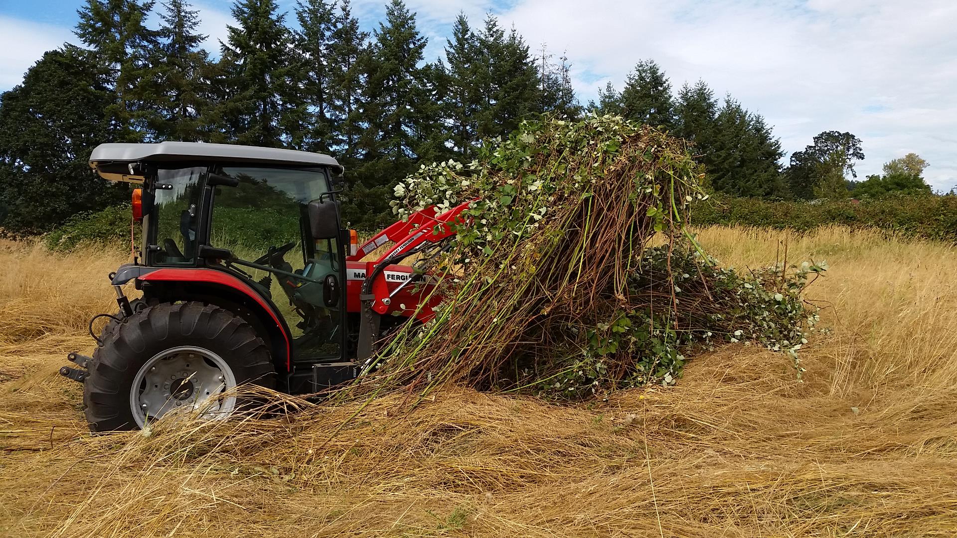

I have a 72" Piranha on my DL135 loader. Running it just above dirt does quite a number on acres of 10' tall Himalayan blackberries. A lot of the roots come out, but by no means is it all taken care of with just the tooth bar, as can be seen in the photos.

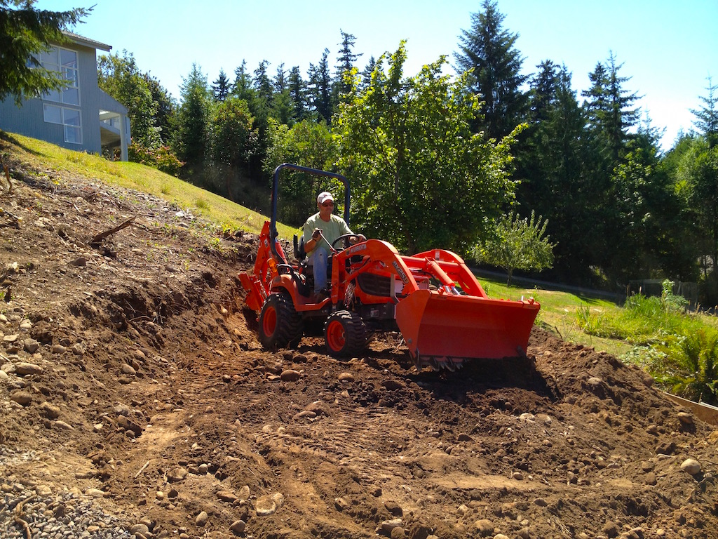

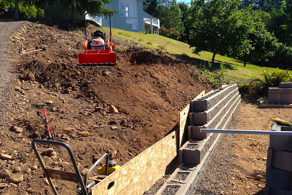

PTB is the best thing I added to my BX. Makes the bucket a real digger... way above its weight class! I could not have done the jobs I did without one. Just give them your inside dimension net. Don't subtract anything. Otherwise you will have a gap and may need a washer or two and an unnecessary sloppy gap. These are high quality and will take all the abuse you can give them and still look good.

I bought mine last spring, and they must have customized for the new bucket, cause I had to go buy longer bolts as the one that was "supposed" to fit is a little short and the bolts were nowhere near long enough.
