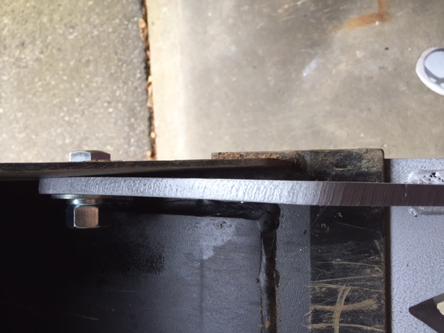

Hey guys, sorry for the delay in my own pics. I did get it mounted up, with a similar fit as shown above. Looks like they cute he tooth bar a bit short and bend/angle the mounts to meet the bucket width. This obviously allows some variation or small errors on the measuring side.

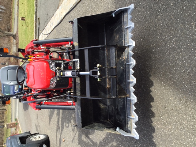

Fiziks, in the one photo you have an accessory adfed to the front that is a hydraulic double finger ??? Or the top half of a grapple ???? Or ????

Are you referring to my grapple thumb?

Hey fiziks who did the install?
Fixiks,
I see the website mentions there are 4 sizes of this grapple thumb:
1. Which size did you get and what determined that size ?
2. How much weight is the thumb plus any reinforcement that was needed for it?
3. What is involved in detaching it and reattaching the grapple thumb? Is there a quick connect/ disconnect or is it bolts and nuts ?
4. The website mentions reinforcement may be needed for lighter buckets . . Did your bucket need reinforcement?
Goffs did the install for me.
Fixiks,
I got the 24" model which hits the bucket edge perfectly. I think I could have gone with the 28" version with the piranha tooth bar installed.
I would guess the thumb plus the reinforcement is 50lbs maybe?
It comes off with 3 pins, one for each side of the lid and one for the cylinder.
I don't know if I *needed* reinforcement, but I had a piece of 3/8 bar welded to the top. Also had a coupe of hooks welded up there as well.
