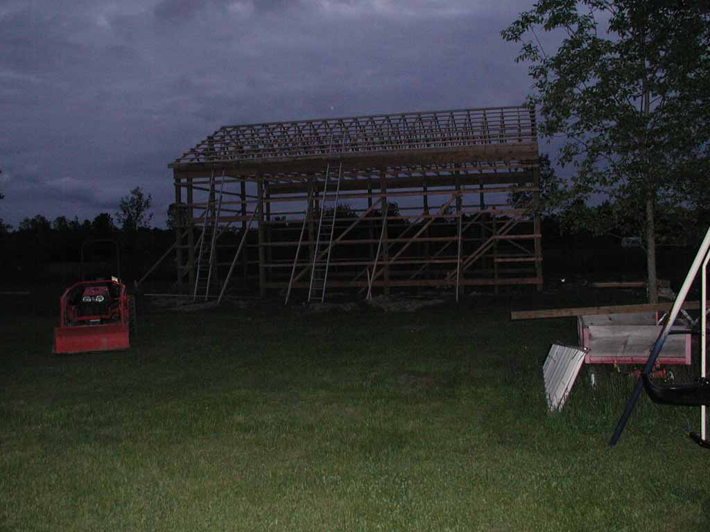

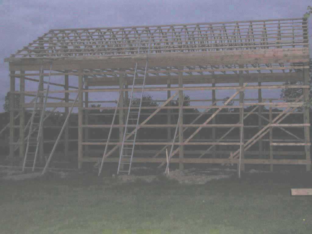

Worked on the pole barn a little today. Did not get a lot done but finished setting the purlings on 1 side along with fascia board. Took a few pictures but it was late so they did not come out the well. Posting then anyway.

Here you go PEMAD, I just used a brighter flash on your pics so we can all see your hard work.
No charge.:rolleyes:
