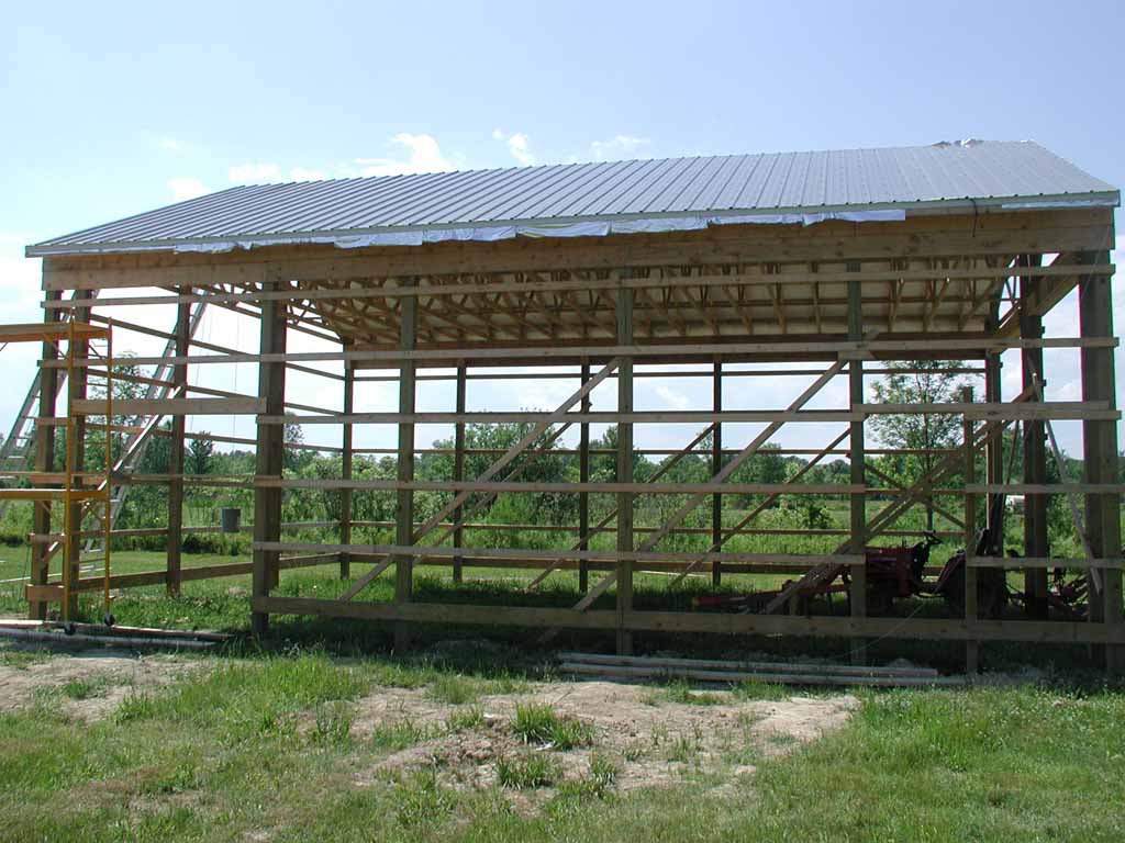

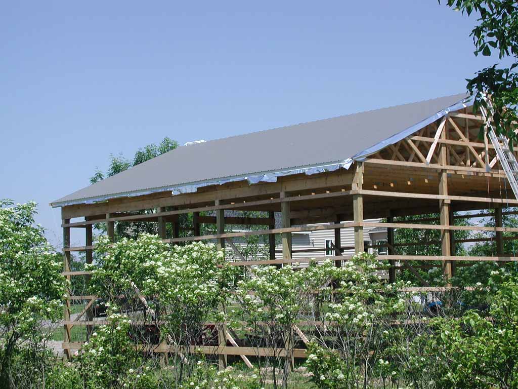

Finished the Roof sheeting yesterday and this morning. Had my brother and a friend over to help and we had a few missed screws on the roof. If they start to leak I will fix them a later time. On to the pictures! Her are a few shoots of the roof set. Hopefully the wind will not be an issue with the roof becasue it is going to be a few weeks for the sides get done!
Still need to put a few screws in on the first 2 sheets and the foam stuff under the sheets as I put them up the other day and did not get to them but should only take a 20 minutes to finish it up.
Enjoy!

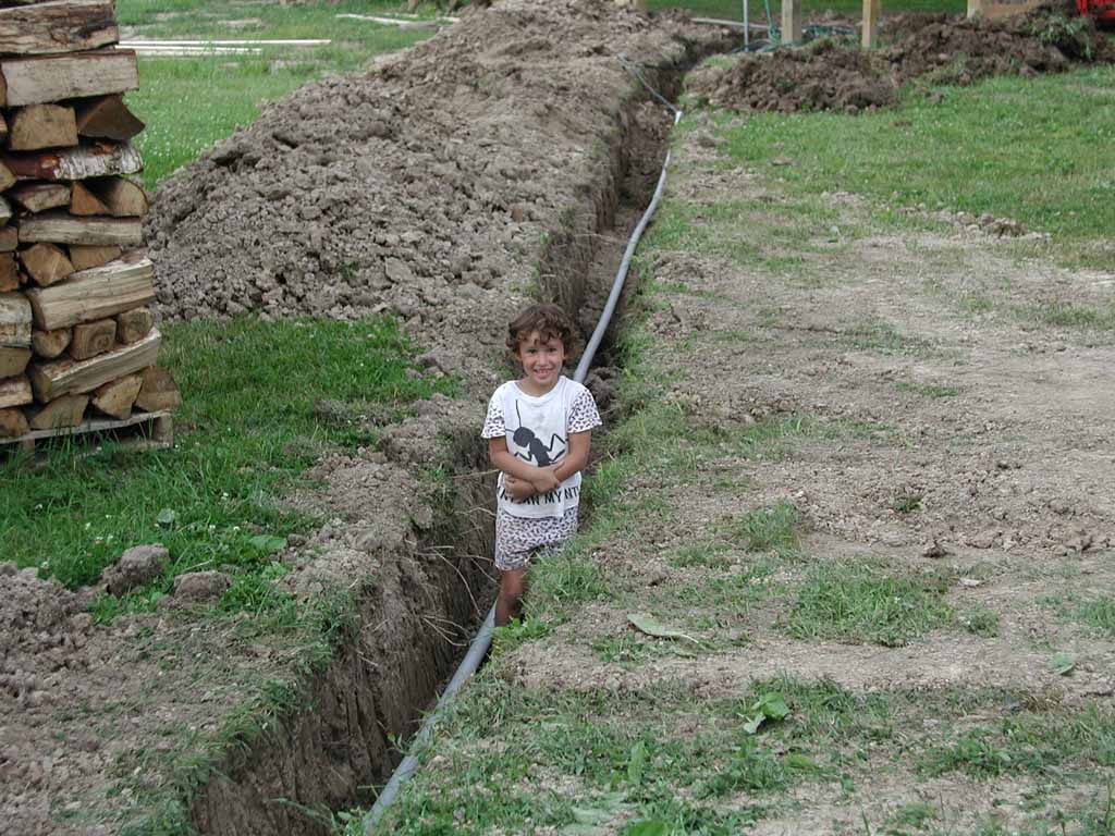

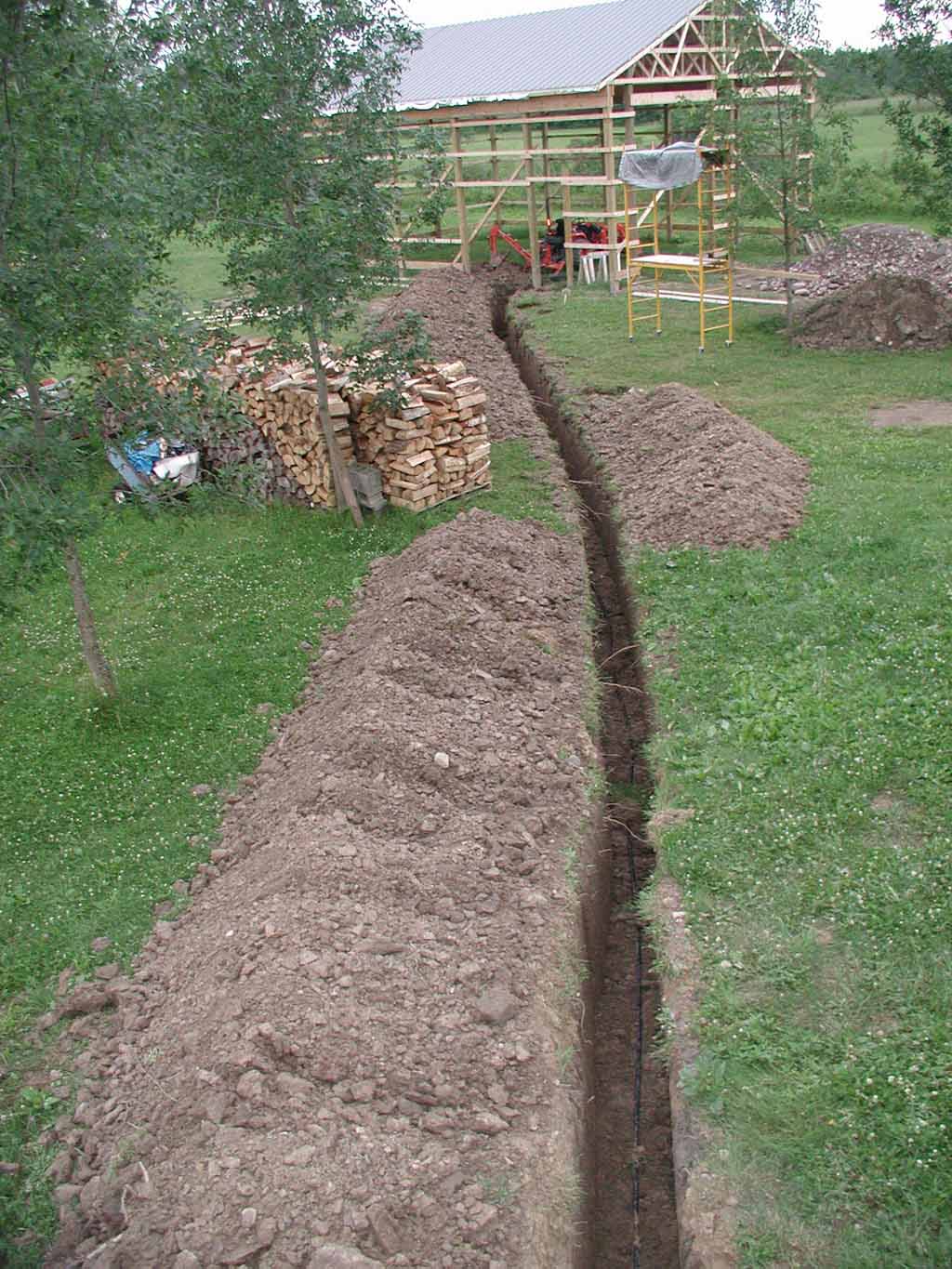

This weekend was dig water line and layout the electric. I have tomorrow and Tuesday off so I will run my cable TV, telephone, and internet line. Hopefully I can get the electrical inspector out tomorrow to look at the trench so I can back fill it. Enjoy the pictures and will post more shortly.

When I built my shop I had to meter it and I had to place my electric 4 ft deep from the transformer to the shop ... about 110 ft. Nice looking shop you are building! I like it!
Leo
