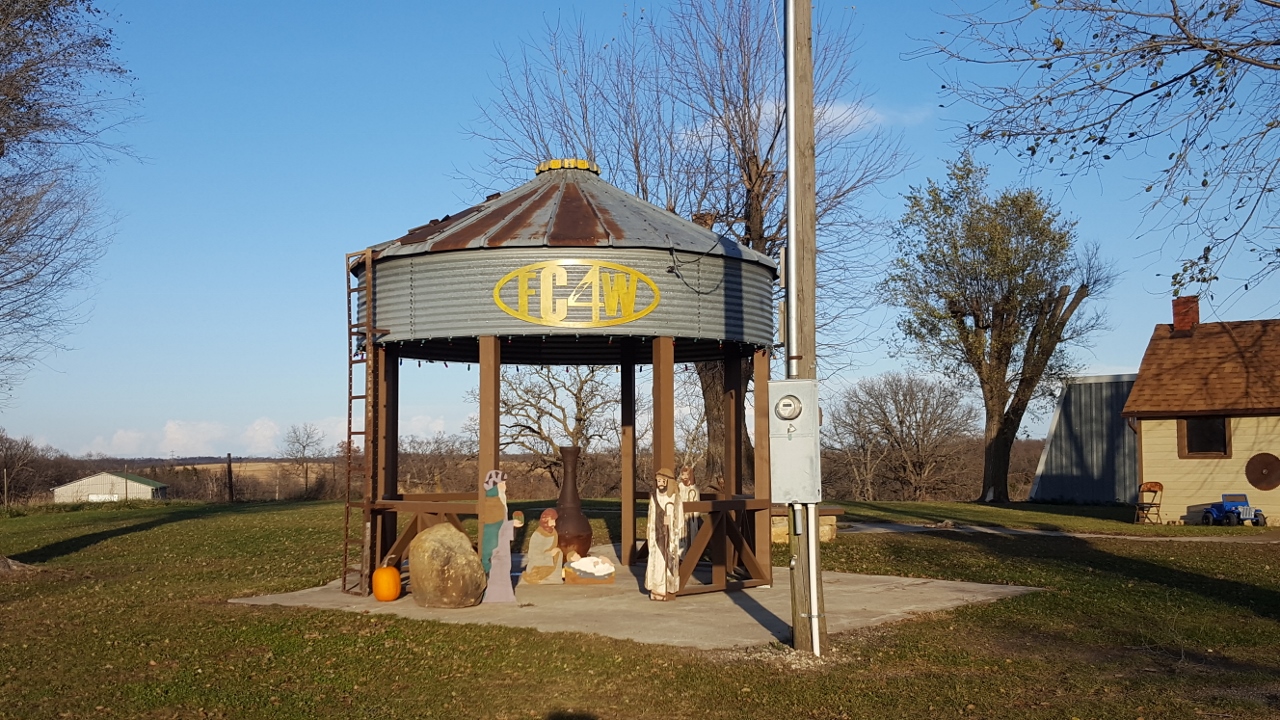

I built this "Binzebo" last Summer. Set it on an existing concrete slab. I used the metal brackets to set the posts on. Required very good bracing in the railing to give it stability. As mentioned before you don't get any structural stability from a post sitting on top of concrete rather than buried in the ground and concrete poured around it.
