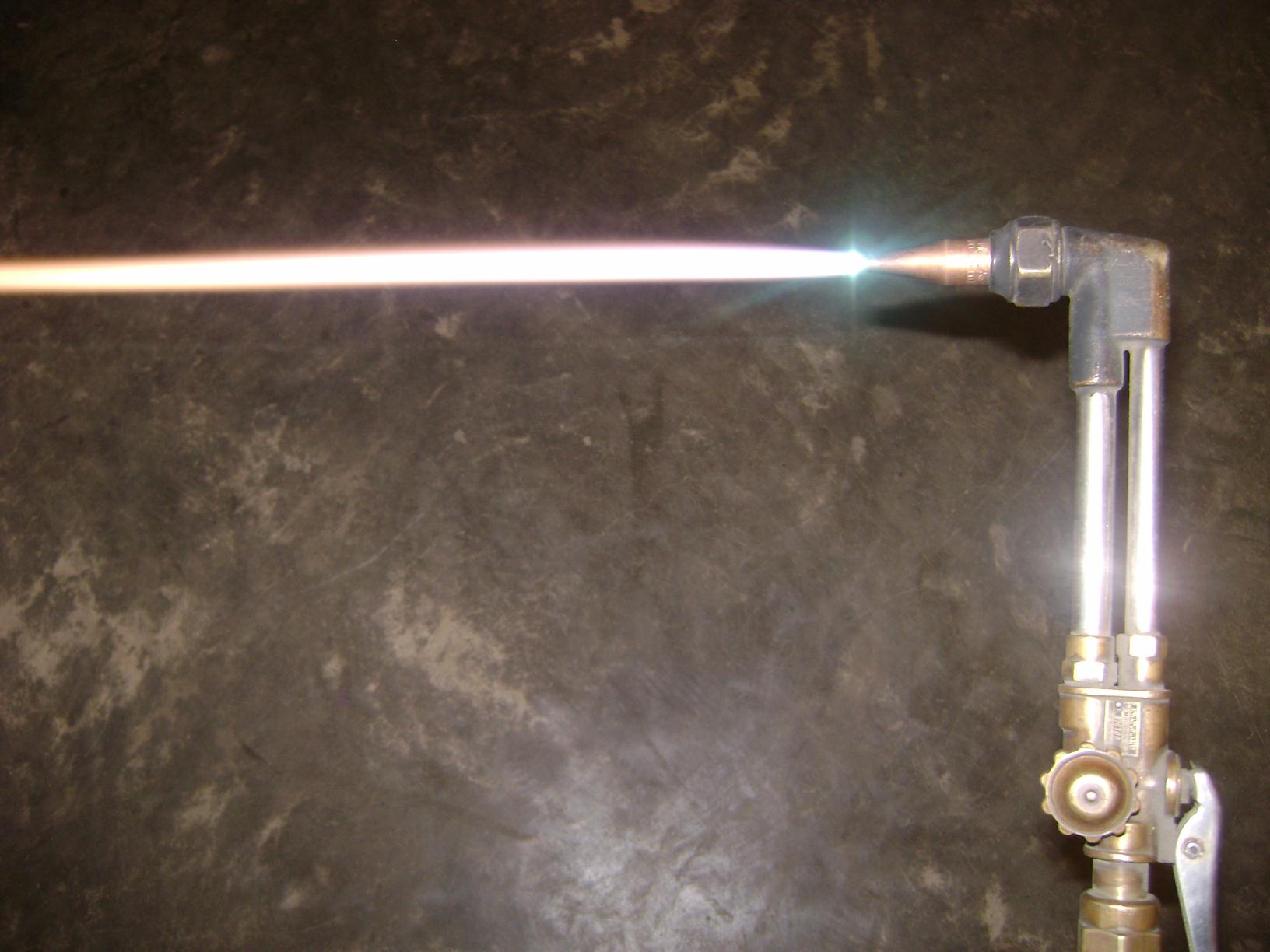

/ Portable Torch Kits? #10
I've had my Victor torch for about 30-years now, still works great! But I don't use it for a hammer, I have a lot of hammers. :laughing:

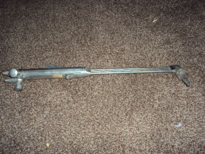

My most recent Smith SC 229 was forty bucks shipped. The poor pictures and label under the barrel in this Ebay pic made it look unattractive. Replaced tip, works great. Lifetime warranty. Beats $266 online.
All good LWS will carry at least generic Victor, Harris, and Smith-style tips. I'd rather buy online since it's often less expensive. If there's one in the torch, having two spare is good minimum practice.

Once I seen the picture of your Smith torch I got to thinking, I can't say I've ever seen a combination Smith torch. So I went to their site, yes they do make a combination torch, but I didn't see a rose bud, is there a rose bud that fits a Smith mixing chamber, or will a Victor rose bud fit?
/ Portable Torch Kits? #19
Nope, None of the brands cross over on parts.
