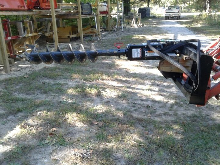

You may want to consider a SSQA auger. Easier to connect, no neck strain, can reverse if you hit something solid, may be tax deducable if starting tree farm.

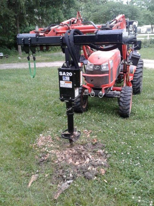

Using planning auger to remove tree stump

I redid my fence in 2021 and opted to get an ssqa hydraulic auger. Night and day difference! Easy to position, a lot of auger bit options, reverse direction, and down pressure make it a very easy and quick operation. They do cost significantly more though.
If you're doing a lot of holes on a regular basis an ssqa hydraulic auger may be worth the investment.
I have been tempted to try the stump head on my Land Pride SA20. Have you used it on larger stumps with any success? If it would chip away at a 2-3' stump I would be interested.
Tell me about your experiences, and price if you don't mind.

Pay attention to the cutting sequence drawing. Small tractor with low oil flow, the auger can screw in and take too large of a bite. Reverse auger 1/2 turn, lift FEL to reduce down pressure and auger more. May have to cycle FEL in and out of float for some stumps.
