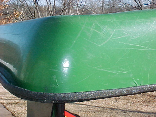

Now, here is picture of the outside of the hood, where the hole was. You can see the paint job on the front of the cowling is not as faded, yet as the rest of the hood. With close inspection you can tell there was a repair, but a casual inspection would never reveal it. I used a fiberglass repair kit from an auto parts store ($15-20).
The white surface scratches are not where the hole was and have happened since the repair was complete.

This past Spring, I bought a Buck Top. It was only a week or two old when I backed into a big branch and cracked the left rear corner. Once again, no picture of the damage, just the repair. The crack went from the gutter up to the top edge of the corner and along the top edge for a few inches.
To the left and right of the repair, down by the guttering, you can see remnant runs of resin (alliteration)/w3tcompact/icons/smile.gif where I got lazy and didn't sand them flush. From ground level you mostly can't see 'em.
Now, I must say, I had never repaired fiberglass before. And, I offer these pictures only to show that even a rank novice can work with fiberglass and get reasonable results. Plastic gloves and some sort of electric sander are very helpful.
So, don't be too afraid of buying a tractor with fiberglass parts. They may be prone to break with abuse, but are not too hard to repair.
Surely, I am not the only clutz out there. Has anyone had the chance to do repair work on the HD plastic tractor parts?
