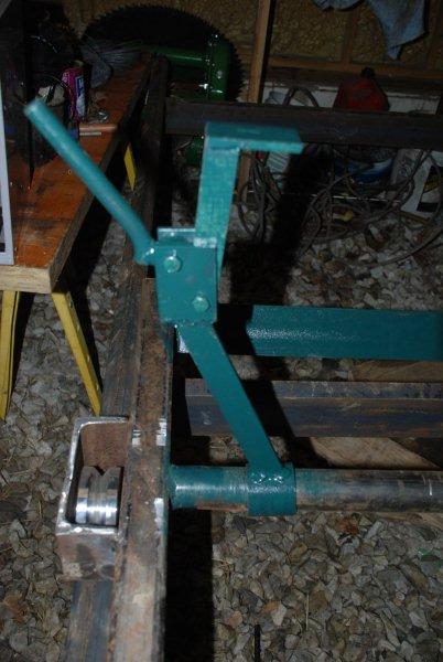

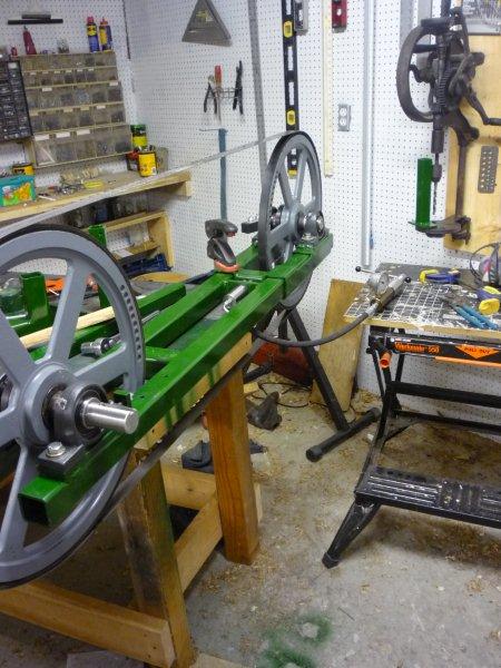

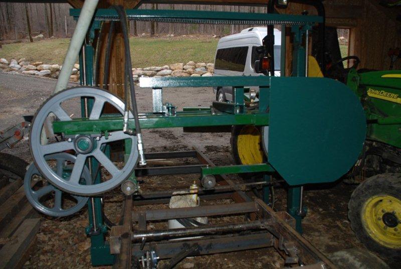

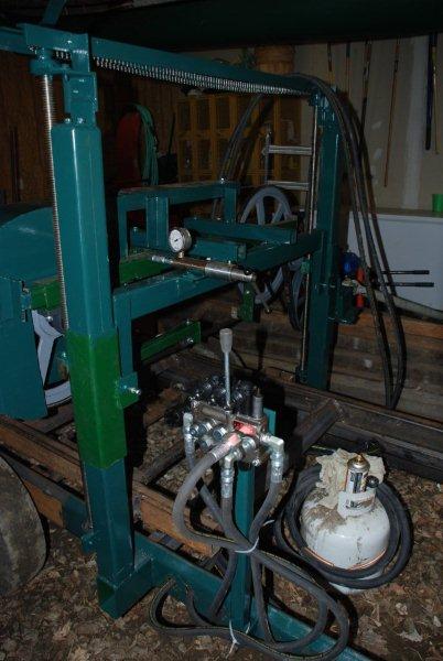

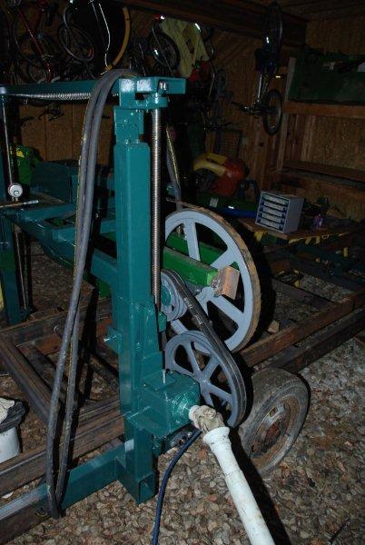

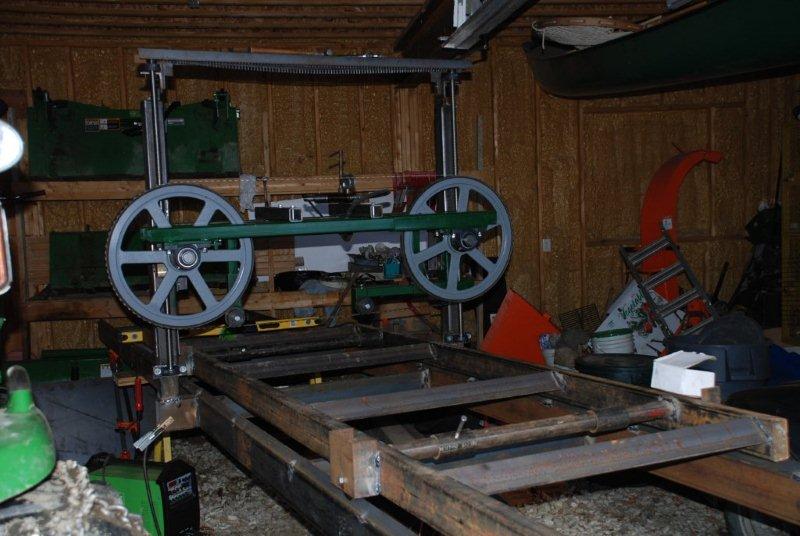

Well, it's been a while. Now the bandmill is reality and tomorrow I intend to start sawing lumber. The saw head design is based on parts available from Linn Lumber. I modified the saw-head carriage design to recieve PTO power and remain stationary. The carriage travels on the rails and is driven by the tractor hydraulics. I would welcome any questions regarding the mill...I have asked many on this forum in the past, and recognize the value of coming back to post real projects. What's left is to finish painting!
Early shot of saw head progress. Band wheels are 21" diameter on 1-7/16" shafts. The yoke at the far end moves with the hydraulic ram to tension the blade.
Overall view - no guards
PTO attachment/gearbox/drive pulleys
Hydraulic controls, rear view - old propane tank will be for blade lubrication. Two extra valves are available for a hydraulic log turner, or hydraulic raise and lower.
Carriage drive wheel and gearing. One side of the carriage is long to enable the wheel to drive a 16' log all the way through the blade.
Log dog.
Guard on one side.

Looks great.
I built a linn 190. My only concern is the beefiness of your carriage. My cross bunks are 2x2x1/4 sq and my carriage wheels only have to support about 400 lbs of sawhead, not a 1500 or 2000 lb log. And if you are flipping a 16 ft 10x10 wet fir cant, it is really heavy and slams down pretty hard. Looks like it will cut like crazy with the grunt of that PTO setup. I have an 18 horse briggs and can bog it pretty easy. We want lots of video too!!

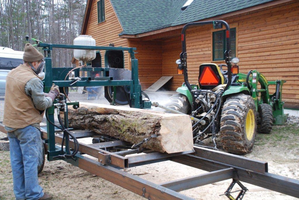

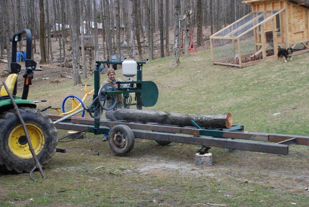

The castors are rated at 2000 lb. each, so they should be OK. Today I milled a 24" diameter x 10' maple log. That has to weigh around 2000 lbs as my loader could just lift it. I was suprised that I was able to flip the log with a peavy after a few cuts; I do not yet have a boat winch that I intend to use on a mast to flip the really big ones.
Overall, I was very pleased with the cutting performance. The hinge that I have mounted the gearbox on is not robust enough, and there is a bit of slop. This sets up a harmonic that limits my cutting speed to about 10' per minute or things start vibrating. I'll need to rework that mount somehow.
This picture shows a 10" log on the mill (trial run).
Here is the 24" sugar maple log in progress.
The PTO never slows at all. I feel that I'll be able to cut much faster when I get rid of the vibration. I am running at about 2200 rpms which gives me around 5600 ft/min. blade speed. Sorry, but I have no video capability.

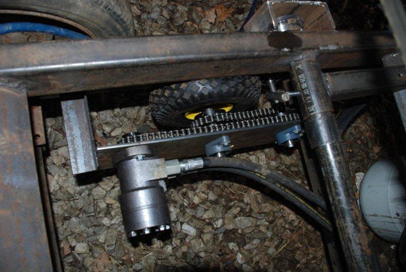

The carriage feed is run by a hydraulic motor which turns the little rubber tire shown in one of the pictures. This drives against the underside of the log carriage rail on one side. This system is working way better than I had hoped. The saw-head carriage up/down is by a hand crank on the top of the support post. A chain runs from one side to the other; these turn the acme rods on each side which haul the carriage up and down with a captured nut. I thought this would be easy; in truth, I am quite tired of cranking already. At 5 turns to the inch I am getting a workout. The advantage over a hydraulic motor (besides cost) is the consistency. 6 turns with the saw kerf gives me 1-1/16" lumber every time without scales. If I add a hydraulic motor, I'll add a scale as well.

After posting the above reply I then realized I was still on page one and there was 4 more pages going to a finished mill. Sorry that I jumped the gun. The only thing that I question is the pto shaft. If you cut a large log that shaft has to stretch to its limit, with an increase joint angle and large cuts. You might get some vibrations from that and it will be hard on the U joints. Just be sure that the pto shaft does not come apart. Nice work and have fun with it. Maybe you can use my ideal on the differential on your next project, like a slab trimmer.

I guess it is time to report back in about how things are running. With a stiffer gearbox mount I can saw fast enough to bog the tractor down without vibration. Someone suggested a need for two tractors....I have a log loading deck that will hold enough logs to saw all day. I just roll them onto the mill with a peavy since it is level to the carriage. It takes about 1 minute to back the tractor up, hook up the hydraulics and connect the PTO, so one tractor is plenty for my operation. So far I've sawn around 5,000 board feet of maple, ash and pine. I've also sawn flats on logs for a log cabin, as well as a number of rectangular timbers. Overall the performance has been good...
Here are two things that I plan to change. One will be the addition of a hydraulic motor to raise and lower the saw head. That crank really tires me out at the end of the day...especially when sawdust gets in the threads! I also plan to add some brushes to clean the threads as they turn and a shield to keep off some of the blown dust. I'll post pictures when that is done.
The second change will be to add some sprockets and use a chain to either end of the carriage running off the hydraulic motor to pull it back and forth. I have found the the tire drive slips too much for good control of the log. If the air pressure is too high it slightly raises the carriage when I get down to the last few boards affecting the cut parallelism; if the pressure is too low it begins to slip and I need to assist the carriage along with my foot. A more positive drive system would be desireable. Some day....it works for now!
