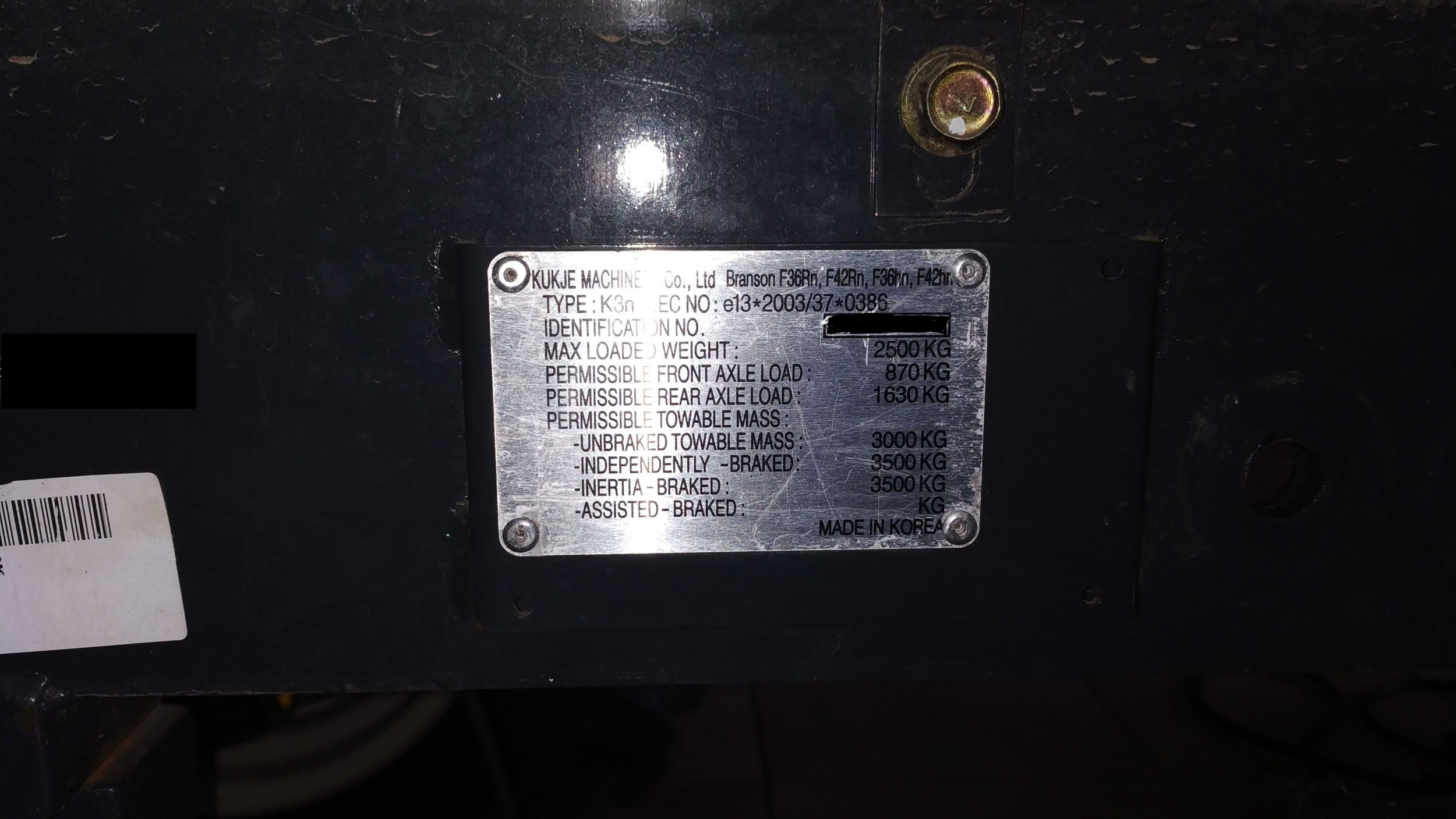

OP asks "Why manufacturers would...." because they can. Competent, prudent design and manufacture builds and rates an assembly for X pounds of load. That does not mean it fails/collapses when loaded at X+1 pounds. That means there is some undisclosed design margin - for safety/stupidity/litigation avoidance - you pick the reason.
So with the loader on, and the bucket loaded to rated capacity for the loader, and no ballast on the rear, the load on the front axle is beyond the engineer/designer intent, but still within what the static load of what axle will support without failing. Put some dynamics on that situation, such as turning, hitting a bump, stopping a quickly dropping load, etc and the failure of a spindle or kingpin is more likely.
When the failure happens, whose problem (responsibility to pay) it is becomes arguable, both at the dealership service/parts counter and further into the courts.
We like to think that purchasing a reputable brand would get a more robust design margin. The more robust design might be the utilization of drop-forged castings in the high stress points, and an extra eighth of an inch of high strength steel in the spindle or kingpin. As every brand has moved to "outsource" larger portions of a finished product to the low bidder, the concept of "quality" being built into a brand is long gone.
For us end-market customers, that means our multi-tens-of-thousands of dollar purchase is like stepping up to a craps-table and throwing the dice. Gone are the days of buying a product from a reputable brand and having a high level of assurance that it will last long enough to leave with the farm and continue to serve well for your grand children.
