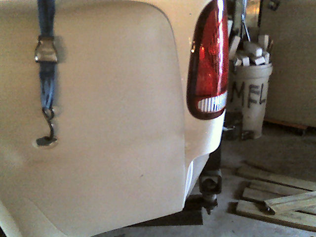

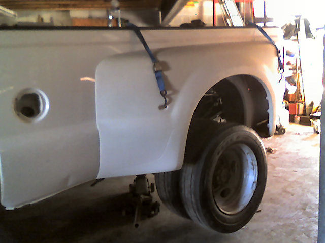

Thank you Robert, my wife had a week off and we just moved some stuff to the other place and I let her catch up on her soaps :D
I still have lots more to do and the center bed mount is giving me a hard time Grr I'll get it, we did get one of the fenders hung with a couple of straps to see how close it was to be
Did I mention that I am in no hurry
Jim
