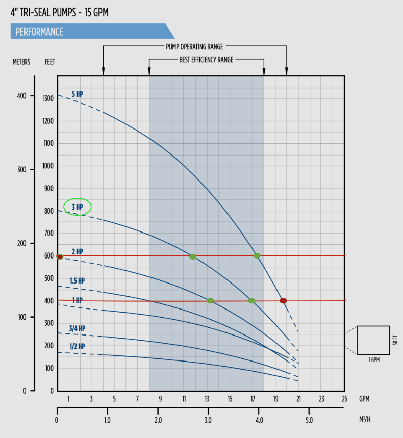

Nope. My well is even deeper, and I’m using a 3/4 hp pump.
Static level, and gpm desired are big factors
/ Question for electricians #82
Interesting. I see lots of charts like this, courtesy of Google:
It seems to show the 3/4 hp pump petering out around 260 ft depth, and only delivering 5 gpm at 240 ft.

True. But given the size of today's homes, I think that's a pretty standard size to specify.
Maybe for people who like run lawn sprinklers everywhere.
7 gpm is more than enough for my house. Even if I somehow exceeded 7 gpm momentarily, which won’t happen, my pressure tank, that everyone has, would handle the brief excess demand .
Here’s a 5 gpm 4” pump chart:
3/4 hp circled

That makes sense. I assume the big difference between nameplate pump capacities is the size and pitch of the impeller, effectively changing the mechanical advantage?
/ Question for electricians #88
The interesting counterintuitive part, is that for a given hp, a lower gpm pump actually requires more stages and weight and size, than a higher gpm pump of the same series , using the same motor
/ Question for electricians #89
Yeah, counterintuitive at first glance. But I guess it makes sense when you stop to think about the fact that the lower GPM trade-off is greater lift. You can achieve greater velocity with changing impeller size and pitch, but the greater lift pressure at a given input HP may require more stages to reduce blow-by at a given RPM.
