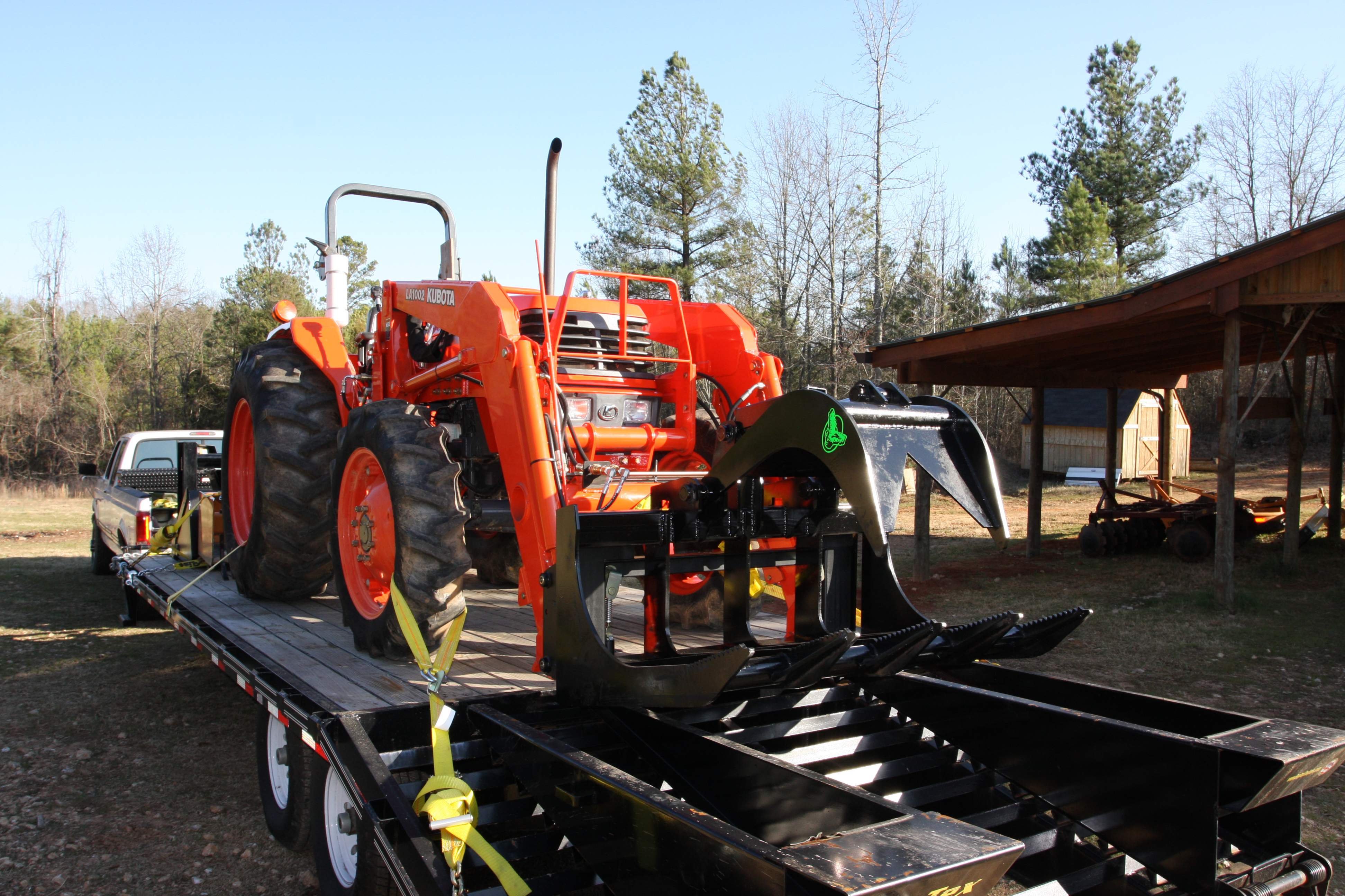

On root rake grapples where you are clearing brush my opinion is that you need the grapple at least as wide as the tractor tires. My 72" root rake grapple is mainly on a 72" wide machine and I could do at times with a 84". Again, this is for brush. If you are using a grapple with the large lower teeth, I would guess much more narrow.
I disagree. I have a 48" Markham on a 70 horse Kubota and it is a beast. Wider may be ok for simply scooping up loose debris, but for uprooting/digging and collecting debris, the narrower ones shine. I use mine a tremendous amount, and a wider one would not allow the focused pressure needed for uprooting, and it's plenty wide for collecting debris. And two "claws" is overkill. One is plenty. I never have a problem holding what I grab. One thumb works just fine. It's my most used implement.

Like anything else I guess, it depends what you use it for. The brush I have has soft small roots, but 10' of top growth.

HCJ I agree, in fact you was partly responsible for me getting the 48"..
Two pics, first I uprooted this tree with the grapple, heading for burn pile. Second, the last of a big tree, also headed for the burn pile....it has the front tires half flat.

That's true. I can see how a wider one would have advantages for "raking" so the main purpose surely would dictate which is better. Regardless, any grapple is better than no grapple! I was speaking on how I use mine, which is primarily for cleaning up chain saw debris when I trim roads and trails, and for clearing land of small trees and saplings by uprooting them. I attack some trees that are pretty big.
One caution is that grapple work does take it's toll on a tractor. I think it really wears the clutch if you are doing lots of pushing and the debris can find pathways to damage your front end and undercarriage. When you have a grapple, you can easily get into a bulldozer mentality, and damage can occur quickly. Done that too many times!!! So protect your front by making a solid inpenetrable grill guard before you use it.
