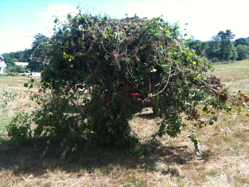

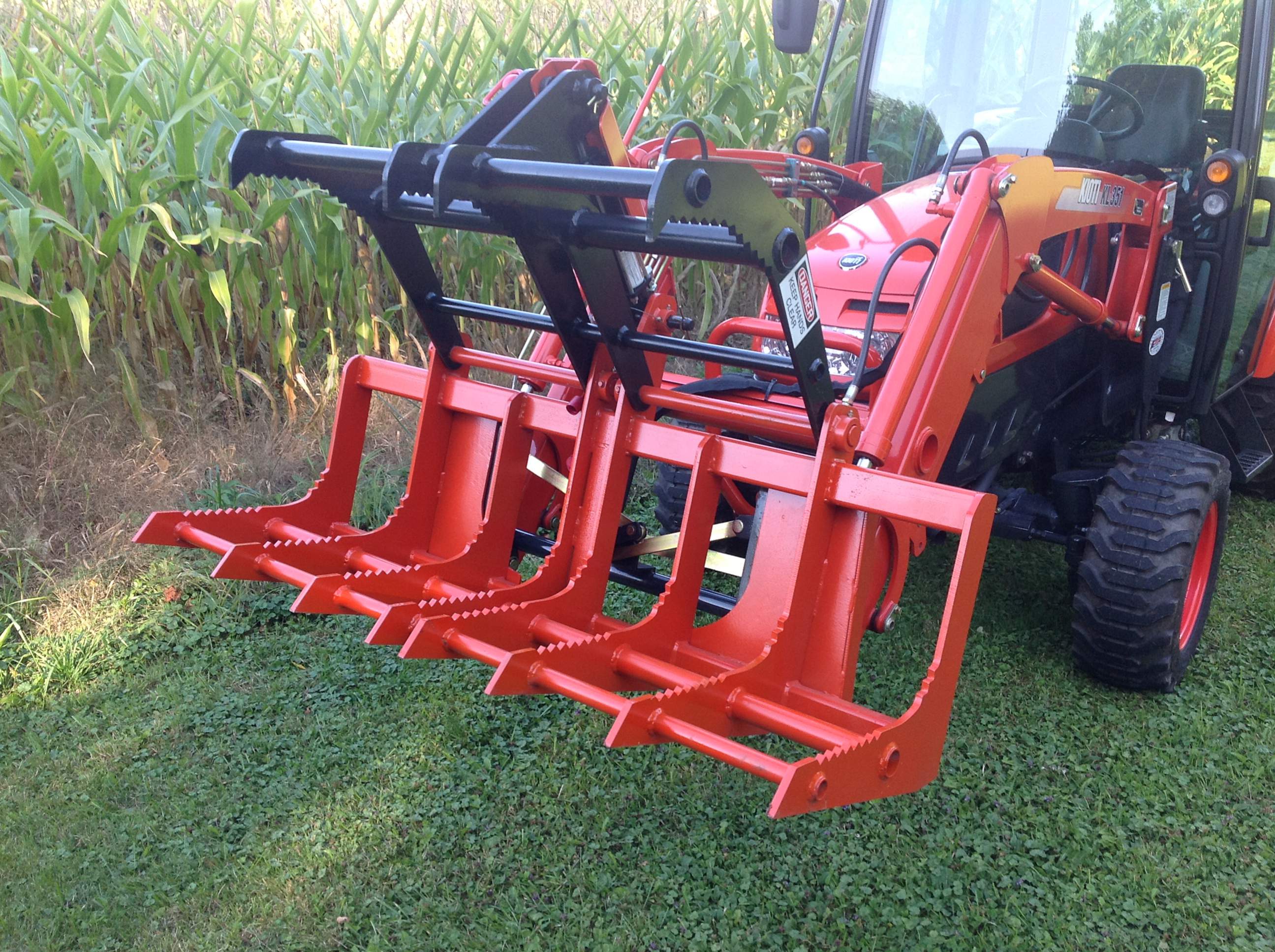

I'd recommend you call them back and cancel. $1775 is very expensive, you really don't have more than a modestly sized loader so you need minimum grapple weight, and, what most everyone has told you about a 48" grapple is correct. You will lift less with the 56" due to weight, you'll root rake and dig less efficiently because the larger grapple will distribute rather than concentrate force, and a 48" can pick up just as much brush.
Although it is easy to understand why people focus on standard bucket size, it really is an error. Excavators could easily handle ten foot grapples but rarely mount more than 36"-48" because that is the most effective size. Skidsteers usually mount wider grapples but they are construction tools and pick up a lot of scrap rather than brush or roots typically. Have you heard even one comment from an owner of a 48" grapple who wished he'd bought bigger or heavier duty?
I've had my 48" Millonzi for about seven years and routinely beat the crap out of it digging brush and knocking down trees. It has battle scars but works fine for every task I've done. It weighs about 300lbs and cost $500. It is matched well with my DK40se which has a considerably heavier tractor with a stronger loader.
Why get bigger?
