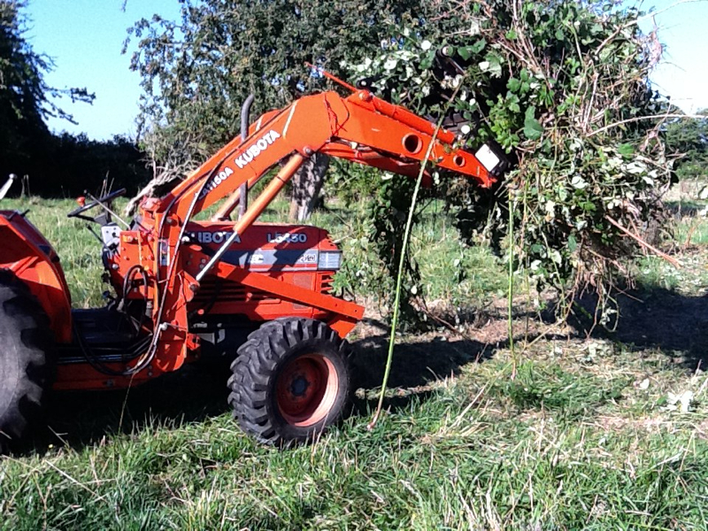

I don't find the "flats" on the end of the tines to be an issue- I guess from a strength viewpoint, I wouldrather have those "flats" as they are in essence strengthening the tines. And Ihave not had any issue grabbing roots. as for Joe's comments on the advantages of a rake as wide as your wheel footprint I'm sure that has its advantages. You only have so much HP and I think the narrower rake makes for more efficient removal as you are concentrating your power over less width-stands to reason-wider the rake, more power you need.:)

So everyone is clear RAKE Root Grapples are completely different from BUCKET Root Grapples. I could not pick up a stump like in the right side picture above with my RAKE style, no way. At the same time, my brush and vines would go right through A BUCKET style top clamp. It would not grip enough to pull the roots out like I do (pull from the top growth like pulling 10' weeds)
RAKE STYLE
http://www.skidsteerexpress.com/cgi-bin/shopper.cgi?preadd=action&key=ROOT3RG-R72
BUCKET STYLE
http://www.skidsteerexpress.com/cgi-bin/shopper.cgi?preadd=action&key=ROOT1RG-B72
Wider is better for me on the rake, but I believe narrow is better on the bucket style, but it all depends on your use. Now I just have to find a way to buy a bucket style. LOL

A 48" is plenty. In fact, in most situations it has clear advantages.

Why do you guys say a 48" grapple is all you need?
   / questions about choice of root grapple #25
Simple. A 48" will pick up a mass of debris the size of house! Seriously, my 48" will grab so much that i can not see around it. I have never wished for a wider bite, but often use the corner tines in an attemt to narrow the focus when trying to uproot tree roots. You can't pick up more with a 72 than i can with a 48, but my 48 will out dig your 72 hands down. If uproot trees and clearing land is a common use, go 48". If all you want is a rake on your FEL, then go wider.
And the bucket style is the way to go on a tractor. A skid steer may do ok with the other, but a tractor does not enough pushing power in my opinion to utilize that style.

I think I understand. If I had a 48" grapple and picked up brush and had 1' overhang I would be 72." I am thinking about making a bucket style.

After all of the input on this thread, I will get the bucket-style (open bottom) grapple, either a 48 or a 54 (or 56, if I buy the W. L. Long version). I do think that the 48 will pick up anything I need to pick up, and would be better at grubbing out trees, stumps and such. My application includes a good bit of raking loose debris--probably a little more raking than rubbing. Hence my inclination toward a little wider grapple. But I do get it about the utility of the 48, especially for a smaller tractor.

^ I completely agree with THIS assessment of grapple size / style. The width /size of a grapple is one area where more is NOT better. Oftentimes you need to focus your "grubbing" efforts when using a grapple...and a 48" works better in this area. I've never wished for a larger size grapple or for double clamps on the top.
Getting a volume of brush and debris into a 48" grapple is not a problem. I seldom use my dirt bucket anymore.....the grapple does so many chores better.
